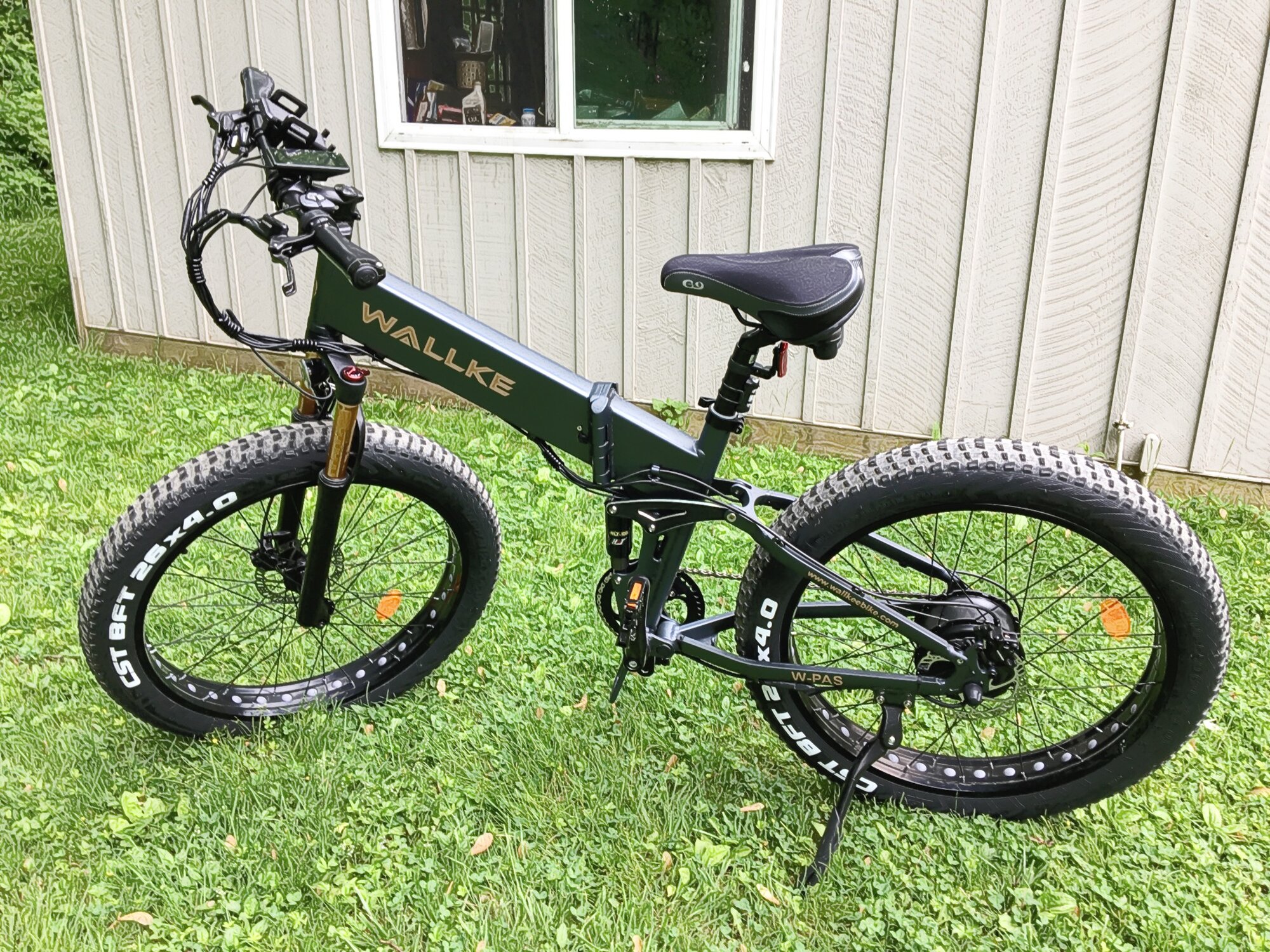

I have a rack on my (2) two Wallke X3-Pro’s that can be purchased on Amazon for approximately the mid $30.00 dollar range. One of my X3-Pros is shown on the Wallke web site ( www.Wallkeebike.com ) with a rack top bag.
Although my rack is mounted to the swing-arm frame and seat post, I have not seen any adverse affects towards the ride motion of the shock assisted swing-arm.
Overall I am extremely satisfied with the X3-Pro after +600 miles of riding.
I recently changed the original handlebar stem, to a Sunlite 0-60 degree Adjustable Universal Mountain Bike Stem that I purchased on Amazon. This raised the handlebars for a more comfortable riding position.
NOTE : This was a 15 minute change out and there was sufficient slack in the Wallke wire and brake system to facilitate the installation of the taller stem.

I just ordered another Adjustable Bike Stem from Wake Bike Stem. It smelled for $19.99 and this is for my second Wallke X3-Pro
The change out is about 15 minutes.
I am 6’2” and enjoy the handlebar placement with the new Adjustable Bike Stem.
