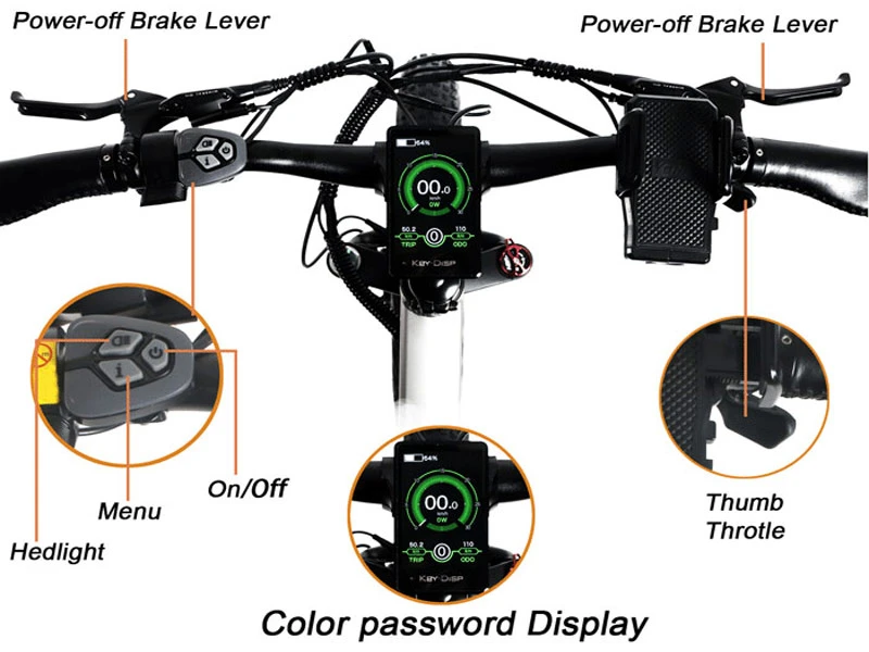

That's not the throttle, that's the gear selector.
yeah i was wondering the same ! i think the throttle is on the left , id prefer it on the right ,is it easy to change ?
Usually if a bike has gear selector on the right, the throttle will be on left. At least that's what I've seen in a few bikes.
You are correct that it is not regulated. The throttle is ready to go at the maximum speed right out of the box.
Actually after receiving the bike I’ve gotten used to the throttle being on the left and back breaks being placed left side too ,
On my Sondors Fold X, it has both the throttle and gear selector on the right.
On my Totem CS-260, it has the gear selector on the right and the throttle on the left.
As odd as it may seem, I actually prefer having the thumb throttle on the left as my right hand is dominant and usually has a death grip on the handle that's too tight to move my thumb 🤪
