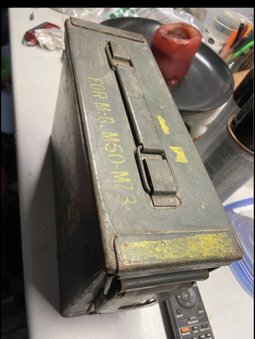

Wanting to debadge my whole bike.
I’m going with a military theme with the beige bike.
Bought this ammo box to mount on the rack along with decals and other things to put on the bike. Scared to use any chemicals, may try a heat gun. Hard to feel the edge of the decal, it sure if they are cleared over or not.

BTW: the metal ammo cans are certainly a more authentic look, but I think any of these x3s would look plenty sharp with a pair of large OD plastic ammo cases hanging off that beefy rear rack. It would be a lot lighter.
No luck with the heat gun, or goo be gone.
I didn’t get the ammo cans mounted. All three together only weigh 8 pounds.

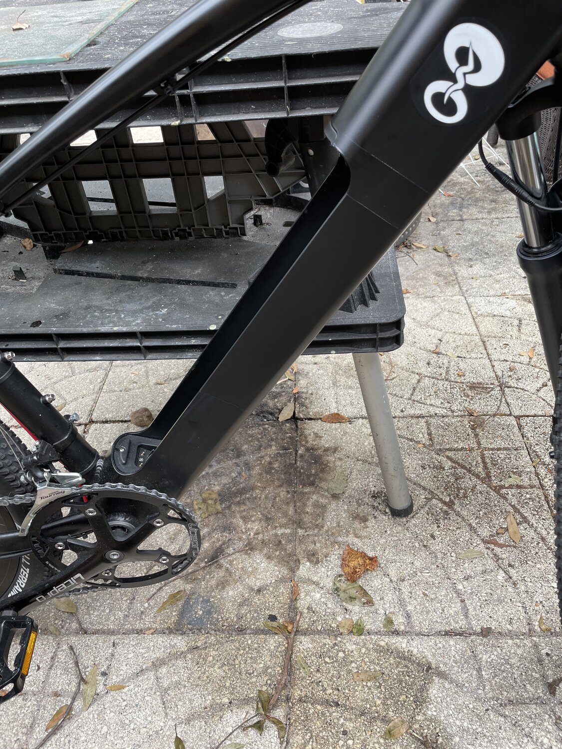

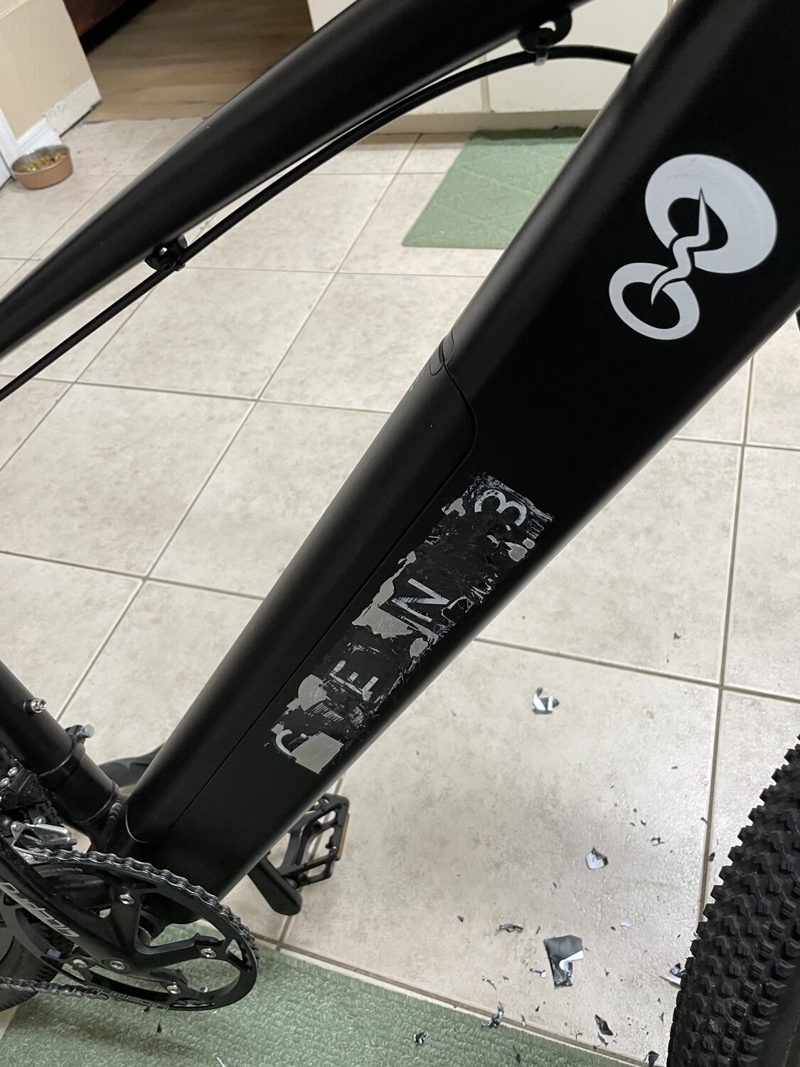

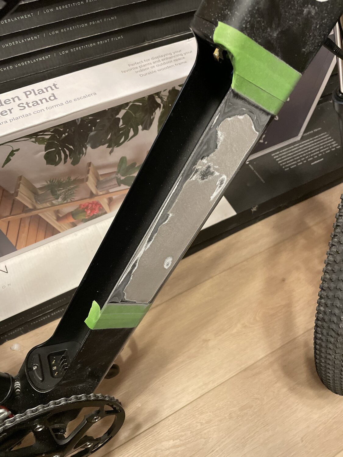

Don’t try removing the large frame decal on the down tube. Heatgun didn’t work. I ended up pretty much destroying the factory paint with razor scraper trying to get the decal to release. The ones on the fork were no problem with the heatgun. This is on a Wallke F1 but they’re probably the same on all their bikes. Someone mentioned denatured alcohol. I have my doubts but I’ll try that tomorrow. Rust oleum Flat Black enamel spray paint was close enough to make the repair. See pics. Interesting what was underneath the decal. I already had thoughts they were the same bikes since my wife has a Gen3 Stride and they were sold out of their Flex and later I found the F1 which looked identical. Only difference is Wallke has Zoom printed on their brakes.

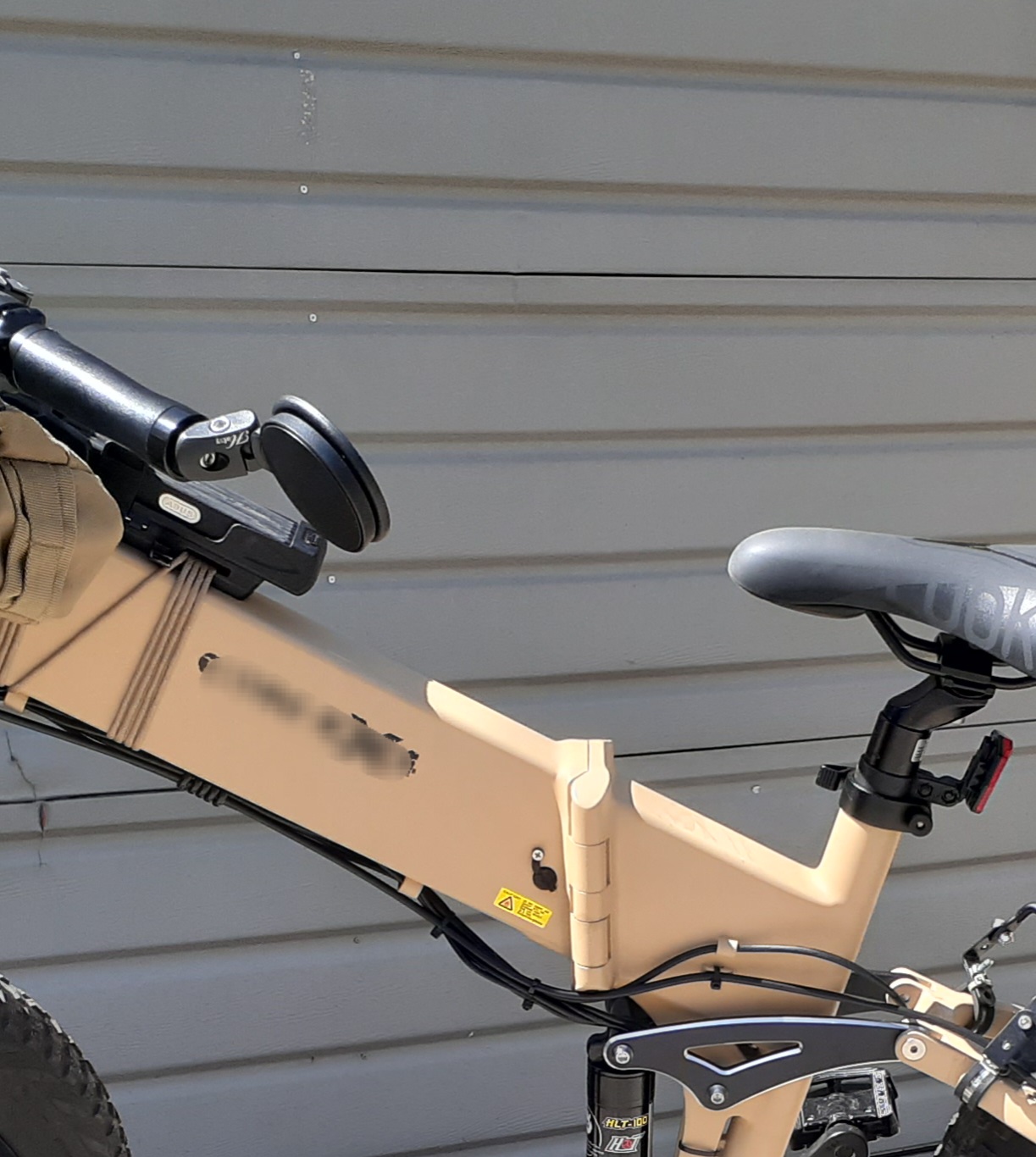

My old wallke x3. Decals removed. And if you feel like you need to scrape, try using plastic razors.
Have patience. Dab the rag, hold it in place without rubbing it. The alcohol will evaporate. So it does not stay wet long. When the decals start to melt, then start to rub gently with some more alcohol. One letter at a time was what I was able to do.
