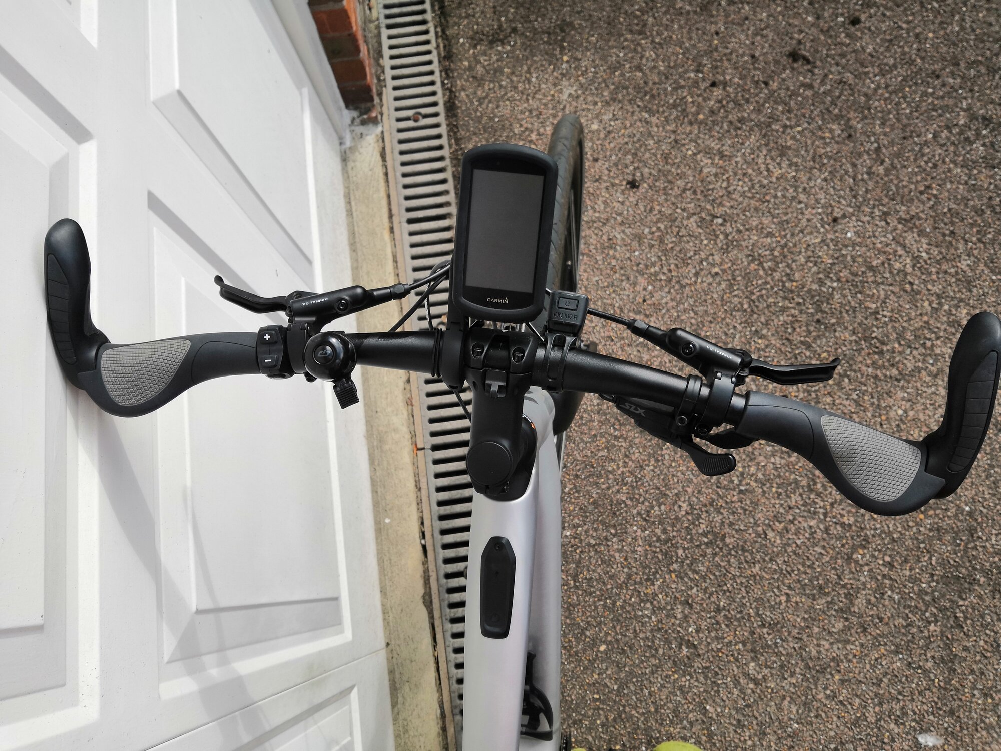

GP4 for me on my TV SL5. My riding style is not very sedentary, I tend to stand on the pedals (clipped in) when climbing or needing a burst of speed - so something big enough to get a firm grip on is important.
Combination of FutureShock and the Ergon's also means no more numbness in my hands compared to my old (analog) bike. For the super observant, you will see I have also shortened the bars.
