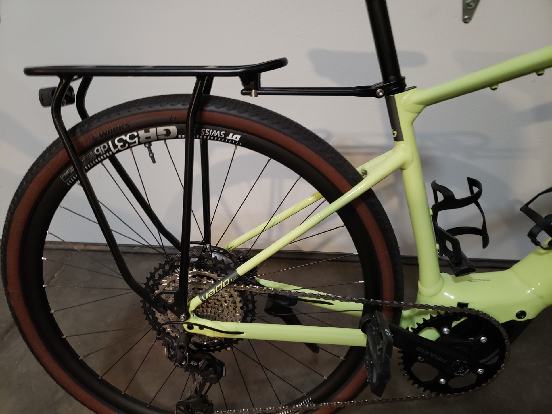

You can still use a seat post clamp with the extra threads. Just mount it above the proprietary Specs clamp but you might have to shim it with a thin strip of rubber.

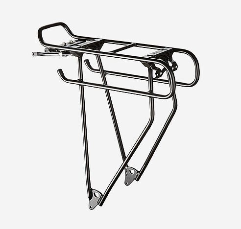

Would this rack work?:
Jodi, first of all the stock Racktime rear rack of Vado SL hates to be overloaded, and it bends easily when overloaded. I am interested in a sturdier rack myself.

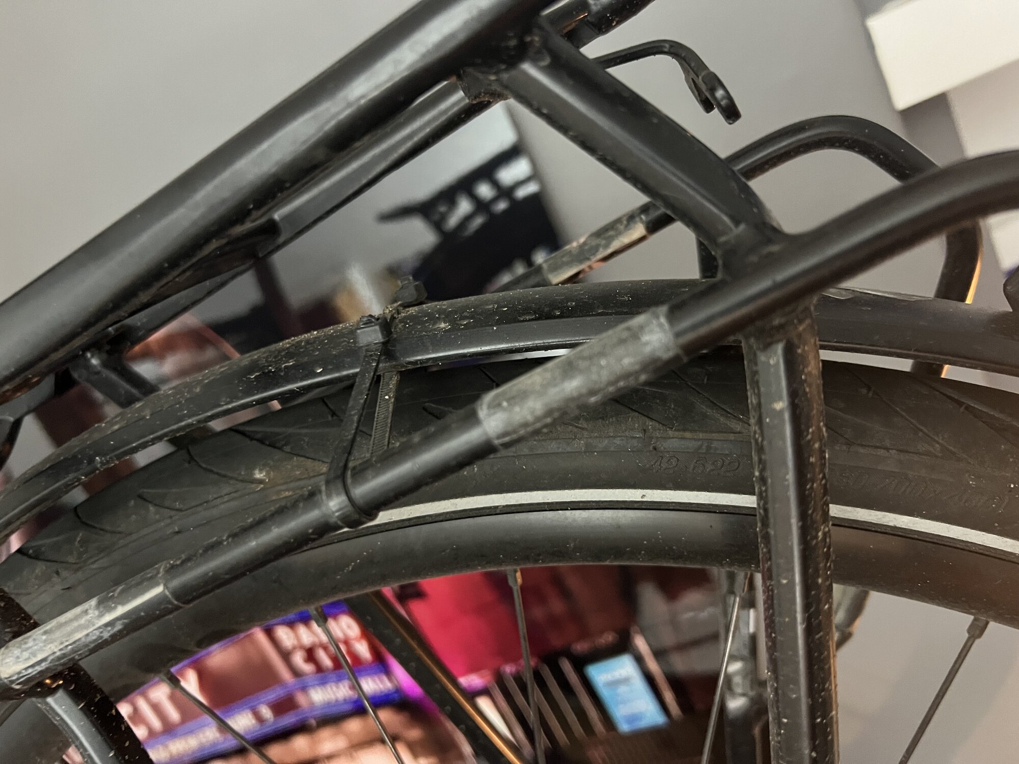

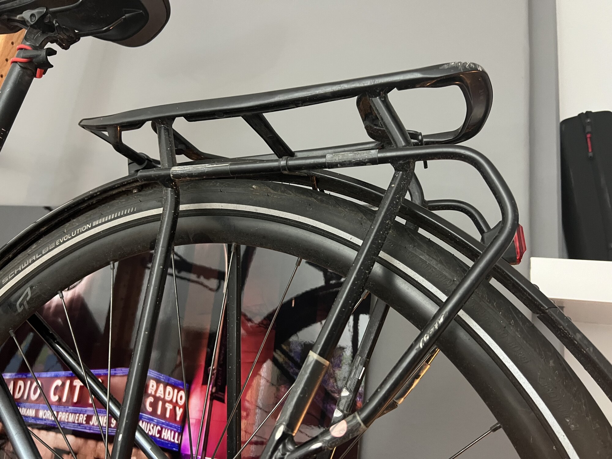

Hi, I had similar requirements so purchased the Racktime Standit 2.0 Tour along with the IMM kit, which allows the ability to retain the clean look of the mudguard mount. I have used it on several multi day tours with Ortlieb panniers and Talis 2.0 rack bag. There is a bit of wear on the vertical bars from where the pannier lower clip meets the rack, but as this has been my daily commuter for the last couple of years, I am not overly concerned.
There was a bit of minor fettling involved when fitting, as the IMM support bar was a little shorter than original resulting in a redundant hole in the mudguard which I used to steady the unsupported mudguard section with 2 tywraps.
