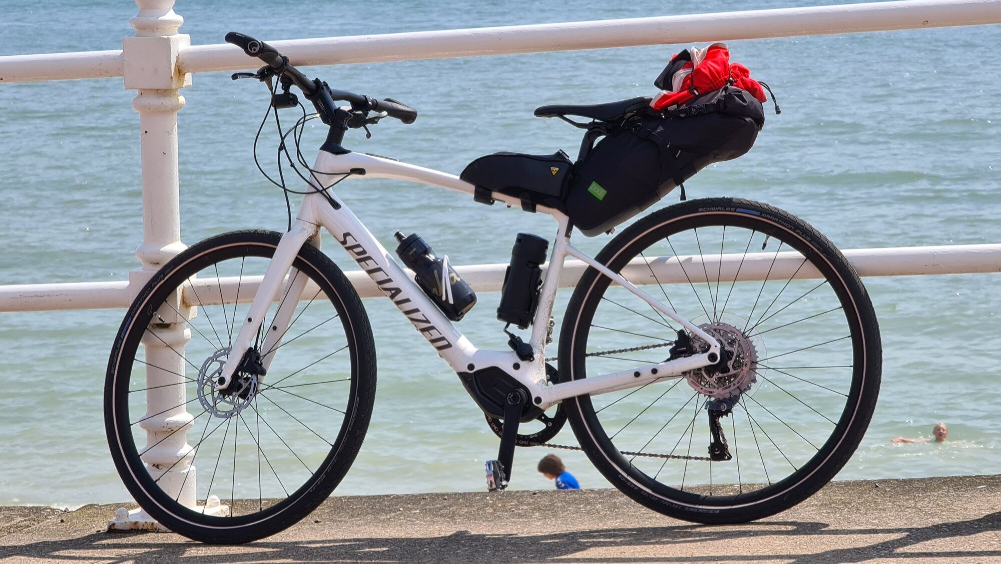

Hi Stephan,
Basically flipped the headlight and attached it to a go-pro mount under a garmin mount. Hopefully picture makes sense!

Mike, please tell me:
  • You installed the RedShift ShockStop
  • You installed a Go-Pro mount and attached the Lezyne below it. Could you tell me what exactly Go-Pro mount?
  • No issues with cable slack? What size is your Vado SL?

I'm going for RedShift ShockStop 6 deg x 100 mm. My brother has a spare Go-Pro Mount. A no-brainer. Thank you @RyedaleMike and @Allan47.7339 for your good advice!
Hi Stephan
Medium size bike and no issues with cables. There are loads of mounts - I got mine off Amazon, screen shot attached!
