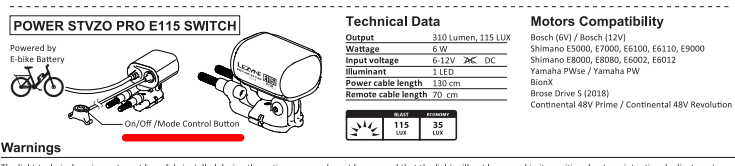

Let us do some calculation. The Lezyne Ebike Power STVZO E115 headlight draws 6 W from the battery. So it draws 6 Wh an hour. Let us assume the tail light draws 1 W, so it is 7 Wh an hour altogether. The main SL battery Gen 1 is 320 Wh. Vado SL 5.0 lighting draws then 100 * 7 / 320 = 2.2% of the battery an hour. Meaning, riding a Metric Century for 10 hours (which is realistic) will use 22% power from the battery. It is not that much as for a 10 hour ride! Necessary to mention the weaker headlight of Vado SL 4.0 draws only 4 W of power.
@MartsEbike: If you are really miserable with the headlight, I think I have found something for you :)
Lezyne E-BIKE POWER STVZO PRO E115 SWITCH
This headlight is compatible with our e-bikes. It switches the light from daylight to the night mode automatically to save the e-bike battery :)
Thanks Stefan! I hadn't looked into this too deeply if I'm honest, as I expected the ride to take place next year, possibly in the summer.
The Switch version could be a good improvement. I'd expect in daytime mode it only uses 1-1.5w rather than 6w, which for me is quite a saving! (Edit!!! Just noticed the Switch, can be turned on / off and auto mode! so even better!)
As you say in normal circumstances it's not a huge saving, but on my 10-hour 72-mile ride, it would have made a big difference. I returned with just 7% to spare... Mind, I was caught out with little energy to spare and long hills to navigate. A 100-mile round trip to Oxford is mostly across much flatter ground and wouldn't be so arduous, on me or the bike!
In any case, I'd like to reduce the power draw as much as possible so I'll keep this in mind, it will probably be a future upgrade! :)

I checked this today on my bike, and it doesn't look like it is possible to turn the lights off. They're permanently on.
I'll probably opt for the Lenzye Power StVZO Pro E115 Switch headlight @Stefan Mikes suggested above. Reading the manual it appears to have the ability to turn it off. I'll have to double-check that by reading a few reviews. Mind you the "daytime" mode will still be helpful. The only issue is stock in the UK is difficult to find. I found a German bike store with stock but annoyingly they have minimal spend for delivery to the UK - and it means spending twice as much. :(

Funnily enough, Lezyne doesn't mention Specialized SL/Mahle motors but we all know these lights are compatible... :)
P.S. I think the daylight running light would be useful (think of all the English hedges!)
