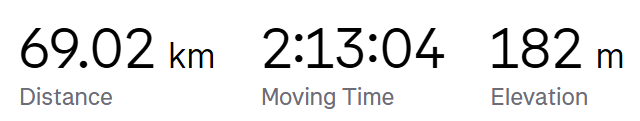

My fastest ride ever. A "full power" Vado (non SL) and a workout with road cyclists. It was a loop so the wind and elevation could be cancelled. Our average speed was 19.3 mph, and the maximum speed of 31.7 mph was only achieved on the descent.
I burned two big batteries for that ride :)
