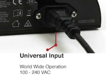

The Grin cycle Satiator (model CG306-4808, specified for 24-48V only) needs AC input 100 -240V but doesn't work on 12V input as requested.
And there is no Satiator model for the complete range 12V -60V.

Satiator 4808:
Thread title:
Vado SL 12v car charger​
You’re right it’s 12-63v. Use custom profiles!
Basic Range Parameters: 4808
Full Volts 12-63V Bulk Amps 0.2-8.0A*
Q Can this charge a 12v auto battery? Lowest output voltage is 24v but I'm not an expert.
A by Grin Technologies Ltd.:
Yes it can be set to charge a 12V automotive battery too, although the charger electronics are not as efficient since the power circuitry was optimized for a higher voltage output range. We do produce a separate 12-24V 15 amp Satiator that is optimized for lower voltage packs and a higher charge current, but it won't work on 36V or 48V batteries like this model.
So I stick to what I've written in #22: there is no Satiator model for the complete range 12V -60V. Yes, you could use it for 12V, but it's not build for 12V.
But you're still missing my main point: the Satiator doesn't work on 12V input which is what the OP was asking for.

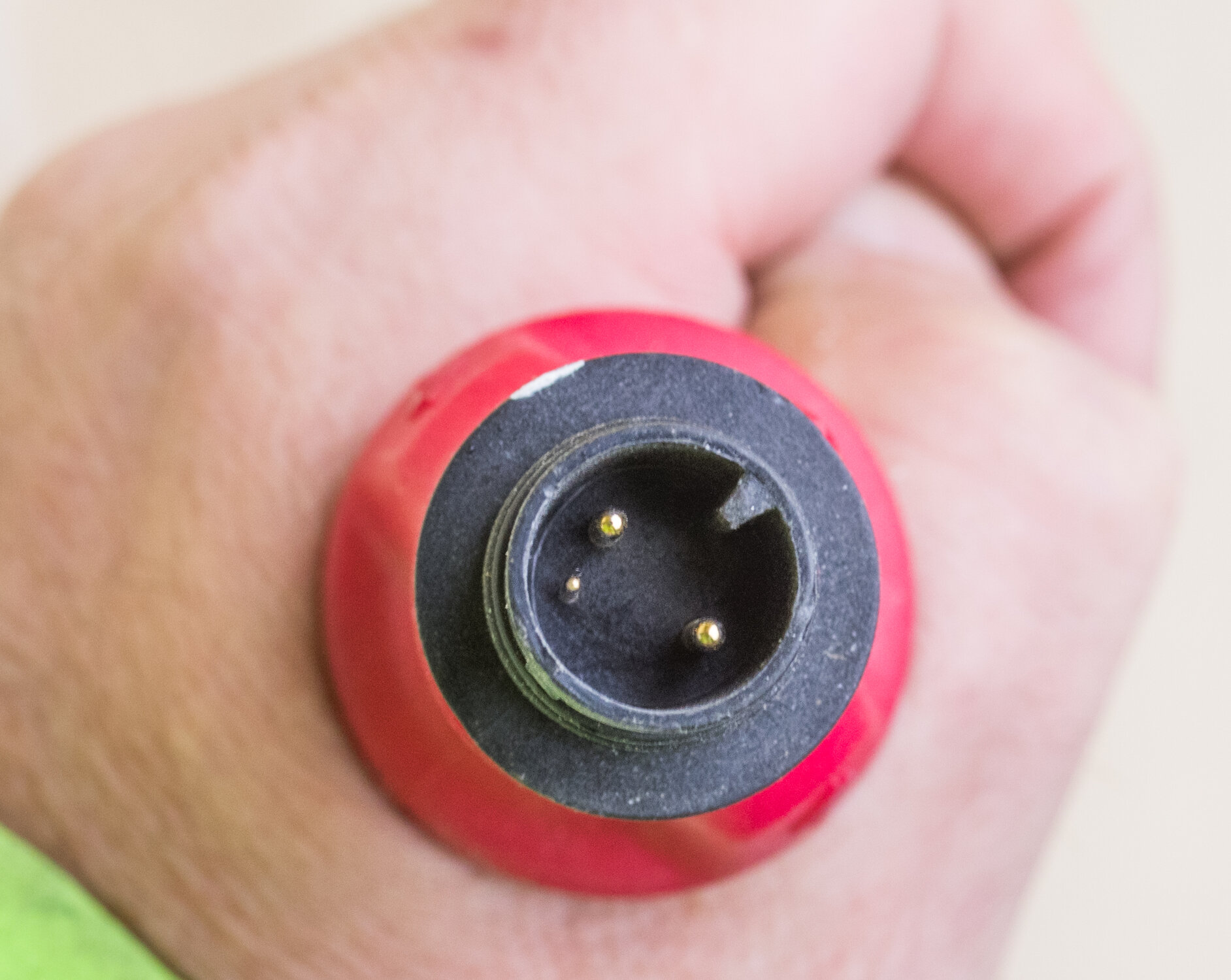

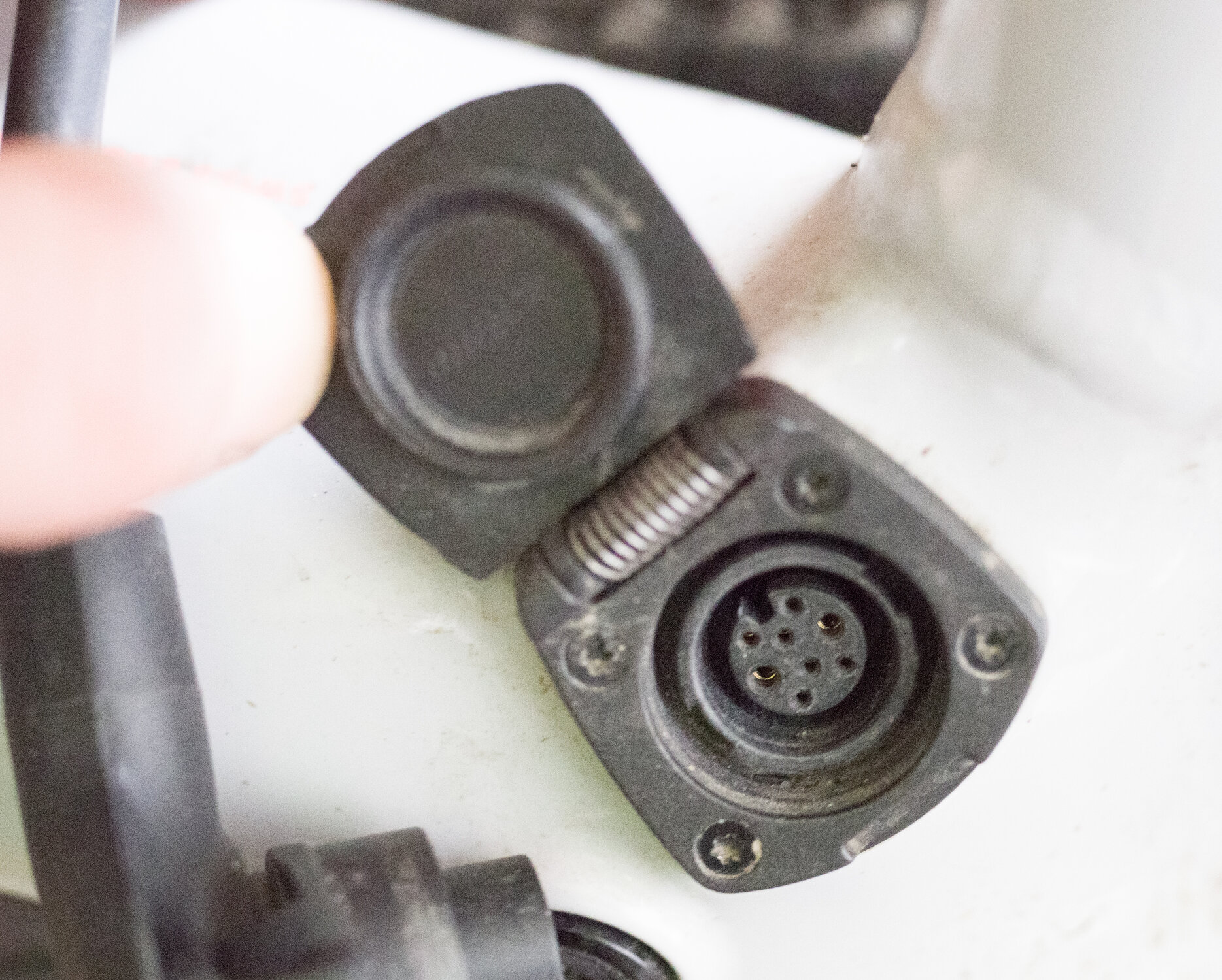

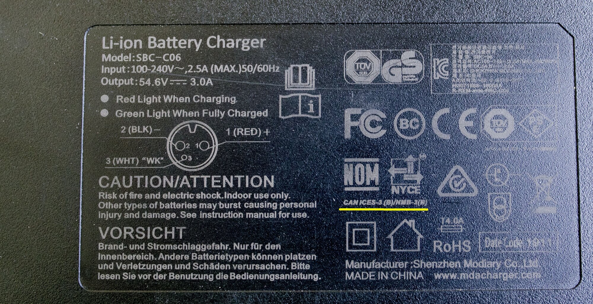

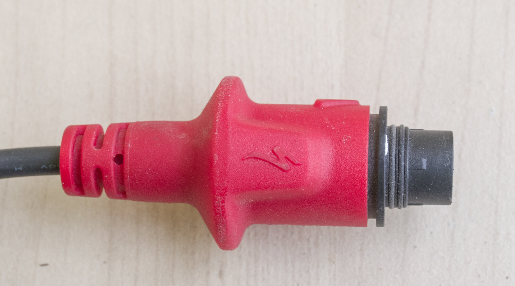

@TS25: These pictures might be interesting to you.
The charger plug looks simple while the charging SL socket is quite sophisticated. It is because you can connect the Range Extender battery to that socket, and the RE pins are organized differently.
There's also some specialty when you are charging the main and RE batteries in parallel. SL Y-cable is used. The inlet of the Y-cable is just connected to the regular SBC-C06 charger output plug. Then, you connect one of the plugs of the Y-cable to the main charging socket, and another plug to the input socket of the RE. The system will only start charging when both plugs are connected properly. Finally, the charging current is reduced the way the 160 W Range Extender gets the full charge over 3 hours 20 minutes, and the same time is necessary for the main battery to charge from 5 to 100%. The intention is not to pass too high charging current through the Range Extender.
If only main battery is connected by the simple plug, the charging of the main 320 Wh battery takes 2 h 35 minutes. If you only connect the Range Extender, the full charge takes 3 h 20 minutes.
Hope that helps!
