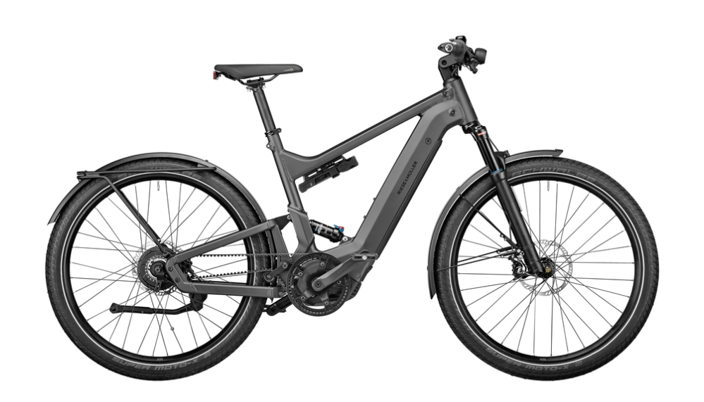

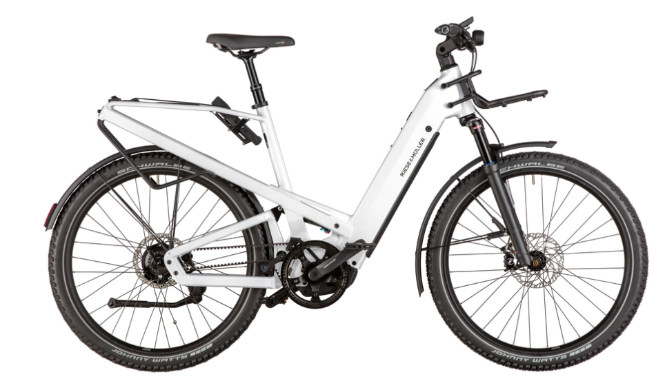

I share your pain :) With rare exceptions, I do all my grocery shopping using e-bikes. As I have found the Vado SL rear rack a little bit delicate, I now ride shopping on my Vado 6.0, which has a far sturdier rack. On one of my recent rides, I did an unusual manoeuvre: I jumped off the bike path curb onto the road. The shock to the rear rack was as strong as an Ortlieb pannier detached itself and banged onto the road. Oh, then I had to wash the pannier as the jar of pickles shattered inside! :D Now, I avoid doing funny actions when returning from my grocery shopping!
Also kinda curious if some R&M-eqse rear pannier rack could be installed in a Tero to enhance the storage space.
Just to make it clear: It is not the R&M rear rack that is a suspension one, no. It is the special e-bike design that makes the rack suspended.
It is the Homage (not Delite) that has its rack suspended.
The Delite rack is not suspended.
Confused the models. I rode a Trance E+. The one with the suspended rack is the Stormguard E+
The Delite Mountain doesn't have a suspended rack (and an optional pannier rack fender, but many of the Delite models do.
All correct. Either Stormguard E+ or full suspension R&M e-bikes with "standard rack" have special bosses on the frames to install the dedicated suspended racks. I do not think that's doable for the Tero X.
Stormguard
Delite
I also wonder what is the rated load for these racks. (These do not look like as ones to be able to carry more than a trunk bag). Note R&M offers a unsuspended "pannier rack" as an alternative, which indicates the "standard carrier" is not an option to carry heavy panniers.
@sammcneill, @Muso: You are R&M e-bike riders, aren't you? Could you shed some light on how the R&M suspended carrier is installed and what are the rated load limits?
