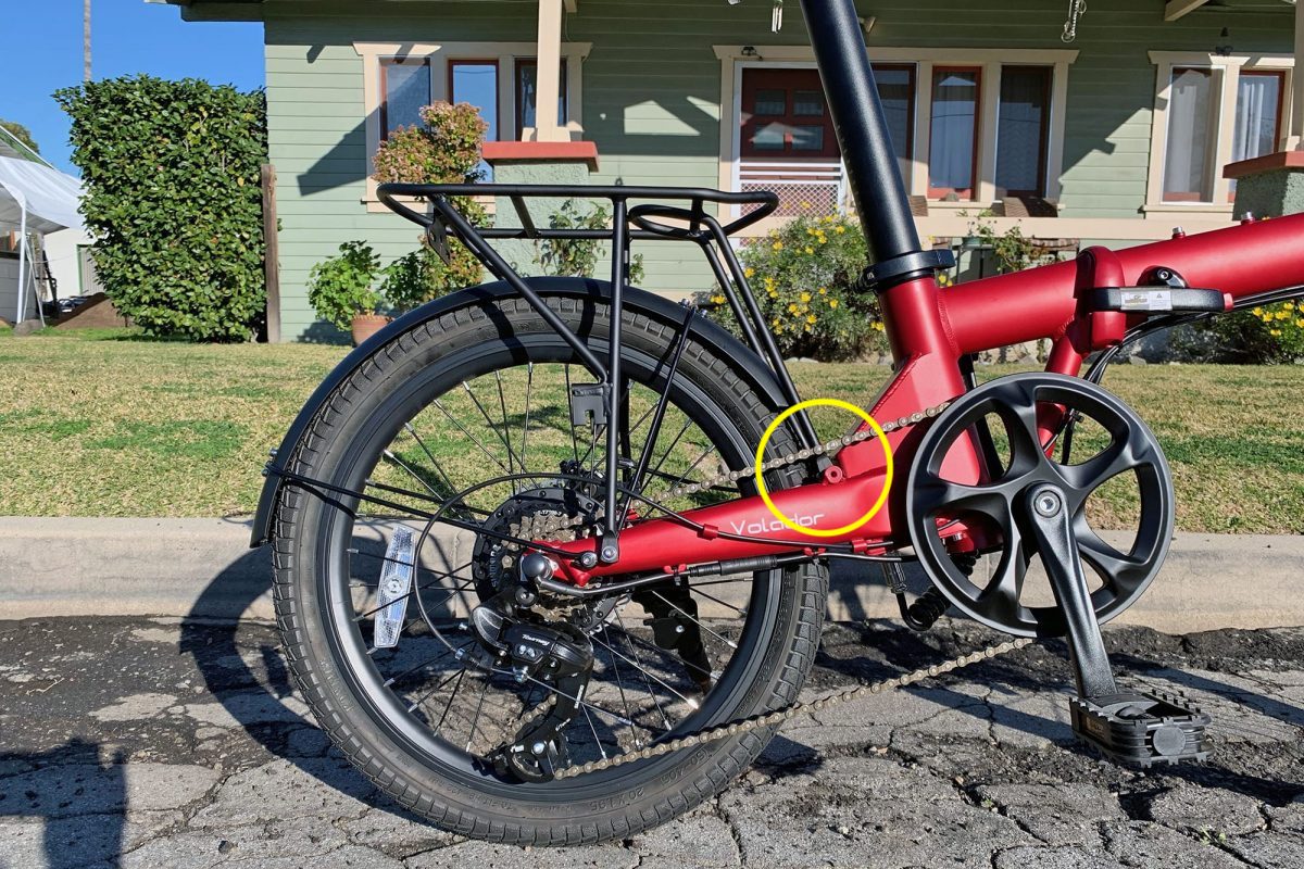

Another question I would like to ask is: I'm having trouble installing the rear rack on the Volador. The angle of the screw is very awkward so I cannot screw it in. I tried to use Allen ranch with longer/shorter arms but still can't get it done. Can anyone who successfully install the rack give me some tips or suggestions?

On the first attempt, work slowly, leave the rack out of the equation, and just attach and detach the allen bolts on their own to get it all worked-in. There may be some paint in the bolt holes/threads initially, and be a bit stiff. There are two chainstay holes. The upper one is for the rack attachment, the lower for the rear fender.
Next, incorporate rack, very loosely thread the bolts with your fingers and tighten with key tool only once all four are properly seated with the rack. I start with top frame bolts to keep alignment, and then work down to the chainstay spots that will take the load. Don't cross threads. If there's resistance, stop, reverse, try again. The bike is prob on kickstand, so take that into account when eye-balling the angle of insertion on the allen bolts. Tightening I start at the bottom and finish at the upper frame points - you will note there is some sliding room flexibility on the rack attachment at that point to make final adjustments.

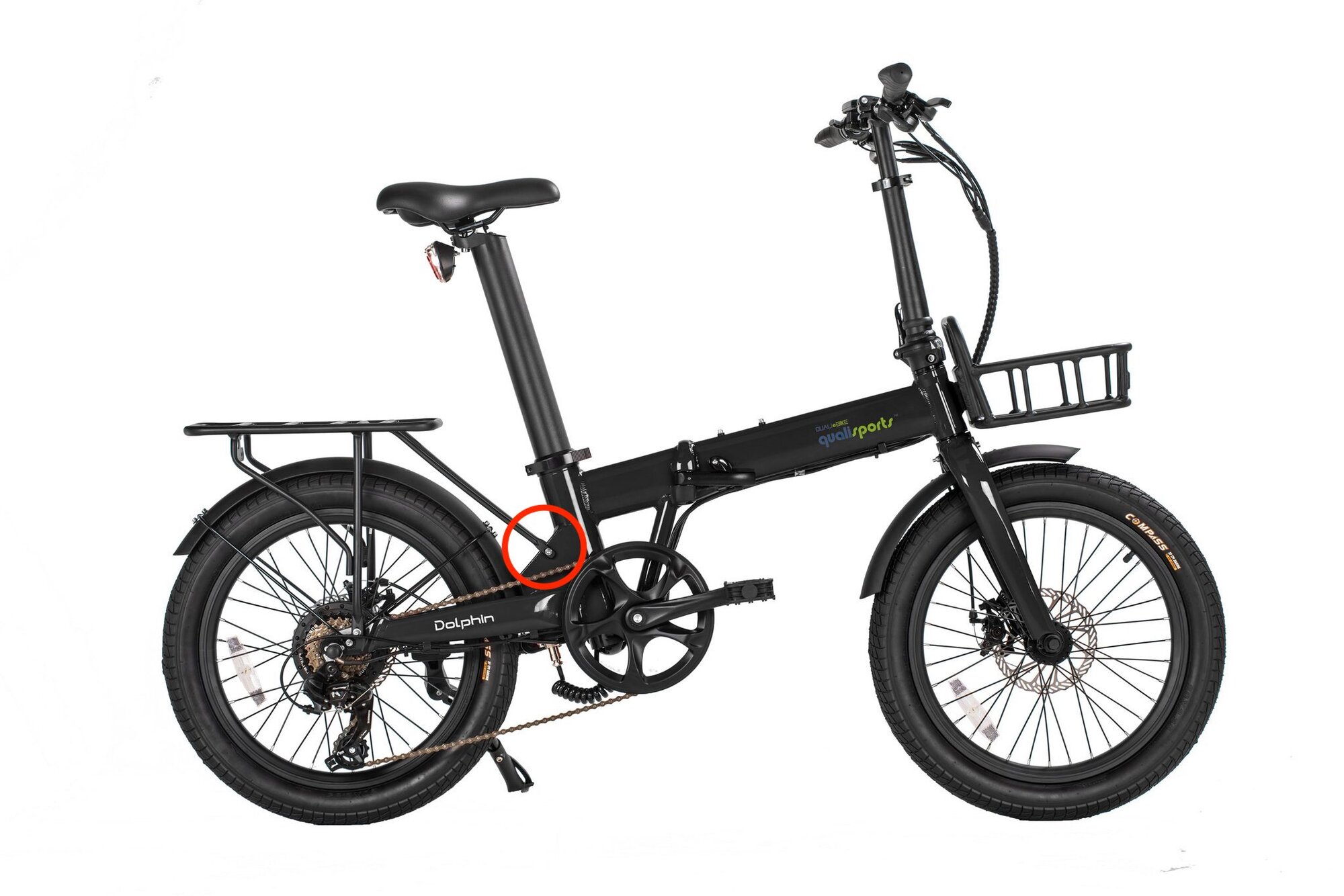

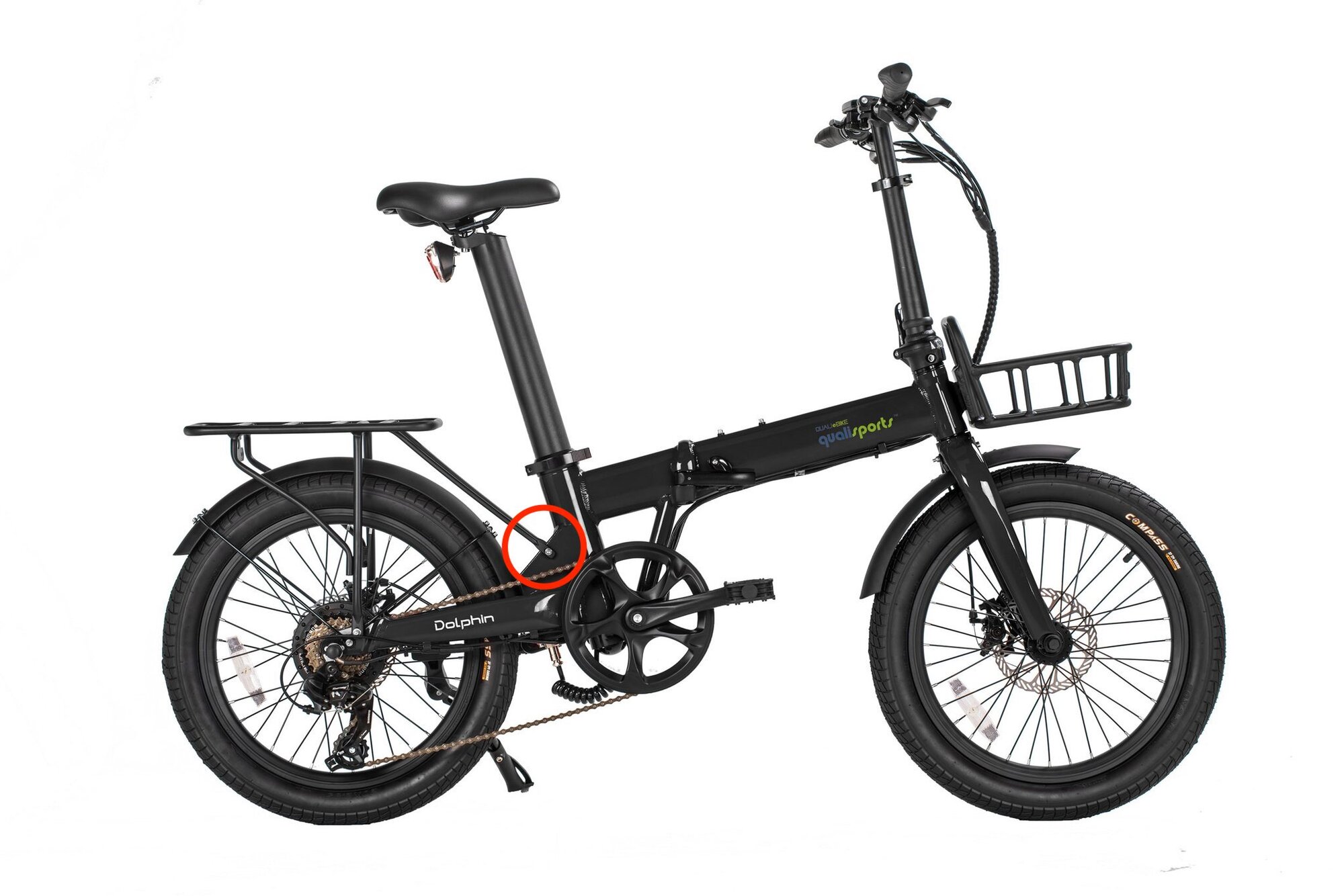

So it seems that Qualisports improves their rack design when they release the Dolphin model. Here I include pictures to compare:
qualisports_USA_folding_electric_bike_eletric_bicycle_Dolphin_mini_ebike_light_weight_bike_5_2...jpg
The circled area is the place that I'm having trouble with. The space between the tire and the computer box is too narrow, so I can't get my Allen wrench straight to screw the bolt. And based on the picture, the bolt is coming inside out, which makes it even harder to handle. I can't even put a bolt without the rack into the frame at that position. I'm wondering maybe I should use a different tool to do this job? Or I should deflate my tire to give me more space to handle this job?
So it seems that Qualisports improves their rack design when they release the Dolphin model. Here I include pictures to compare:View attachment 61513
Wow I see, that is really different and weird. I think you're right. You might have to fully (a) deflate or (b) remove rear tire. I've done the latter a few times now and it is a multi-stepper: involves unclipping chain stay zip tie, carefully disconnecting separating motor cable, removing rear derailleur and soft alloy derailleur hanger snaking wire harness through cap, undoing bolts...everything back in reverse, lining up cable arrows, plus recalibrating rear brake disc and new zip tie. So, I would start with getting near an air pump and (a) deflating the tire and see how that goes!

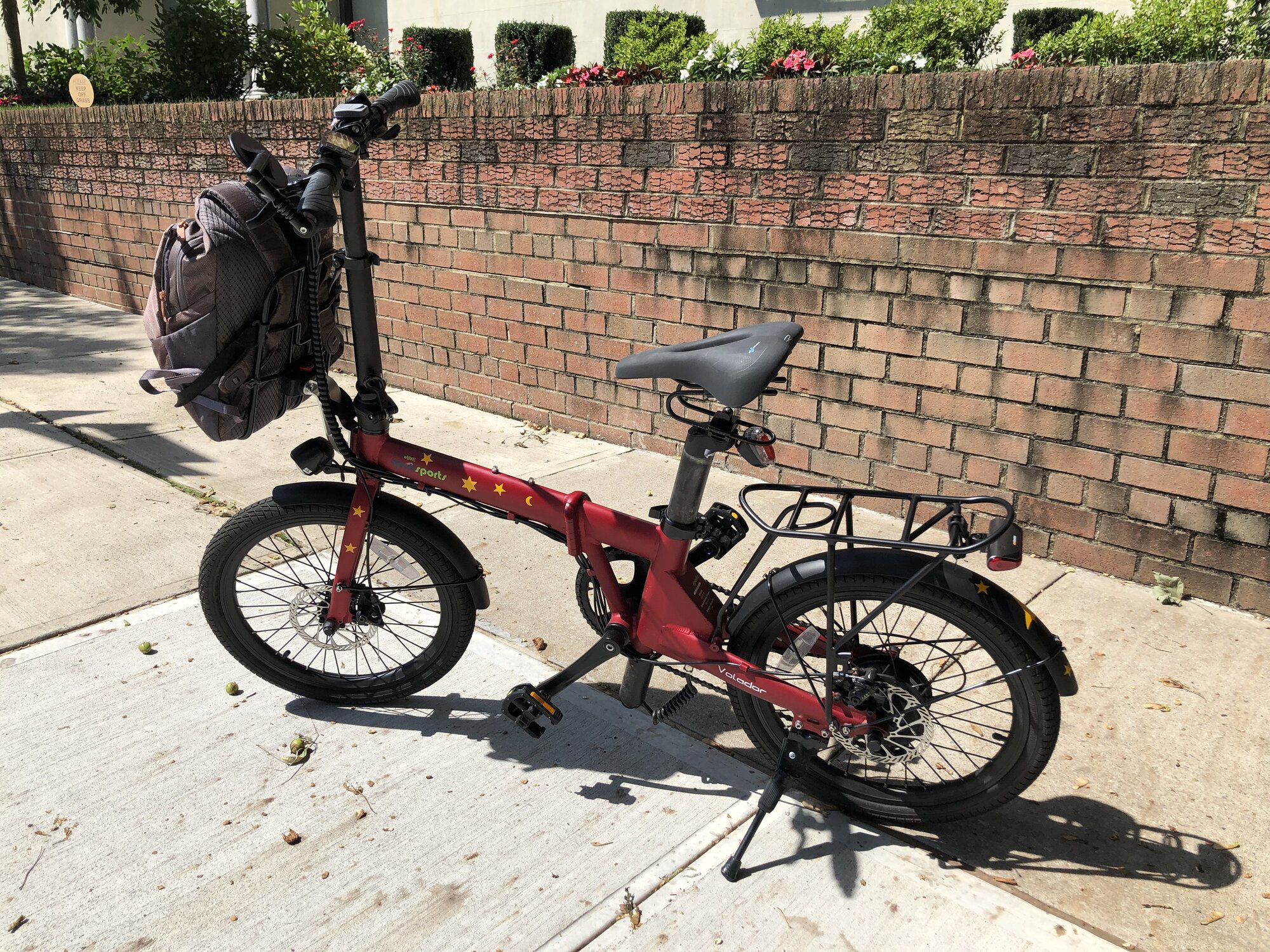

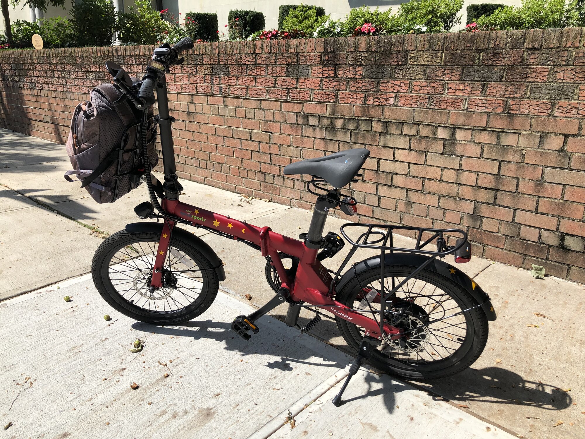

So I've ridden on Volador for about a month and hit 300 miles already. Overall it is a small and mighty bike! Really like it. I can do my 12 miles commute in a hilly area easily and only need to charge it once every day. And it folds small so I can store it in my office and no need to carry a heavy bike lock with me. I've solved the rear rack problem by using a small retract wrench and fully deflate the rear wheel. Here is a picture of my bike which is using the Kenga rack with valet truss (both from Tern). So far my backpack is very secure with the strap provided on the rack.
I also put some reflective stickers to enhance visibility. A more comfy saddle with the shock absorber is a must for volador because it has no suspension. Next, after my tire is worn out, I would like to change my tire to Big Apple for a smoother ride.....the bike path on my commute is really bumpy!
