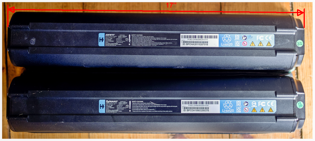

Now, I'm asking @Jim Conboy:
Do the battery contacts and the battery shape are the same in yours? Is your battery 17" long?
If yes for both, you are free to use the 500 or 625 Wh EnergyPak (Smart) as these are compatible. If not, you need to order the EnergyPak 400 as a spare.

Not correct. The 500 and 625 ones are interchangeable. The only worrying thing is Jim's battery is side-loaded, and the 500s and 600s are bottom-insertable. Might mean nothing as long as the Jim's battery format is the same. That's why I have shown the photo and gave the battery length.
Are you sure ? He has a 2020 Explore E which comes with 400 or 500wh. Maybe I am mistaken but that is not even an in tube battery, the in tube one is the newest model. I don't even think they have a 600wh option for the 2020 one. Moreover I would be very surprised if Giant had the same form factor for 400wh 500wh to 625wh , that is a wide range. For the new in tube batteries they have 500 and 625wh (no 400wh) and those are interchangeable which makes sense, probably lower capacity one uses lower capacity cells but same cell count.
My understanding was the 400 and 500 batteries side loading batteries are interchangeable on the Explore but that's it. Stefan's 625 battery design is quite different from my 2020 Explore battery.
Johnny... I own a 2020 Trance E+ and 500 and 625 EnergyPak. They should be interchangeable with the EnergyPak 400 but no-one can be sure before it is verified.
Just for reference, showing the pics of both batteries.
EnergyPak 500 & 625. They both measure 17" or 432 mm in length.
How come? Isn't your EnergyPak similar to the ones in the picture?
@Stefan Mikes you've shown us yours, here's mine:
500Wh battery from my 2020 Explore E+1. Since we're measuring 365mm tip to tip 😳
It means Jim can order the 500 Wh battery but in the format of your battery, Paul. Thanks!
more like a case that seamlessly follows the frame.
The larger format EnergyPaks also seamlessly insert into the frame. One of the best designs of the battery integration I could see so far.
