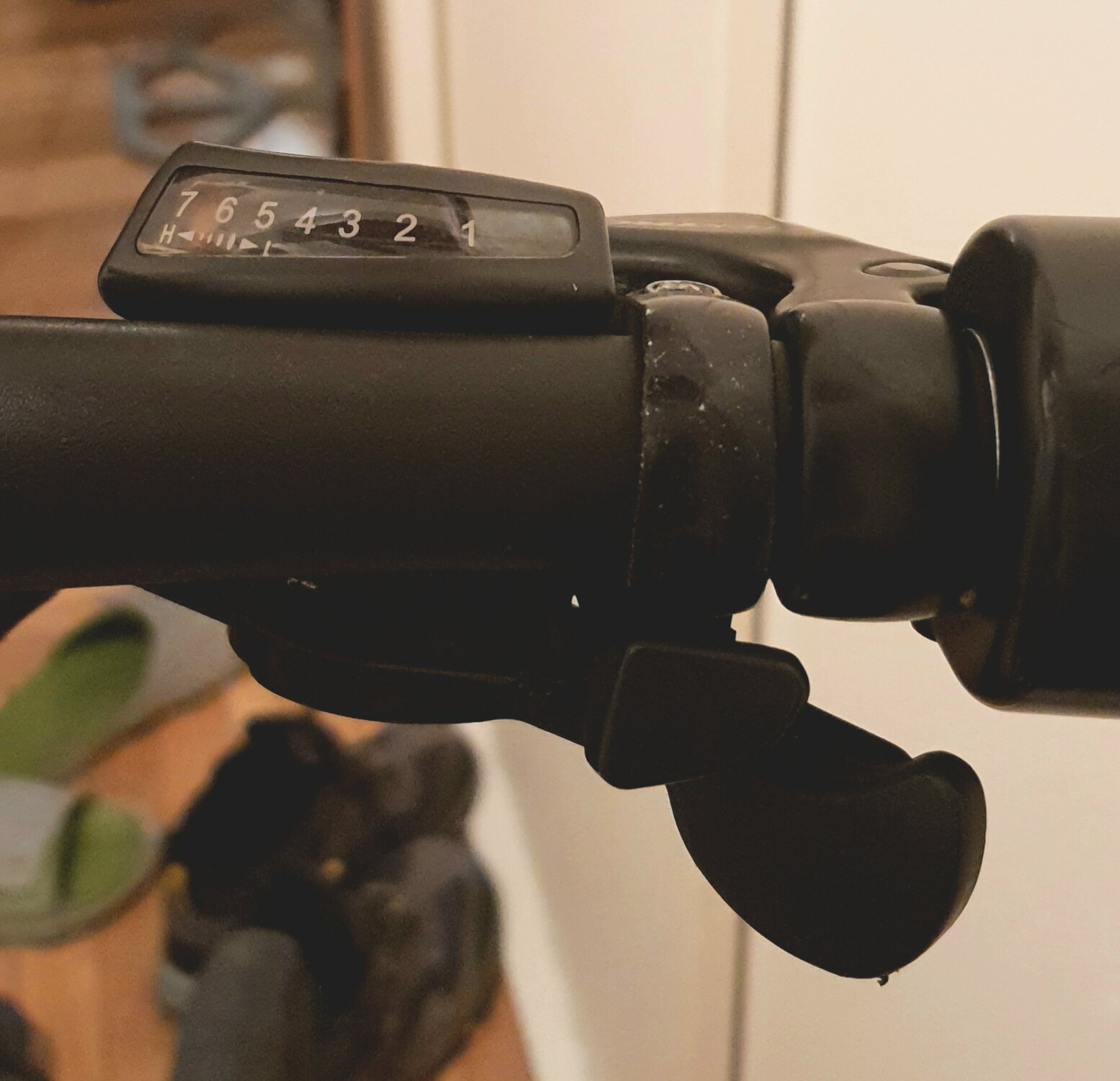

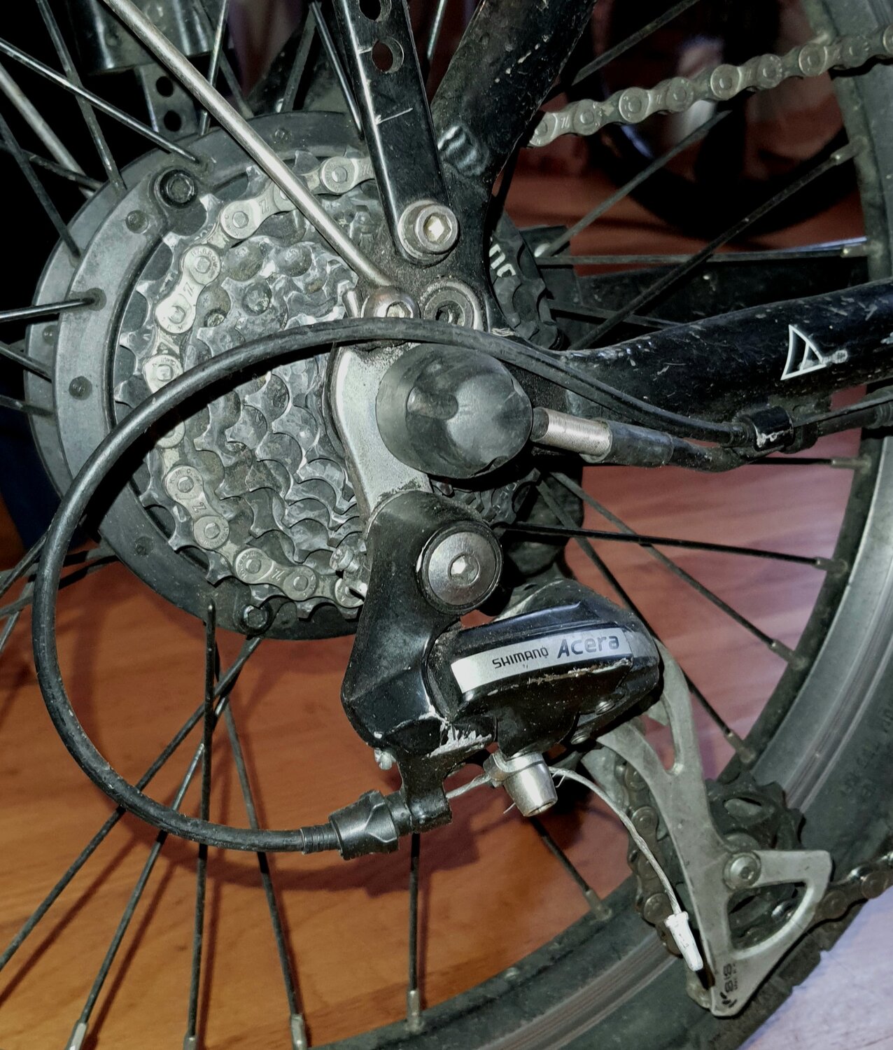

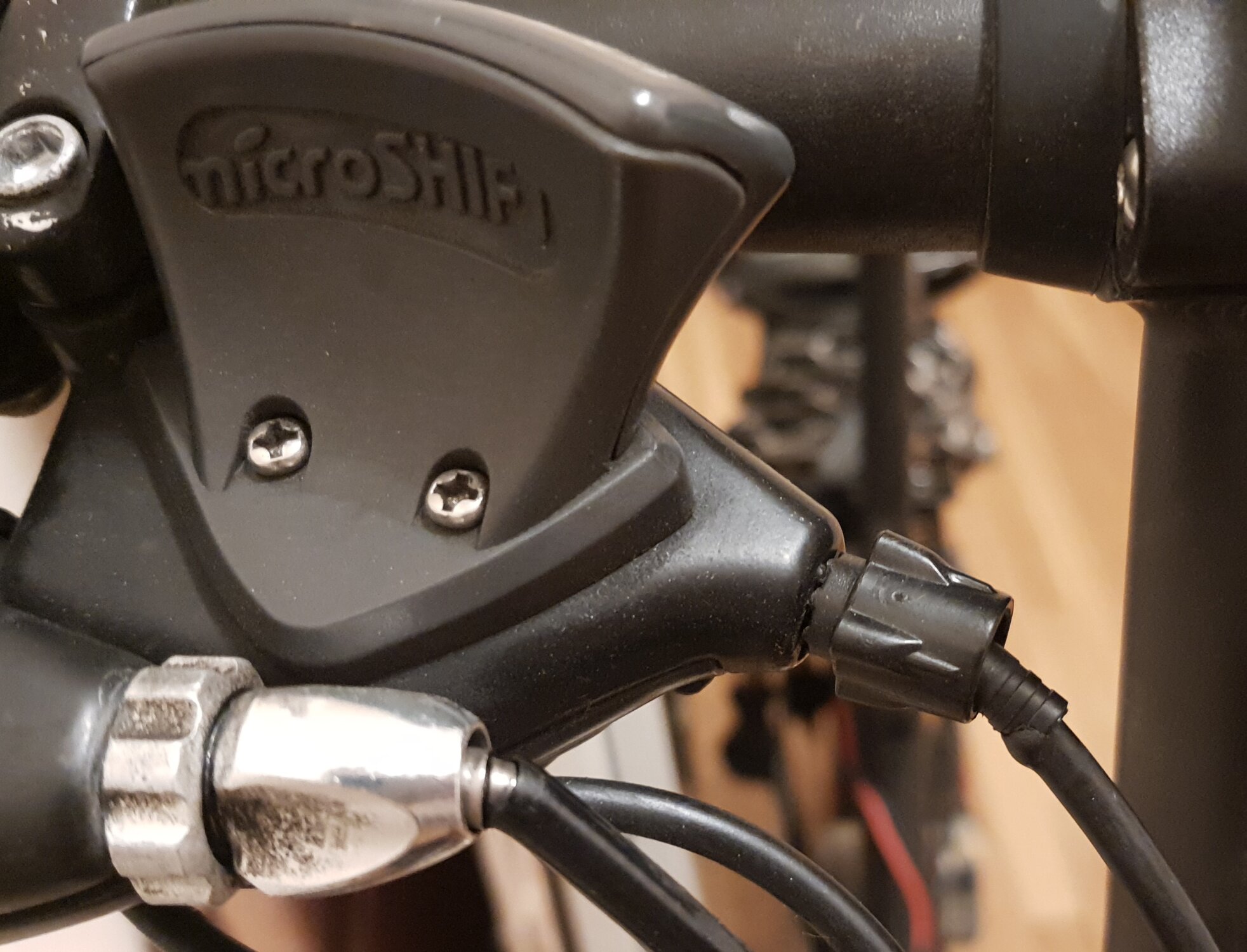

Here are some pics of what I'm dealing with on ebike, let me know if you spot any issues pls.
Maybe the problem is sharp angle where the cable leaves the shifter?
You can tell how good mechanic is by looking at cables - (paraphrasing) Sheldon Brown...
