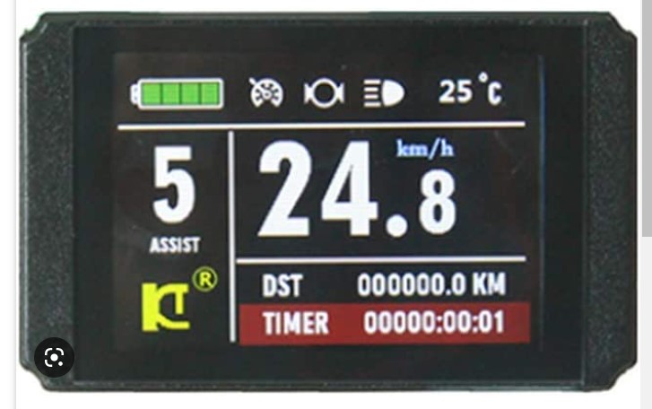

After reviewing the owner's manual, it appears they are using the KT LCD8H display? Easy to just upgrade the KT controller and it should be plug and play if you get the one with the right connectors.
I upgraded my two "750W" Aventon levels with the KT Controllers and LCD8H displays. According to the displays the bikes are now drawing 1000W peak. Same stock motors.
