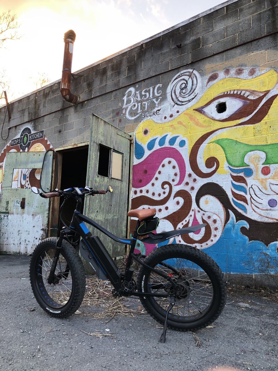

Good Day Gentlemen, I have purchased a Volt yukon 750 geared hub motor 26" bike. It's a nice bike, but I want to increase my top speed. Can I just buy a bigger controller with more amps ? Or do I have to have a kit ? I build a little on the side and I have a couple extra controllers that put out 25Amps and I think the one that came with the bike is less than that. Any suggestions greatly appreciated .
No direct experience with your Volt, but a LOT of guys have installed 35a Bolton controller kit's in their RAD bikes. Pretty popular move that removes the speed lock AND increases available amperage to the motor. You might do some investigating there....
