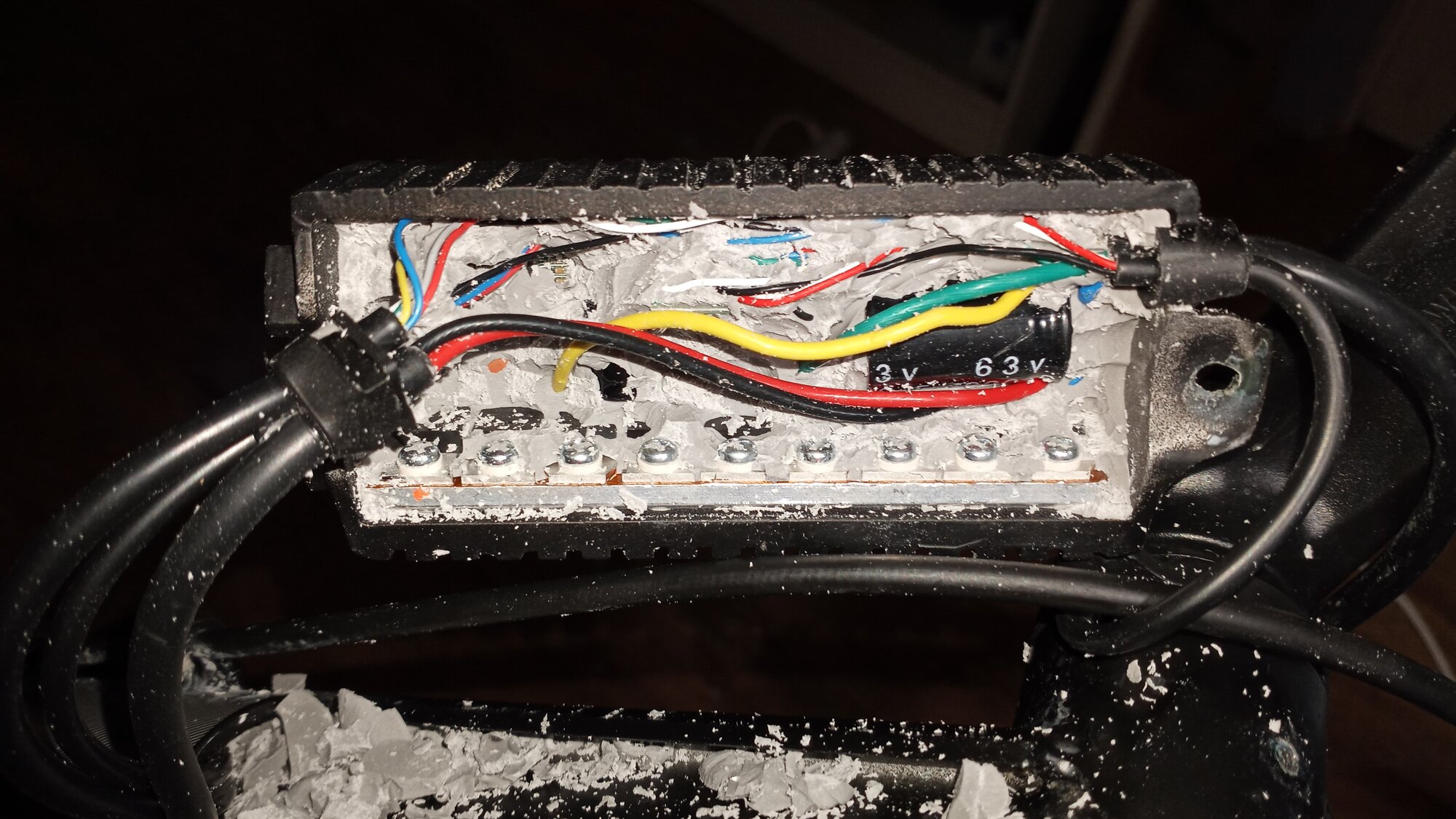

Are there marks underneath the top plate you removed? Some of those holes appear to be in high voltage areas.
PCeBiker, you offered me your C7 display but won't there be a problem with my bike given that the European display limits it to 15 amps while yours will limit it to 18 amps (my battery is only 16 amps?
Before assembling the controller I examined it carefully and although it is cast in resin, there are several small holes (going through to the plate), I wonder if this is not the reason for the problems .
Especially since the same holes appear on the other 2 controllers.
No, no marks, I was more afraid of infiltration.

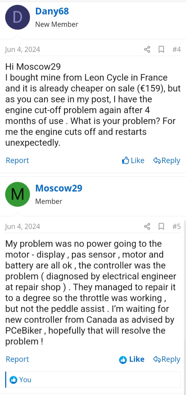

I have a milano Plus, which worked fot two years, then suddenly the motor kept cutting our intermittently. Sometimes on fairly flat terrain, other times ongoing G into a climb. Then it may go for miles without issue, on return themotot cut in and out. NC. we're little assistance, I took the bike to my local bike shop and we tested in walk mode which worked ok. Controller seemed OK, we stripped the PAS (pedal sensor) and found it full of dirt. Gave in a clean out and it cleared the fault for a while, it came back intermittently again, but at least rideable after a further 250 miles. Next new PAS will be installed. Perhaps a new controller also?Hello NCM community. So beautiful mountain walks, hence the interest in an electric bike. I bought myself an NCM Moscow Plus in 2021 and I was very happy with it, at the end of last year (around 2300 km) the engine started to cut out, first once or twice per outing to practically do stop and go after few weeks. I should point out that I always ride with assistance on 6 and that my average speed is 27 km/h so the engine is practically always stopped, and helps me "only" on climbs, and in this case its absence is makes you feel. It was explained to me that the fault as I described it came from the controller. Controller that I replaced and indeed the bike worked perfectly again for about 4 months (about 300 Km). Then the fault reappeared again, first the engine cut off as soon as I forced the pedals uphill and when I reached the top the engine started again, only to stop again and restart for no reason and no it doesn't matter when. The controller supplier does not want to exchange it for me under warranty and I do not want to buy a new one for 3 months. In addition, I bought an NCM Milano Plus for my wife, who following an accident can no longer use it (it had 350 km), so I put it up for sale recently and the buyer just told me that After doing 70 km the engine cut out from time to time. I'm afraid this is the start of the same breakdown. It same to be a problem of NCM bikes. Does anyone know what the defect is, and was able to repair it permanently? Is there any reason other than a controller fault? Thank you in advance for your answers and your help.
,.. Next new PAS will be installed. Perhaps a new controller also?
I have an NCM Milano us, had it for around 3 years now, started playing up with Motor cut outs particularly when looking for some assistance for hills. After a lot of diagnosis it was identified as the PAS sensor containing a lot of first and being worn internally. It was cleaned out and initially it managed a 177 mile coast to coast before the same fault occurring. Dirt again in the sensor and a lot of wear.Hello NCM community. So beautiful mountain walks, hence the interest in an electric bike. I bought myself an NCM Moscow Plus in 2021 and I was very happy with it, at the end of last year (around 2300 km) the engine started to cut out, first once or twice per outing to practically do stop and go after few weeks. I should point out that I always ride with assistance on 6 and that my average speed is 27 km/h so the engine is practically always stopped, and helps me "only" on climbs, and in this case its absence is makes you feel. It was explained to me that the fault as I described it came from the controller. Controller that I replaced and indeed the bike worked perfectly again for about 4 months (about 300 Km). Then the fault reappeared again, first the engine cut off as soon as I forced the pedals uphill and when I reached the top the engine started again, only to stop again and restart for no reason and no it doesn't matter when. The controller supplier does not want to exchange it for me under warranty and I do not want to buy a new one for 3 months. In addition, I bought an NCM Milano Plus for my wife, who following an accident can no longer use it (it had 350 km), so I put it up for sale recently and the buyer just told me that After doing 70 km the engine cut out from time to time. I'm afraid this is the start of the same breakdown. It same to be a problem of NCM bikes. Does anyone know what the defect is, and was able to repair it permanently? Is there any reason other than a controller fault? Thank you in advance for your answers and your help.
