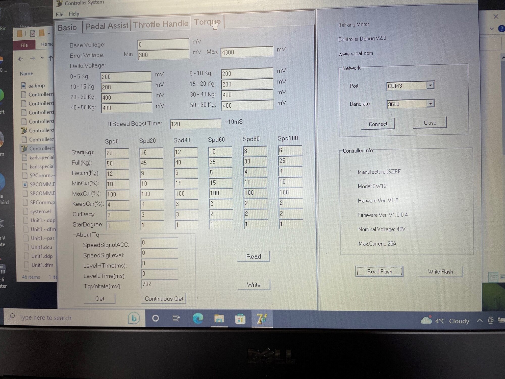

My other settings are
Pedal assist Page
Pedal type BB-sensor-32
Designated assist By Display command
speed limited By display command
start current 30
slow start mode 5
startup degree 4
work mode 10
time to stop 20
current decay 4
stop decay 0
keep current 30
