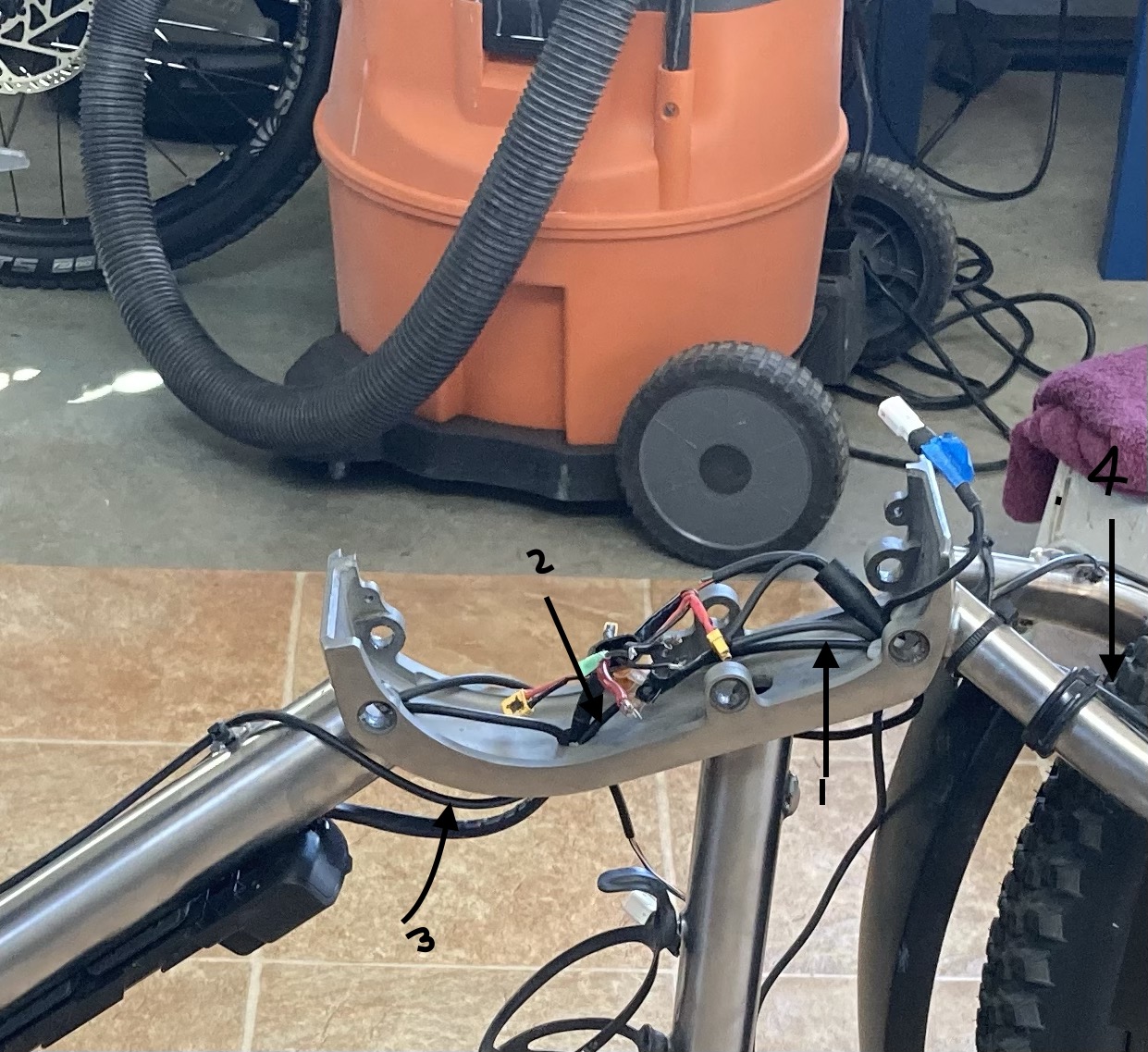

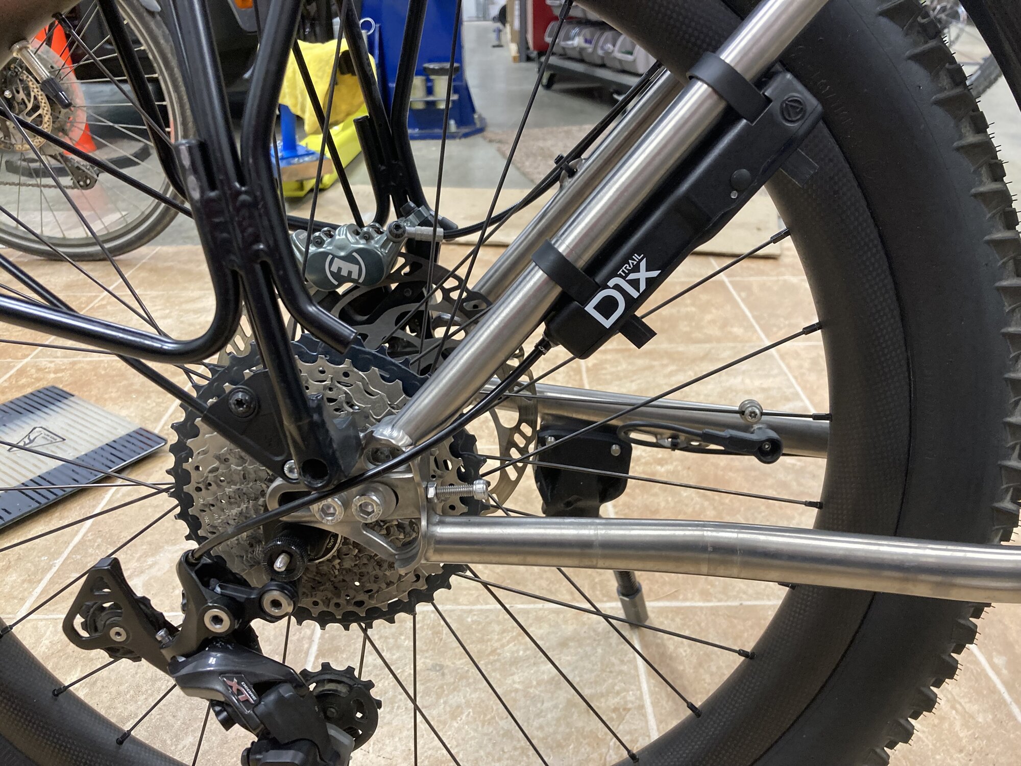

WW did something weird with the rear derailleur cable (see the photo below)
The cable runs along the chain stay (#4), then goes into the frame (#1) and runs between the motor and the frame plate.
Then it exits the frame plate (#2) and carries on along the outside of the downtube (#3).
Why it wouldn't run along the topside of the motor plate is beyond me. It would save the cable from making some tight bends to go into the motor area and then back out six inches later.

With the way the cable is now routed the motor would have to be dropped to replace the cable.

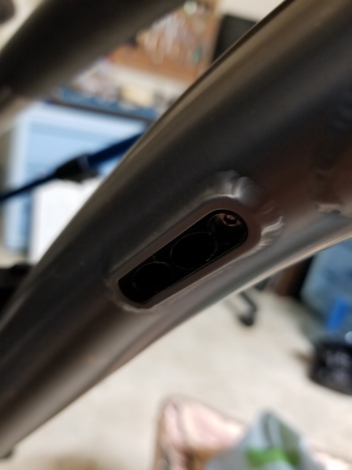

Well, so much for waterproofing. The frame's makers drilled/ cut holes in the plate where the tubes are welded - for gas shielding on the back side of the bead. In fact I'd've thought a lot less of the weld's integrity if they hadn't.
But any water into the seat, top and/ or down tubes funnels directly into the motor.
BTW. The hole (large enough to stick my finger into) in my first DP-6 battery case's end (shipping damaged), I can see dead-ended wires with silicone smeared on the ends, and bright wire showing through.
Do you have these internal wiring ports on right side of the downtube?

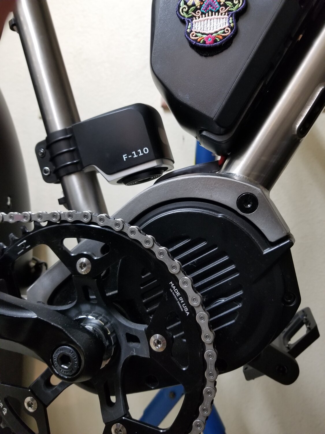

That horn weights a lot. Loved it, but it's why I dumped it. 1lb? 2lb's?
Easy for me, since all I wanted was the alarm and the F 110 has a plastic housing/ clamp (yes!!!). It weighs 1/4 as much, w/ a BT remote control key fob.

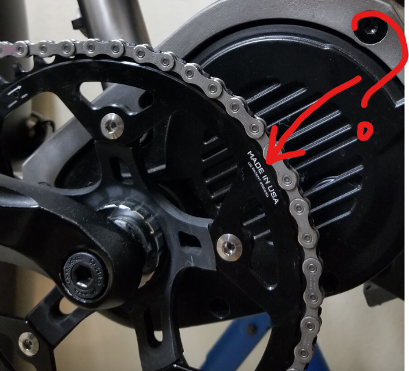

Is that a steel chainring? My M620 with 3000W Innotrace controller damages aluminum chainrings withing a single ride (deforms the teeth making them wider which damages the chain spreading the chain links). So I stick with steel chainrings but can not find anithing other than those Bafang motors steel chainrings which limits my choice in terms of teeth amount and shape.

TPEHAK, the chain ring is steel. This much power would chew the crap out of an aluminum chain ring in no time.

Can you please share the link to who makes those steel chainrings?
For the Ultra motor, if you're using the stock spider you need a 5 bolt 130 BCD chainring AND then you need a tooth design that's compatible with the chain you're using. For instance, see this Wolf Tooth page, which says in part:
