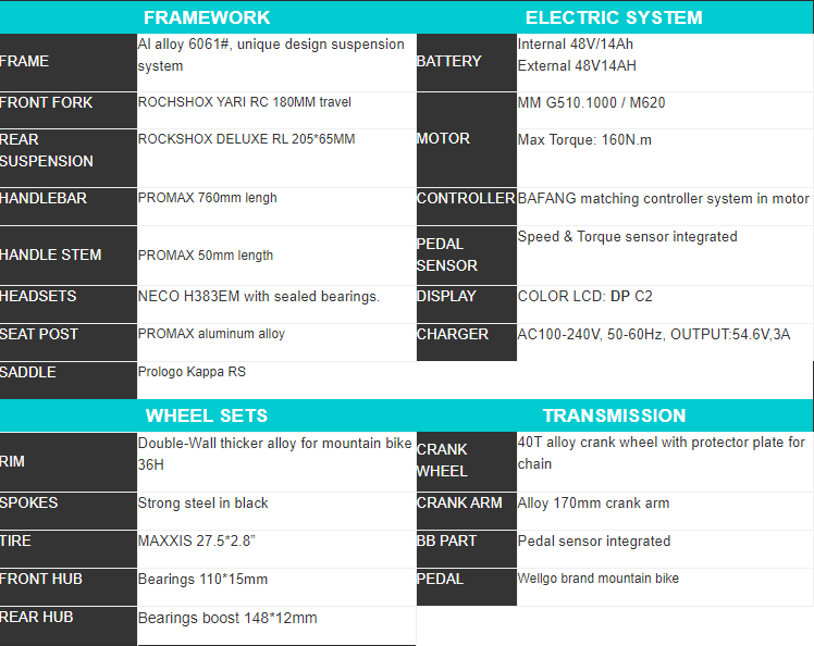

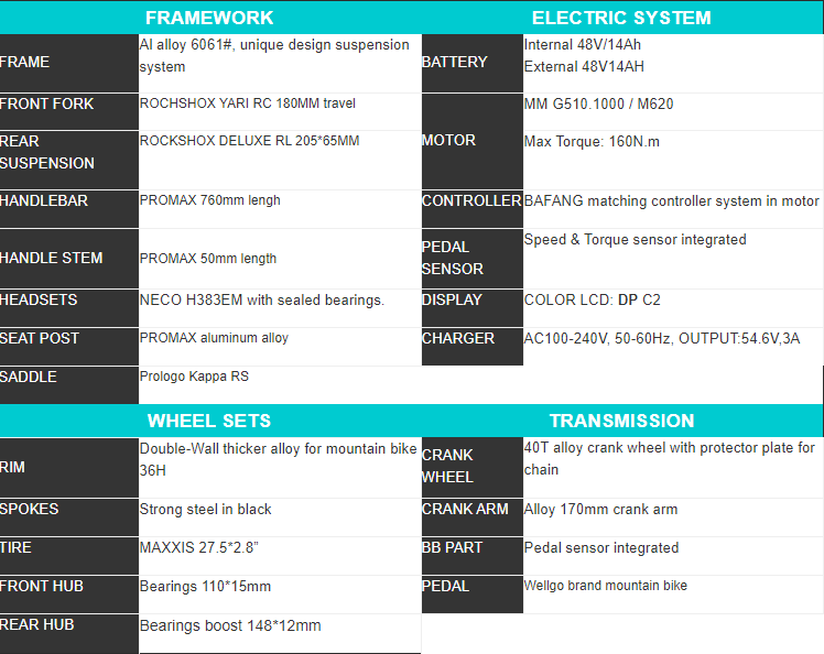

Better fork? They are basically the same tier forks actually (motion control dampers). Yari is long travel trail, Recon is cross-country.
- Yari is a few tiers up from Recon which is part of their affordable value line, thus the more than double the price difference
Same brakes on both bikes... Biktrix gives you a couple options.
- Frey will also give you change out brakes to what the customer wants...I think you're reaching
Frey uses a cheap NECO headset, the Ultra Eagle uses actual Cane Creek.
- Frey will replace the headset at customer request - there's really only $20 difference retail...Again I think you're reaching.
52V high capacity pack on the Eagle is IMO preferable... The whole 28Ah on the Frey puts the bike weight at well over 80 pounds, which is hella chonk.
- I agree 52V may be preferable, and Frey will offer the 52V at request, but offers 48V as a precautionary measure for the longevity of the motor and drivetrain
- You have the option to ride only with the integrated battery. Eagle doesn't.
Frey has 11-speed XT shimano, Eagle has SRAM GX 12-speed... No contest here, SRAM for the win.
- Frey can also be offered with SRAM
But you forgot one main difference - Frey EX is a Full Suspension eMTB, Eagle is a Hard Tail.
If I were shopping between the two bikes I'd pick the Eagle hands down, it's a more refined and nimble ride, from inventory already in North America.
- If I were a Bitrix employee like yourself, I too may with the employee discount.
