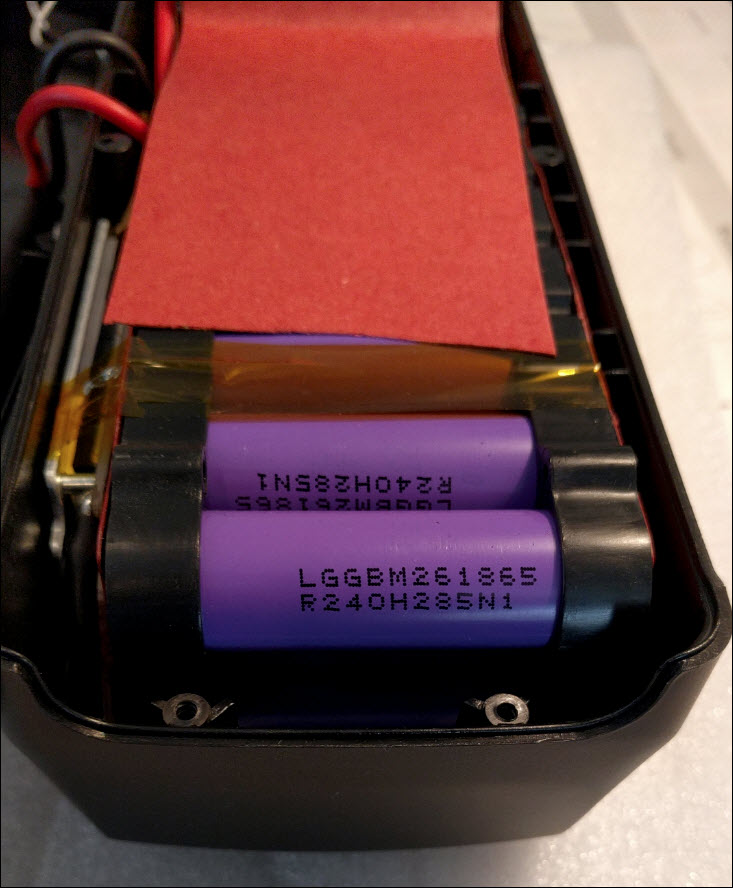

My battery is packed with LG cells.
LG makes a range of batteries. Many are designed as stand alone batteries or laptop packs. All LG batteries are not great for eBike packs.
These are typically not used as eBike cells, which explains the low price. As long as you're drawing lower amps it will be OK. But anything more than 20A despite their claimed 10A rating may be a strain. But if you're happy...perhaps thats all that matters. Actually the lowly 26F is perhaps a better choice. As always YMMV.
"This battery is neither high capacity or high current, both parameters are more moderate and with a end voltage of 2.75V it looks like it is an older chemistry.
The quality looks good and if the price is right and the application do not require top capacity or power.

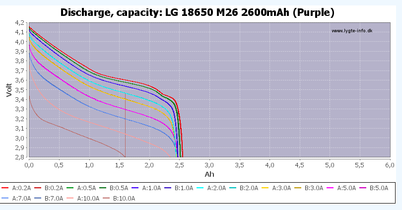

"This is a very good cell for a standard 2600mAh cell.
Remember that the cell is unprotected this means it will have higher voltage at "high" load than protected batteries.

This graph confirms the value of the Joyisi battery. You get value, name brand LG cells without paying the premium for energy you may not need (See also: SSD/CPU/RAM/Hellcat/93 octane).

This graph confirms the value of the Joyisi battery. You get value, name brand, LG cells without paying the premium for energy you may not need

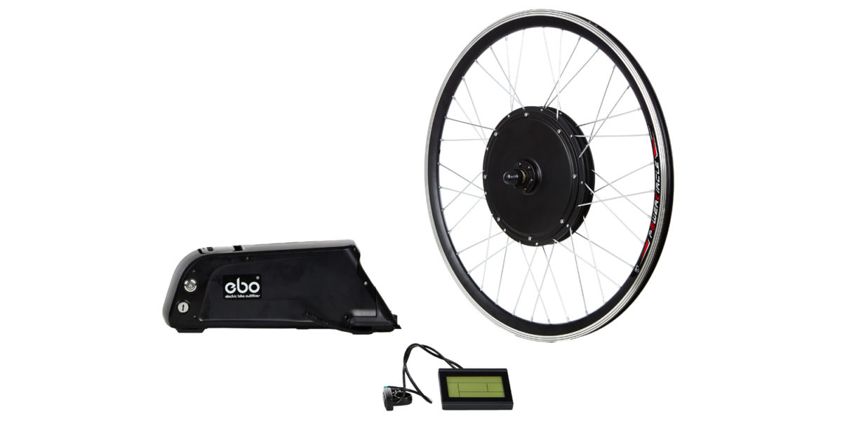

Front Wheel Electric Bike Conversion Kits
Electric Bike Outfitters Clydesdale 2.0 Kit Review
When picking a front hub motor or a rear hub motor there are several factors to look at to ensure you get the proper kit. The major difference is weight. You want to make sure that weight is distributed uniformly, from front to rear. Most batteries are mounted in the middle or back of the bike, so a front hub motor could equalize the weight distribution. A front motor might make the front wheel heavier and harder to steer, but the rear-mounted motor will need to fit with your derailleurs. The front motor is mounted in the center of the front wheel, making it very easy and simple to install. It's recommended to install a torque arm to handle torque since there isn't a lot of traction on the front wheel and a powerful motor would spin out the front tire.
A front motor essentially pulls you while a rear motor feels like you're getting push assistance.

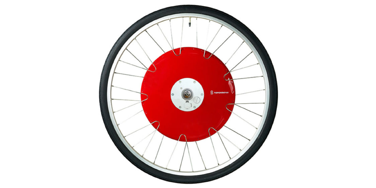

Rear Wheel Electric Bike Conversion Kits
Superpedestrian Copenhagen Wheel Review
If you want a powerful motor, over 500W for example, a rear hub motor is a great option. The more powerful the motor, it's very likely that it will be heavy, over 20 pounds. Many riders find the rear hub motor to be a better option, with better handling, weight distribution, traction, grip, etc. Because the front wheel remains light, you don't need to worry about the type of front fork and since all your weight is on the motor in the rear, you will get better traction in any condition.
Rear motor hubs feel like you're being pushed, which most riders are already used to. You also have a greater option with more powerful motors.

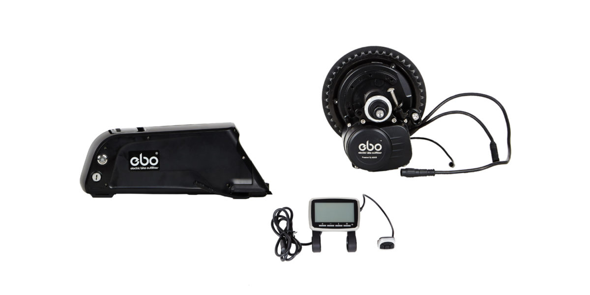

Mid-Drive Electric Bike Conversion Kits
Electric Bike Outfitters Mountaineer Mid Drive Kit Review
If you live in an area that requires being able to climb long and steep hills, this conversion kit is a good option. A mid-drive motor powers through the drivetrain of the bike.
