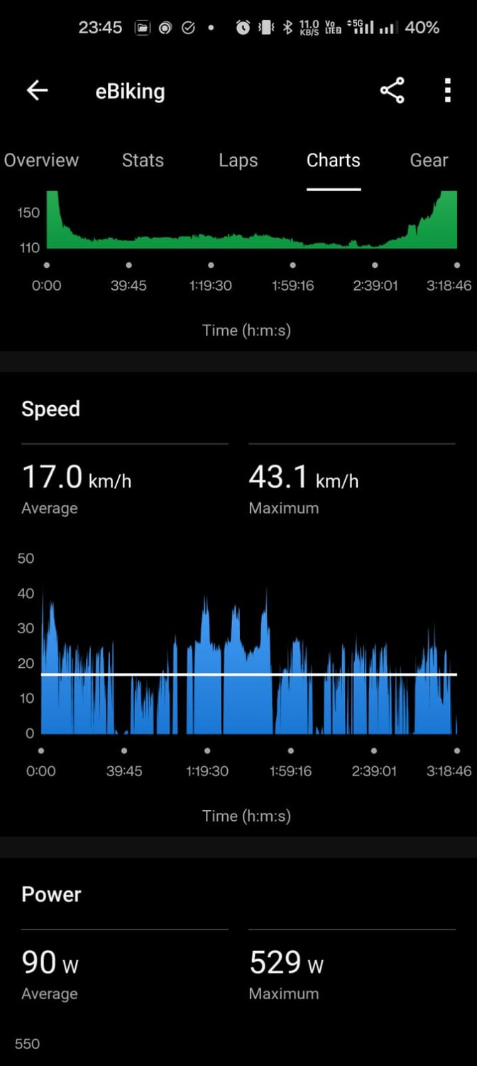

Today i managed on flat surface get to 43 km/h for 3 min with no wind, i did little training of intervals . It is easy for me to get up the 34 - 35, then i need a lot of work and my hart-rate goes around 155-165 ,which means that i need to practise 🙃
