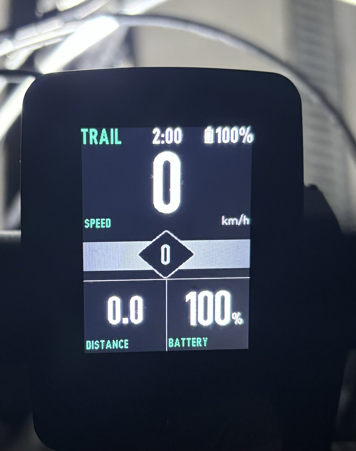

Good morning, We have 2 turbo tero x (5.0 and 6.0) and both have same problem. Sometimes, randlomy, our display tcd mastermind, lose data (clock, partial distance..) and we don't know why. The clock return to "2.00" and it remain always at this time.
The kilometers reset to zero but then start counting again.
It can happen 1 or 2 time in one month or only 1 time in 3 months. In both ebike. In any % of battery they are, there is no rule.
No upgrade firmware available.
Never specialized dealer can help us.
Some of you have some idea for this problem?
Thank you
Ps. In photo my display at this moment
They (I have ask to multiple dealer) say that there isn't available any software update, for both ebike. So they don't know why I have this problem. And in No european forum I found some other guy with the my same problem. It is very strage.
I only noticed one thing : If I Charge my battery outside ebike, this problem Never happens.
I am very disappointed

Yes, I confirm. I have 2 different ebikes, but I use the same original 4A charger for both. Random wall sockets, both with the battery in and when I take it out. The tcd display is identical for both ebikes as are all the rest of the electronics. Very little changes. This 'reset' actually happens more often when I have finished charging them. But I remember very well that it happens occasionally when the charger is not being used at all. For example, I stop for 5 minutes in a shop, switch the ebike back on and everything has reset. Tomorrow I will try to call the specialized service, but as you say these random errors are difficult to resolve. I'll start by changing the power supply. In the diagnosis of the ebike it never gives any error.
Niko, did you ever clean the battery and frame contacts with a contact cleaner spray?
No, actually never. On none of the bikes..they both started doing it 1 or 2 months after purchase. They are from November 2023. That can't be the problem, I don't want to believe it.
But apart from the partial reset, which could be due to some momentary ECU error.. Why then do the partial kilometres start to rise again, while the time remains stationary at 2.00? If I don't set the clock myself, or if I don't synchronise the ebike with the mission control app, the clock always stays stopped! 🤔
