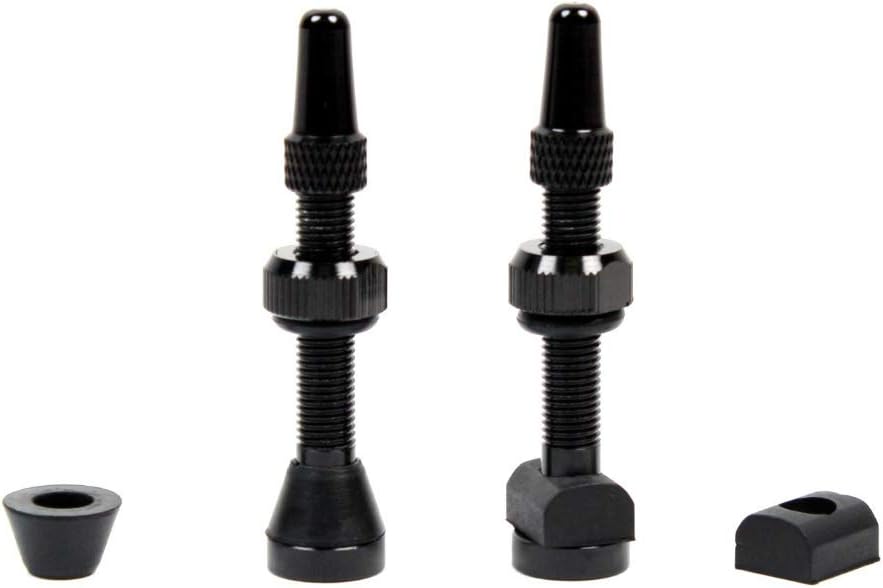

I had that issue with my biktrix emtb which came with Schrader valve on sunringle wheels.
I over tighten the stem and it leak sealant at max pressure. I had to dismantle the whole thing and replace the o ring with a thicker one.
Presta valves for some reason seals better.
The solution to that, I found, is to pick tubeless valves that have metal lips on the bottom. Stans valves don't have those and if you tighten them too tight, they can pull thru. Had that happen with them myself. I use long Orange Seal valves on my triangular fat rims, or 40mm MBP's on my others, which seem to be of good quality and inexpensive.
I've heard good things about the Muc-off valves.
