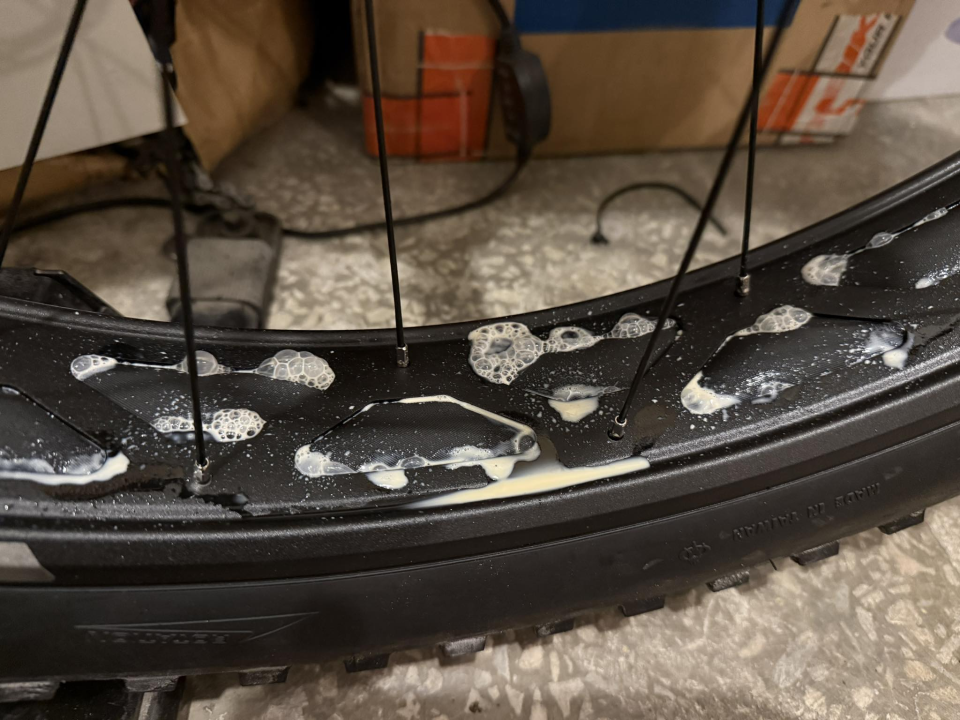

I have cutouts and tubeless fat tyres
			Yeah, but Charge, you refuse to change ‘em!I have cutouts and tubeless fat tyres

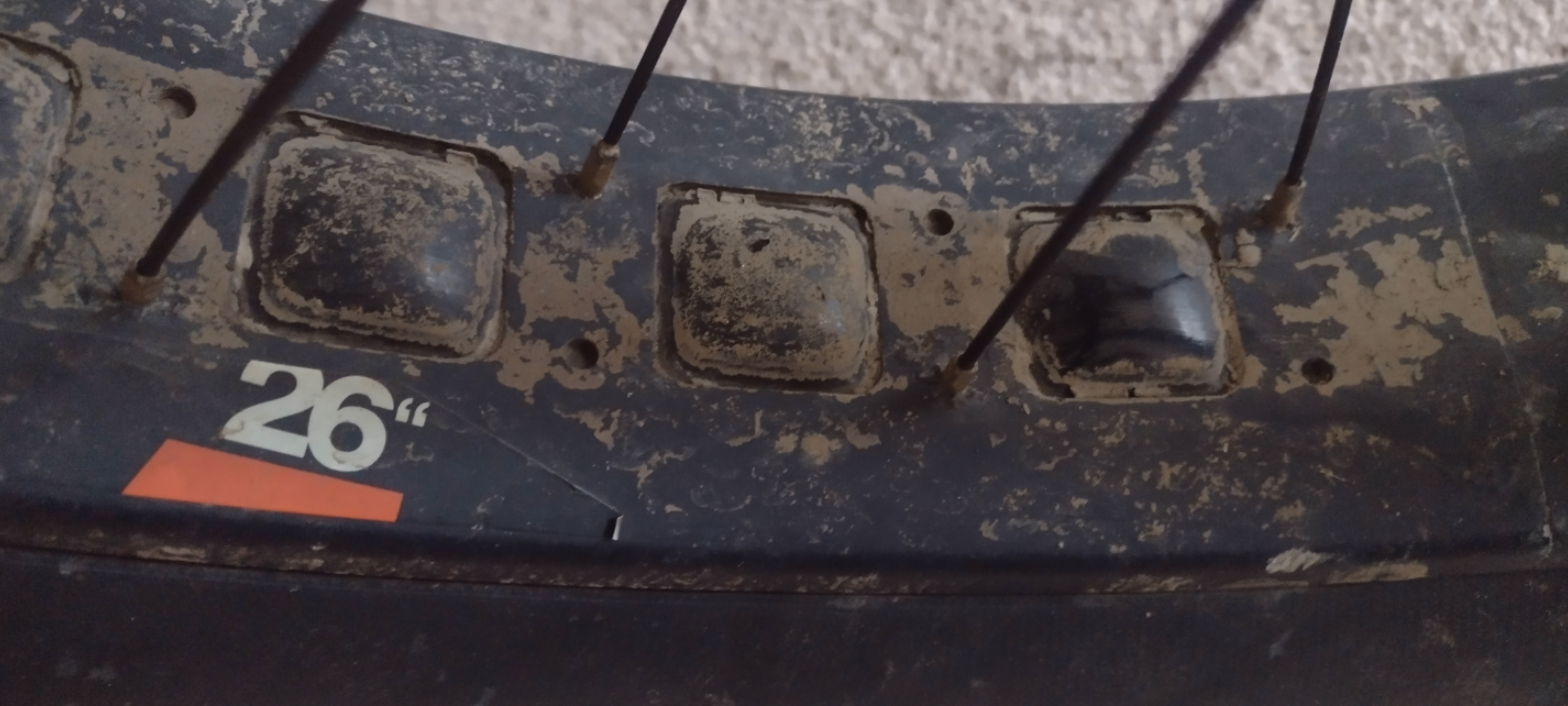

Yes, cutouts are common in fat tire rims, but I've always assumed those rims were for tubes. And I see the trapezoids, but are they all the way through? Also much larger the individual openings I'm used to seeing in fattie rims. Seems like that would put a huge burden on both the rim tape and the remaining metal.rim tape? I dunno, Jeremy.
Am I wrong about the cutouts? Look closely at the bigger picture. Are those not trapezoids? Is this not common with fat tire wheels?

That doesn't look like a trapezoidal cutout to me.

Well, there's the definitive answer. But have you seen cutouts as large as the trapezoids on the rim in question?I have cutouts and tubeless fat tyres
They are pretty big, but the difference between a tube and just air behind the rim sleeve isnt obvious.Well, there's the definitive answer. But have you seen cutouts as large as the trapezoids on the rim in question?
A fat bike rim is huge. If it were solid then it would weigh (figuratively speaking) tonsHow can you have cutouts in a tubeless rim?
FYI, mine doesn’t have the cutouts, but that’s what I thought… pretty common.A fat bike rim is huge. If it were solid then it would weigh (figuratively speaking) tonsTherefore, a fat bike rim has trapezoidal cut-outs to reduce the weight.
Understood. My mistake was in thinking that the cutouts forced them to use tubes. Apparently not.A fat bike rim is huge. If it were solid then it would weigh (figuratively speaking) tonsTherefore, a fat bike rim has trapezoidal cut-outs to reduce the weight.
