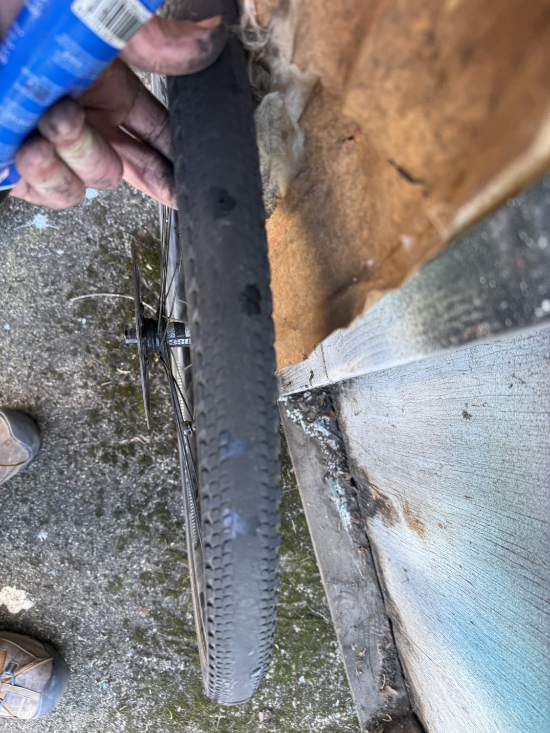

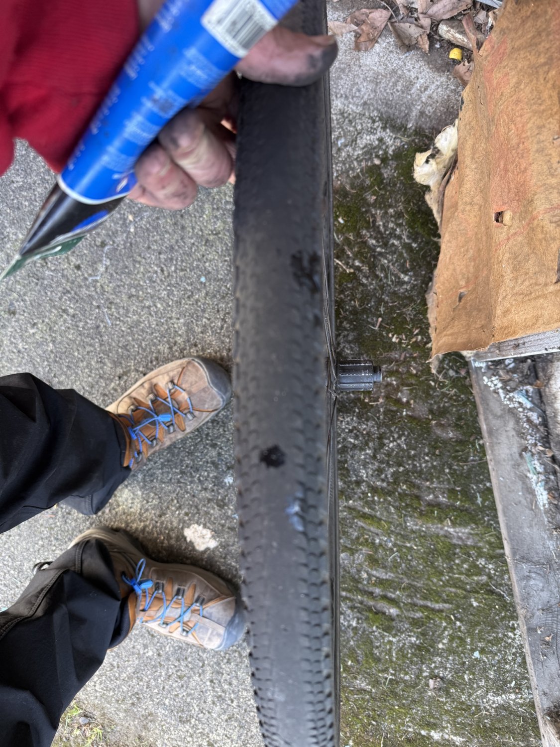

What I like about tubeless is that I seldom have to stop and deal with an issue; I can usually make it where I need to go, or I just need more sealant, as that's why it did not seal. It needs a plug. But I can run lower PSI for a smoother ride, and I can have nicer riding tires without the worry of punctures I would get with tubes. I have ridden the same tire with and without a tube, and the ride is nicer without.
