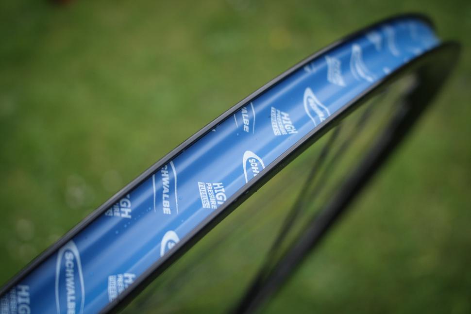

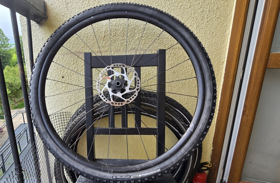

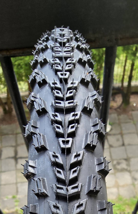

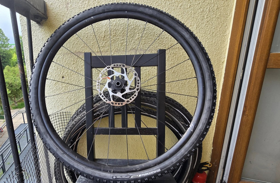

First, I replaced the 23 mm tape for the front wheel with a 21 mm one, and installed a tubeless valve. Then, I installed a brand new
Specialized Rhombus Pro 2Bliss tyre on the rim. As soon as the tyre was pulled on, it sealed dry with an ordinary floor pump! Then I deflated the tyre, poured 65 mm of liquid sealant into the tyre, gave a good blow from the compressed air tank, installed the valve core, inflated the tyre to the max allowable pressure (actually, half bar above), and put the wheel onto my Vado SL to be able to roll it often to distribute the sealant evenly.
View attachment 194813View attachment 194814

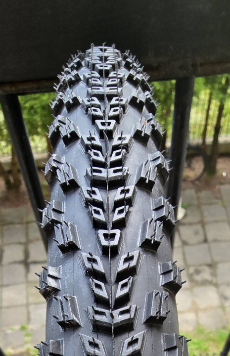

Rhombus Pro is the most aggressive gravel tyre made by Specialized. I tried it before on a demo Diverge Comp bike ridden in a sandy terrain. It is a true Tubeless tyre: its interior is lined with a black airproof material.
The rear wheel holds one of the old Tracer Pro tyres, that was as cooperative as to eventually seal on the rim. I expect issues with that tyre. In case of deflation, the tyre bead will surely pop off the rim hooks. I consider a purchase of the second Rhombus Pro, and installing it tubeless for the rear wheel for the race of 28th July. The race is to be ridden in Varmia, and I expect gravel with patches of shallow sand there.
