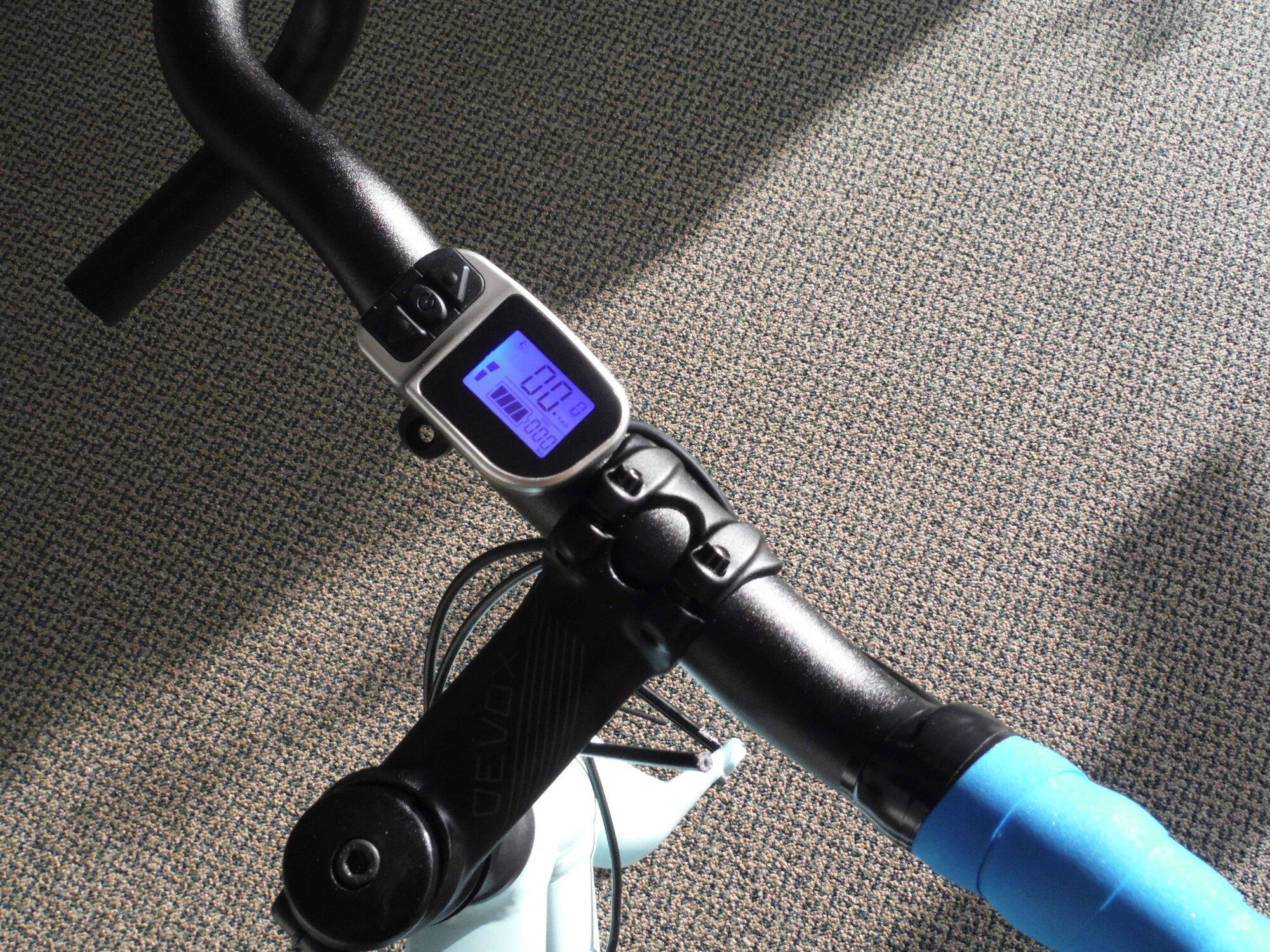

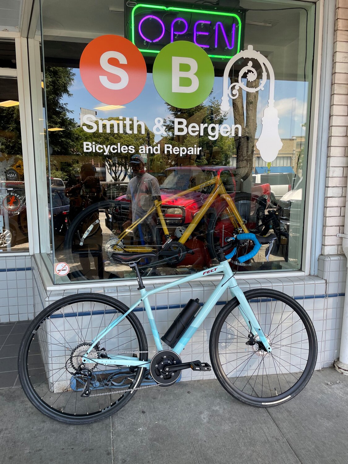

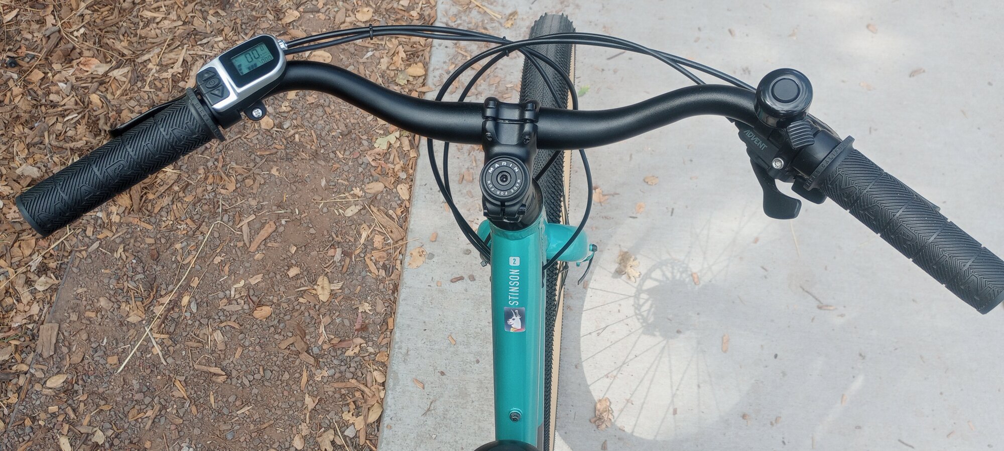

With the VLCD-5 you get into the hidden settings by holding the power and i for about 8-seconds at start-up. I set one up this morning with 17 amps, 28" wheels, Mile unit, Speed 45K, 1 magnet. Here is a photo of the bike I made yesterday. It has the simpler 6 display. Check out the gears on this cruiser. Stinson is a beach in Marin County that looks out to the Golden Gate, the bike is a Marin bikes Stinson 2. It is their modern take on the classic beach cruiser. I suspect that a wire is crimped under the controller.

The B is also better protected from water incursion on the drive side. It has a different step-down gear system. Throttles and speed sensors add lag. I ditch them. Ahh, so much better. The idea of a throttle has more appeal than what it does in the real world. The B does not take standard chainrings because of that added water protection. They will scrape a seal or need to be filed by 2mm around the inner diameter.

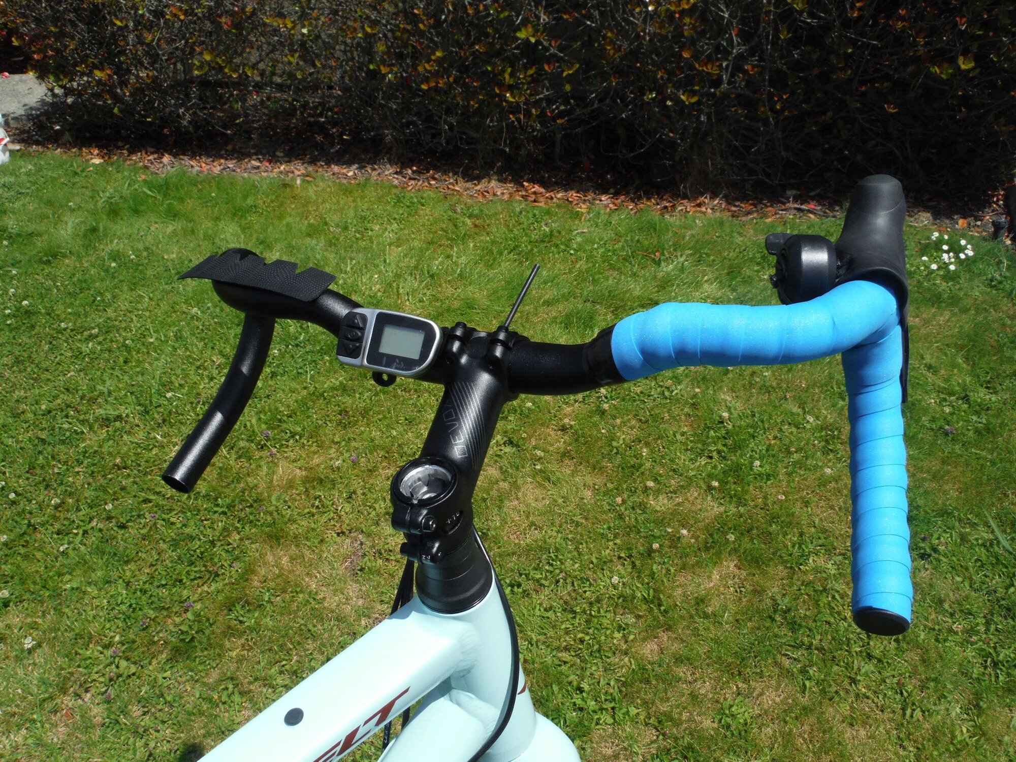

You could program with the VLCD-5 and swap it for a VLCD-6. I almost exclusively use the 6. It is only available as a six-pin, the wire is 4mm. That allows me to go through frame. In 2019 I built a bike that had narrow chain stays. The standard speed sensor didn't fit, so I said F-it. And rode the bike for a year anyway. Then I came up with a hairbrained idea on how to adapt the speed sensor. It worked, but the bike then sucked. Forever it will have 1.6 Km on the odometer. I yanked that speed sensor as fast as I could, then the bike was amazing again. No lag, smooth, and perky. You need to have a display to operate the bike. The 6 is small and you can hide it anywhere. This is off topic: Remove the chainring with the five 4mm hex cap screws, then remove the plastic main gear cover with the four 2.5mm cap screws. Pack that cover with grease around its perimeter and replace. That grease will save your motor. It is important.

Thanks for the advice on the grease. I can probably fit 4mm through the access points on my downtube. Do you cut and reconnect the connecter?

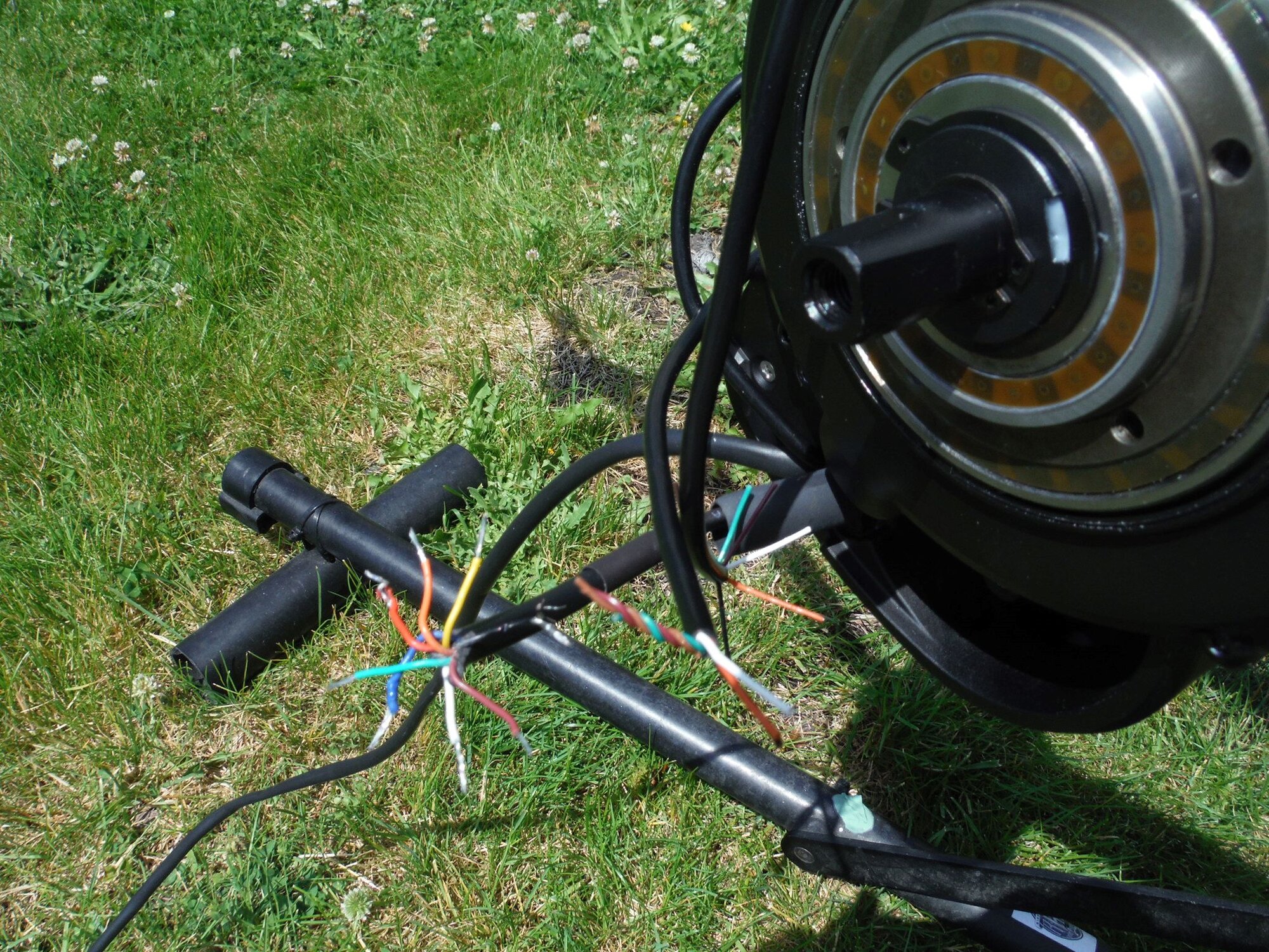

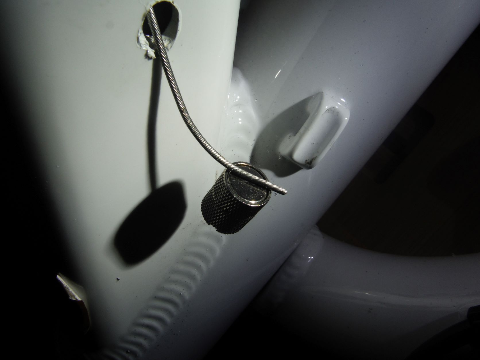

Yes, I chop the connector, remove the 10 gauge insulation, and solder the six wires. I use small shrink tube on each little 24 gauge connection, three go one way, three the other, and then it gets 1/4 inch shrink tube over the whole thing. It all disappears in the hidden compartment under the chainring. You will need to fish with a brake cable and wheel magnet.

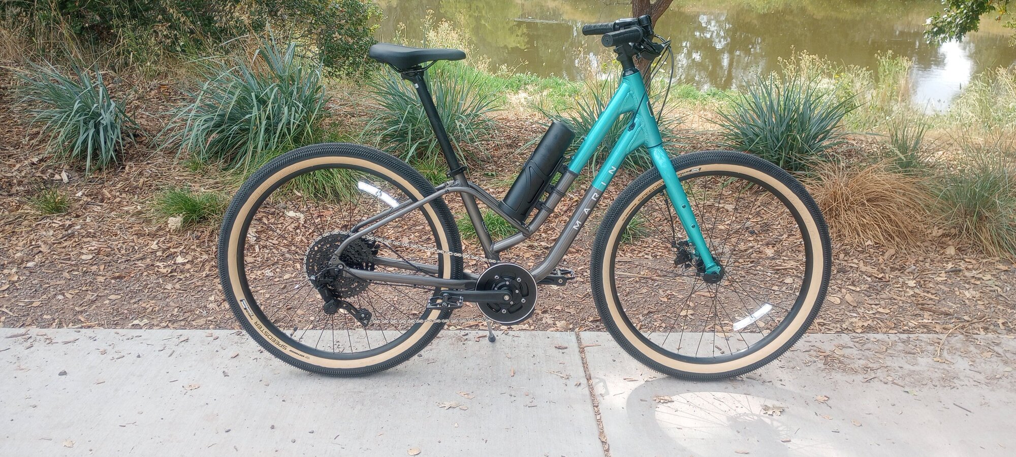

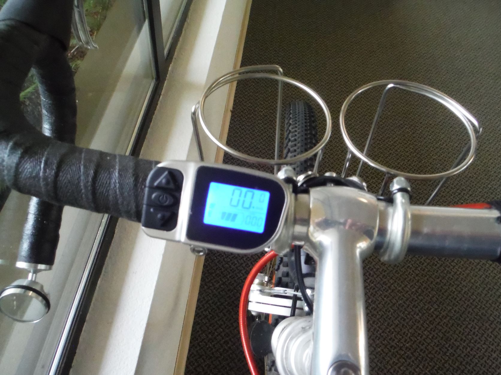

Bikes that are through frame for the shift and rear brake housings need to be rerouted over the bottom bracket. I just got a new bike today. All I have done is install a kickstand so it won't fall over. On this one I will need to drill to route the shift, brake and display over the BB so they do not get crimped by the motor. It is a sweet starter bike and huge bang for the buck. It will be a commuter build with rack, panniers and German fenders.

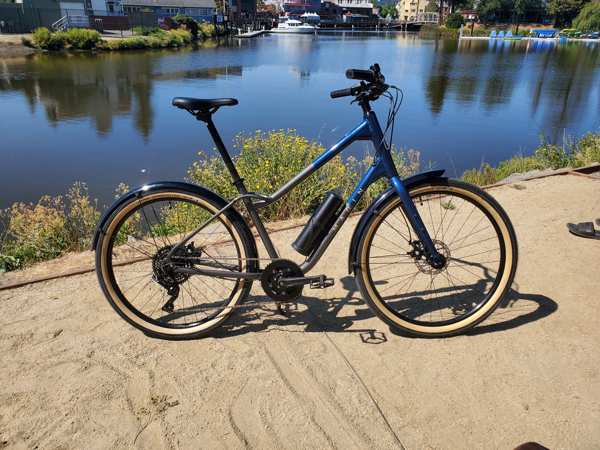

@kevinmccune, I had a 350W TS that had very narrow chain stays and couldn't fit the standard wheel magnet pickup. So I did the build without it. Then one year latter I figured a way to mod the speed pickup to make it fit. It made the bike SUCK. That bike will forever read 1.3Km on the odometer. Throttles will do the same. The combo of throttle and speed sensor is the suckiest of all. Also, you need to pack the main gear (behind the plastic cover, behind the chainring) with grease. That will make a huge difference. Here is how that Marin turned out.
