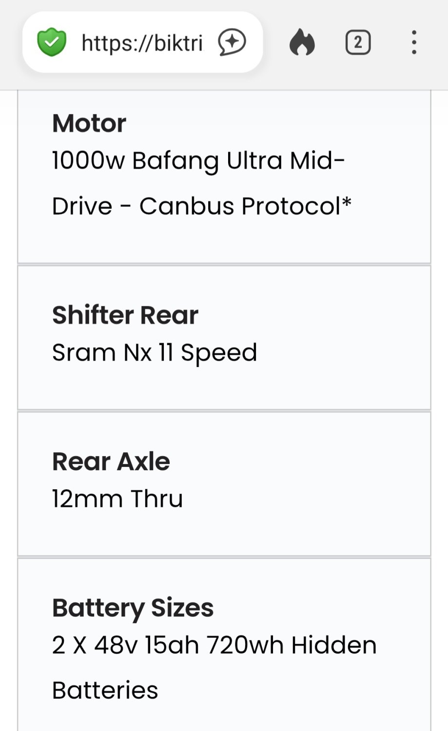

His bike has an Ultra motor.. Not BBS.
Oh, OK
I thought an Ultra motor was a BBSHD ?

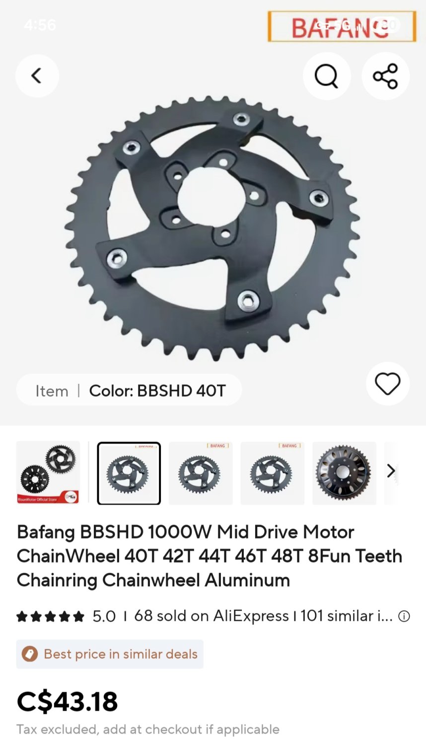

Any 130bcd chainring should be compatible... But double check as I don't know what custom stuff Biktrix may substitute.
Yeah, make sure you talk to Biktrix.
They sold the bike so they'll know what chainring will work for you.
You could probably find something cheaper on Aliexpress or Amazon, but I'm guessing that if you buy from Biktrix, you won't get a "cheap knock-off".

Ultra is a big step up from the BBS.
Torque & Cadence sensors and a bit more sophisticated programming... and a shit_load of torque.
I have mine tuned to do exactly as I want and it feels very natural. Also the way the throttle overlays the PAS... it mesh's together seamlessly.
And with the low gearing of the Rohloff.. it'll climb a tree

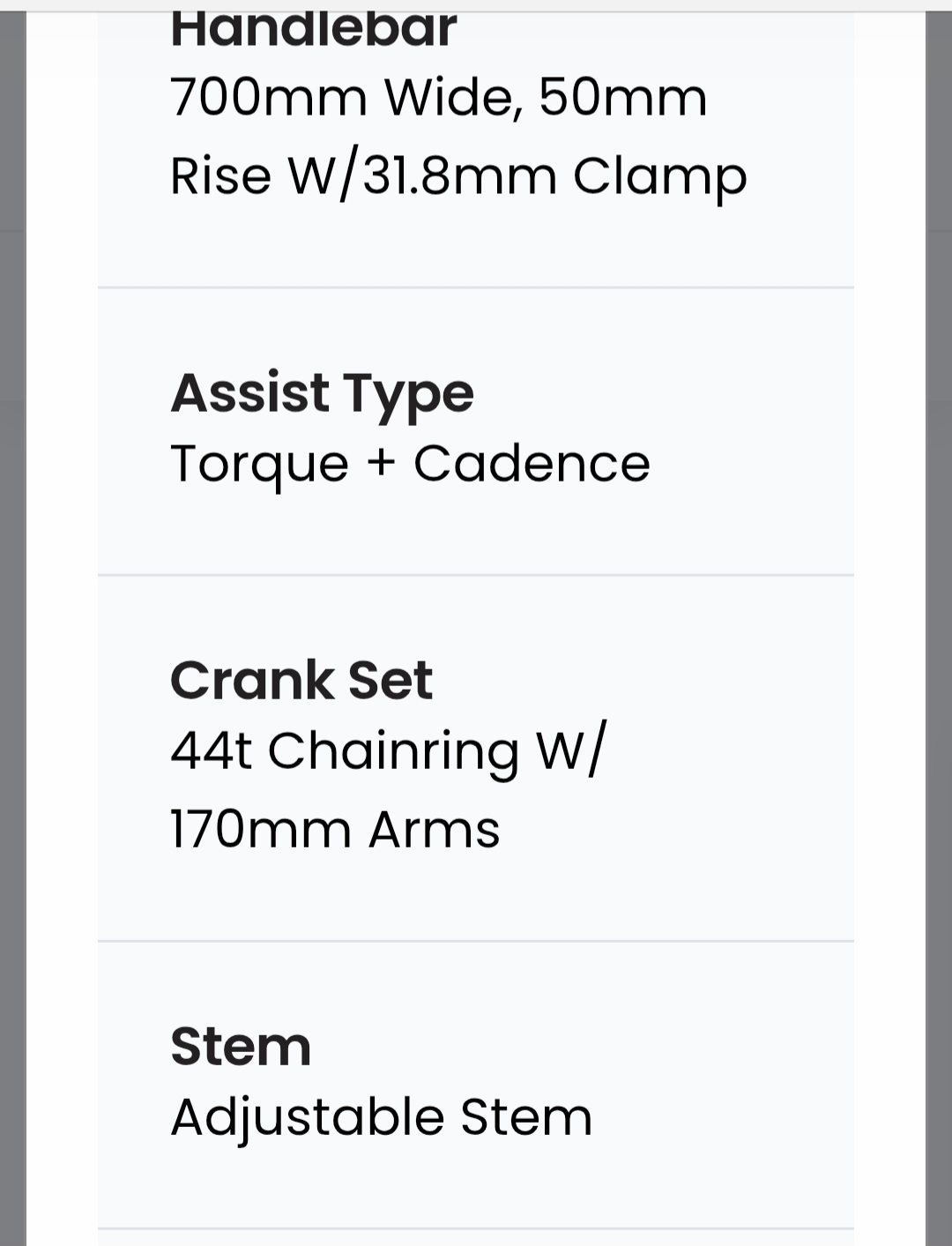

Guys
I have the following gears and chain ring set up, (counted).
9 sp x11x34 with a 44t chain ring, with the wide/narrow spacing.
A top speed of 7/8 mph while in the 34t using eco 1 step power setting,
pedaling or minimum throttle usage.
I use this gear selection for 95% of my trail exploring/riding.

If you get that 30t chainring, you might actually find yourself using second gear?
EDIT:
It looks like it looks like the smallest chainring available for the Ultra is a 40t?
That wouldn't make as much difference as a 30t.

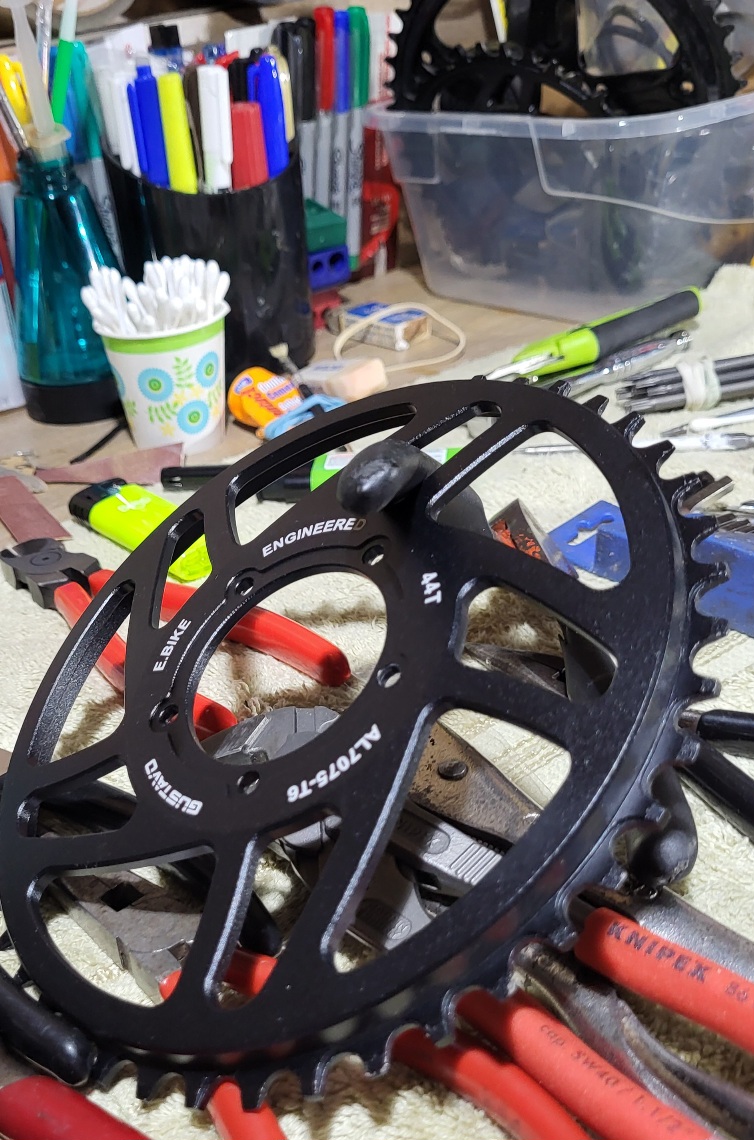

Well like I said... Plug in your numbers into the gear selector and you should have a good idea of what chainring you may want to go to.
I'm pretty sure I have a somewhat used Bafang stock 130BCD 40t that I can send you if you want to pay for shipping to experiment with.
Measure your BCD and post a pic of what you have now.

Gio,
My BCD is 130 mm and does have a Dual Shield on each side of the chain ring gear.
I don't know if that Dual shield makes any difference.
