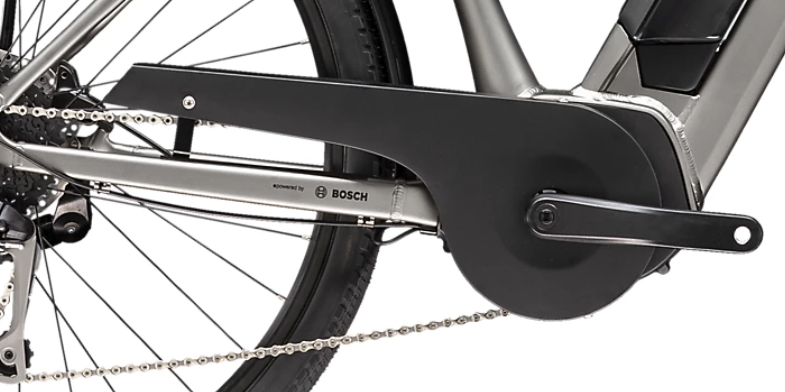

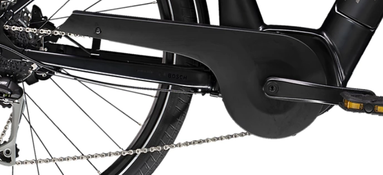

Trek Verve + 2 chain is constantly slipping.
Perhaps the Verve+ 3 has the fixes implemented from the start at the factory (i.e., correct chainring, chain guide, etc.) which have attributed to your positive experience?
From the pictures it appears the chain guard is the same (difficult to remove) design, which requires the crank arm to come off first:
Verve+ 2:
Verve+ 3:
