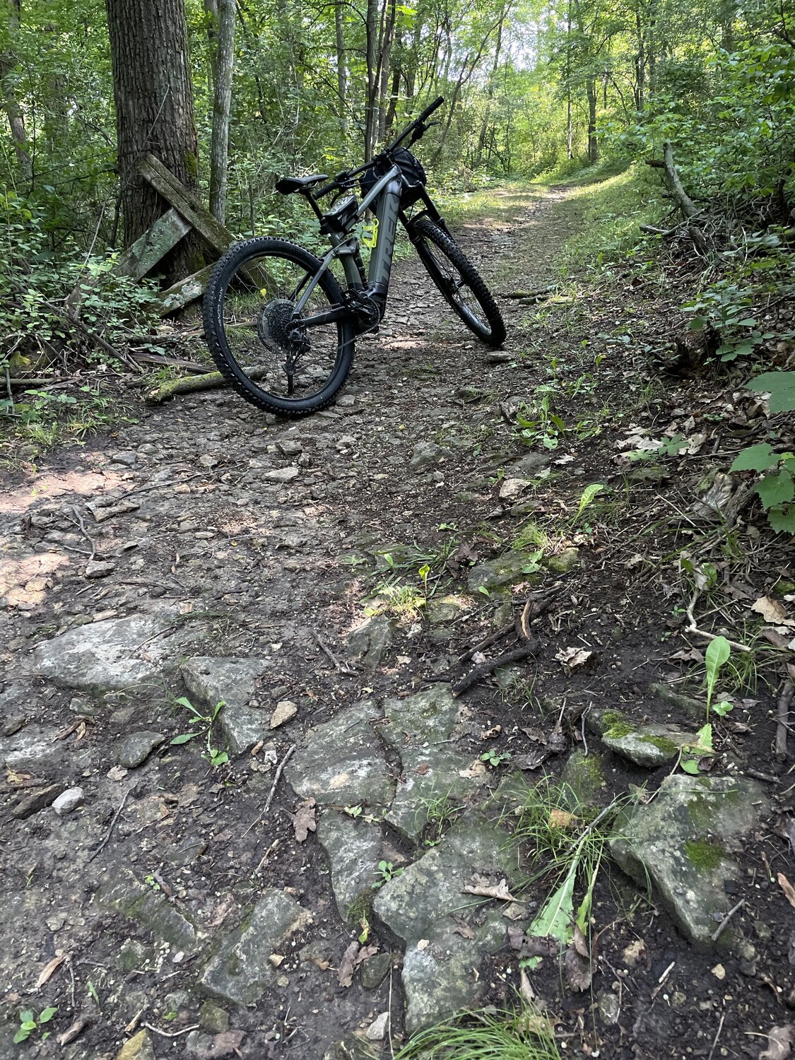

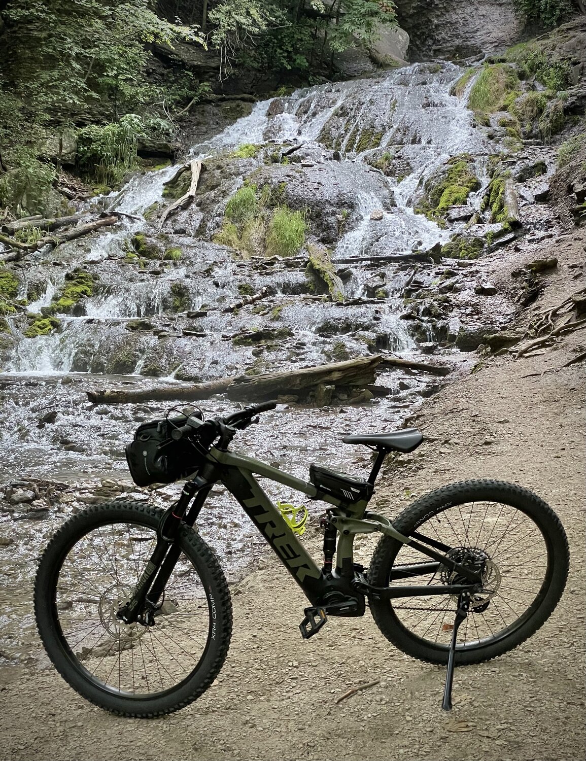

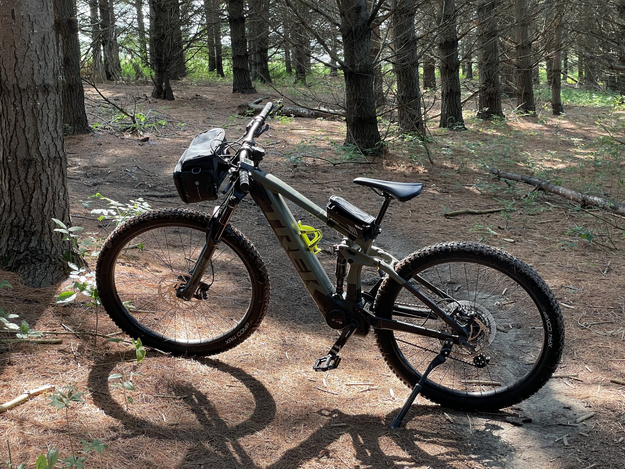

So I have a BIG handlebar bag I’ll use on easier trails but have two other bar bags in my quiver for most other Rail 5 rides. For the lightweight basics (cellphone, patches, levers, etc.) I’ve gone with a cheapo Wild Man bar bag. For longer crazier rides, some of you may recognize the Stash bar bag (that I bought for the Allant+7) that, surprisingly, is almost a perfect color match and fits perfectly!
