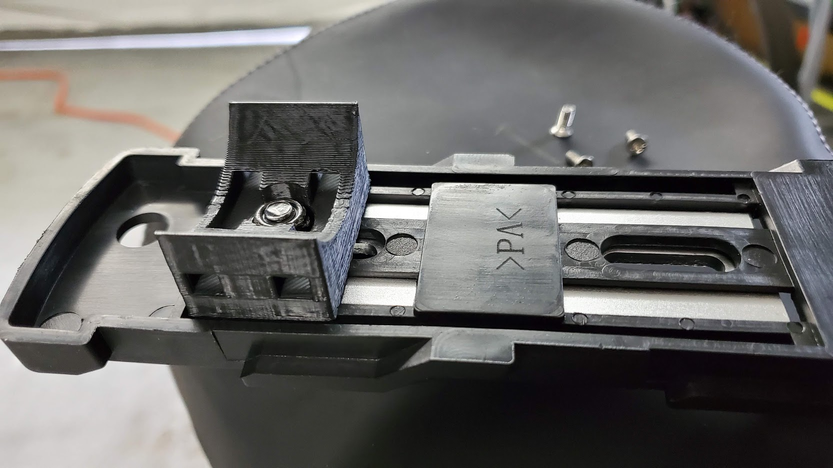

I thought about this, and would like to have at least one more hard point...but I am not sure the best way to do it, since the Townie's frame curves away from the battery where the normal mounting points are. May need to print an adapter of some sort.
Decided to design and print me an adapter to better hold the battery. Seems to work good, although I did get my angles a bit off, but I had no issues on a trail ride yesterday!
Well done on the bespoke battery cradle... just add a bit of rubber on the downtube to prevent slippage.
