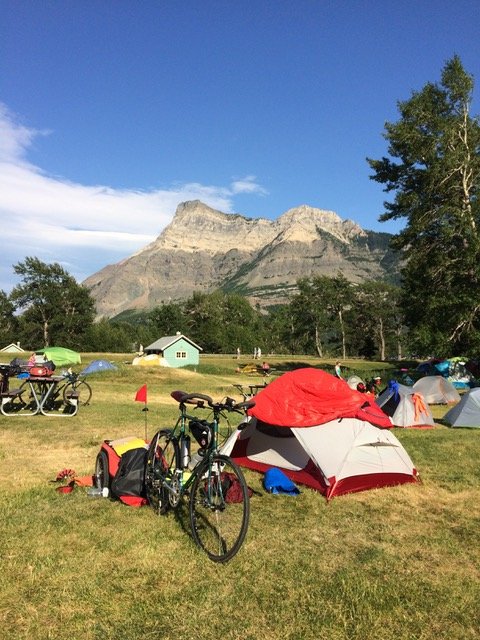

After a 870 mile small group ride through the Canadian Rockies on my 40 year old vintage Trek with my Radical Design trailer this summer I came to a couple realizations.
  • I love long distance cycling touring
  • I love camping
  • I can survive some pretty demanding physical challenges
  • The trailer is a great touring tool
  • The trailer can be a real liability when the shoulder disappears or is crumbling and scattered with debris
  • and lastly, if I want to continuing long distance touring I should get a properly outfitted modern bike.
After investigating and pricing the latest purpose built heavy duty touring bikes I also realize that being in my 60's, it was going to take a very long time to recoup my investment in a $7-10k for custom world touring bike.

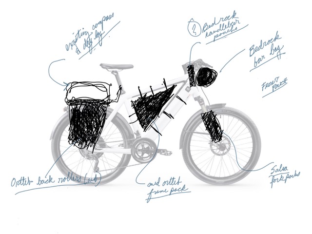

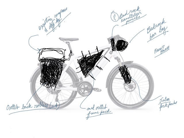

So I started to dream of what would happen if I got over some of the limitations of the Stromer and created an ebike/bike packing hybrid for long distance touring - thus this crazy concept was born. A makeover of my ST2 into a long distance road, rail to trail, and gravel road touring animal.
The main challenge was how to increase the balanced gear carrying capability and improve the tour ride qualities without permanently altering the ST2.
Here was the game plan...

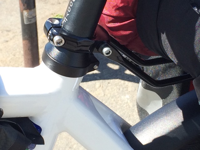

  • Replace the original rear rack with something strong and solid including reconfiguring the fender attachment
  • Bite the bullet and do the suspension fork upgrade i’d been lusting after for a long time
  • Upgrade to a Jones HBar handlebar
  • Add the appropriate storage capability
Each part of the plan has had its own challenges which I can go into details later, but here is where I've ended up. I did an initial first ride and it went fantastic. Everything stayed on the bike and it rode smooth and steady. The test ride was with placeholder gear so the next challenge was to see if I could pare down my gear for sustained self-supported touring. I'm feeling comfortable that it can be done, with most of the bigger challenges resolved.

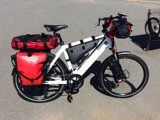

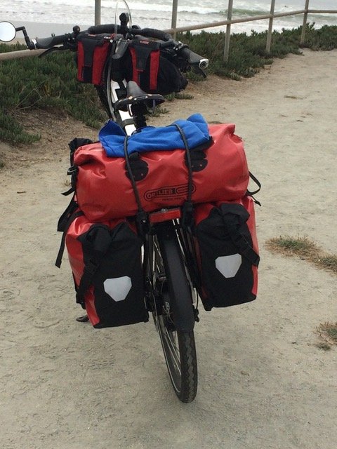

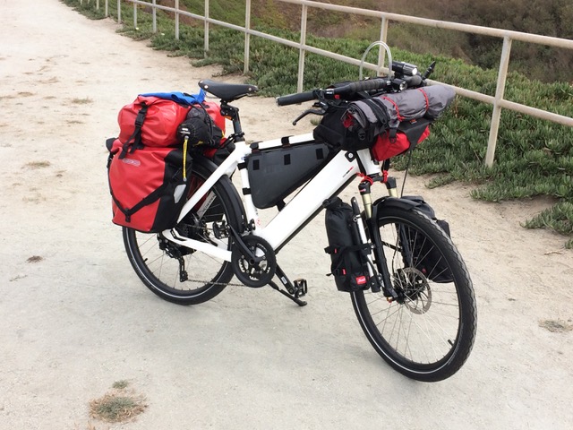

Initial test configuration

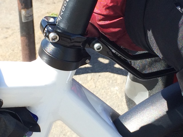

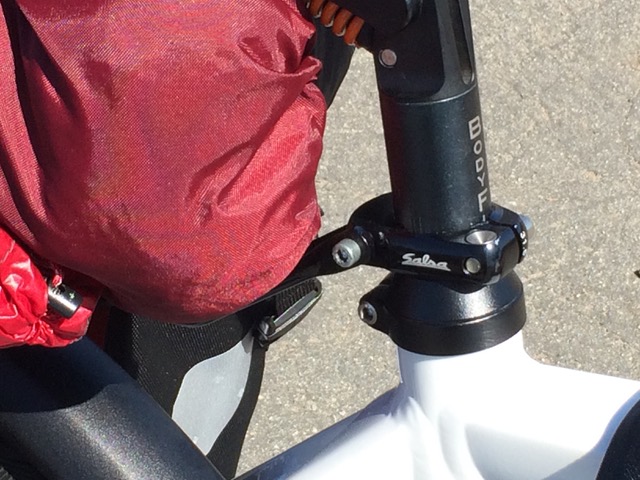

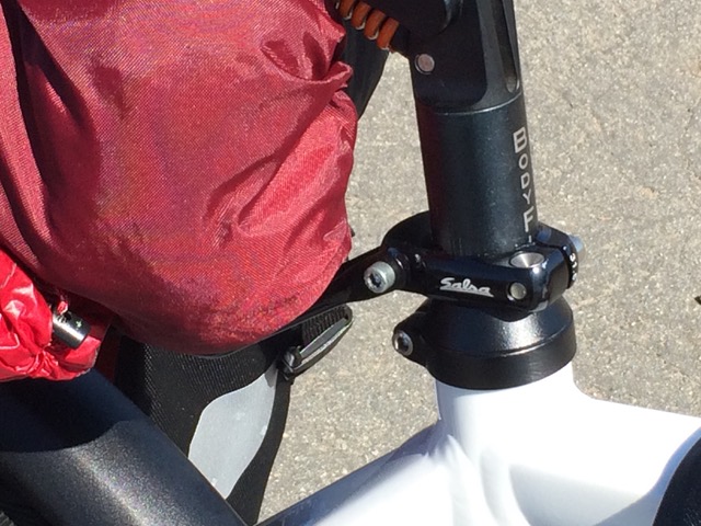

Salsa seat post rack adapter
Salsa seat tube bracket to Salsa bent stays to a Tubus Evo rack

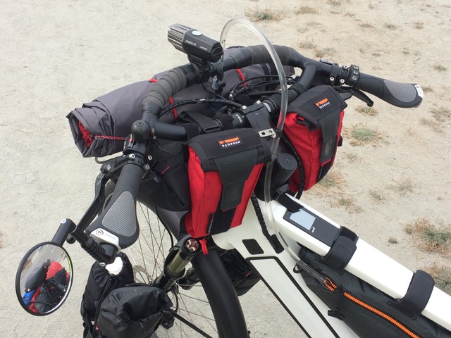

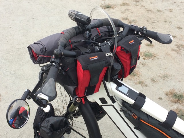

Jones HBars and quick access day storage bags from Bedrock
A little handcrafted mods to attach fender using original mounting hole and screw
After the initial test I've modified the hanging of the handlebar bags and been working through getting 3L of hydration (bladder in the frame bag). I also added a second set of bottom clips on the Ortlieb panniers, an idea I borrowed from their gravel panniers design, which makes the bags rock solid. The panniers hang off the lower rail on the Tubus rack which lowers the center of gravity and provides greater stability. I’ve also continued to experiment with various top bags for the rear rack, but ultimately ended up with an Ortlieb Rack Pack (small 24L) as the final solution. Its a configuration I saw being used by a couple of Hungarian tourers who were passing through town this summer in year 2 of a 3 year around the world adventure. The arrangement provides quick access to a food storage area, and yet with my down sleeping bag and down sweater it remains pretty light on top of the rack.
A couple of final mods I'm still considering include perhaps a 2 legged kickstand and maybe a slightly larger low gear on the cassette for added climbing comfort with or without lower assist levels.

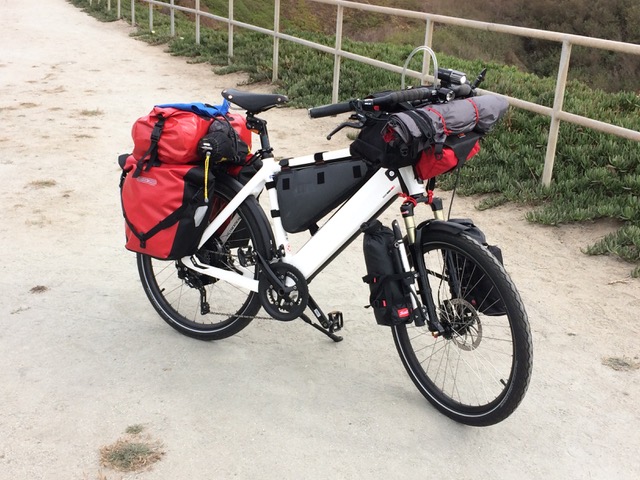

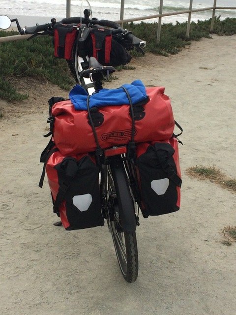

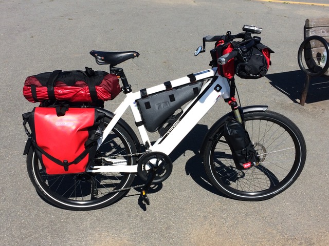

Current configuration on 3 day self contained touring test
I recently completed a test ride with my actual gear (about 97% finalized) and 2 days food supply to start to measure the impact of the mods and the gear weight on my range. My rides have mainly been in assist level 1 with some NO assist for several miles, and although the route was mostly flat city riding with a few small hills and only an occasional light headwind, initial results are suggesting a likely range of 60-80 mile per full charge. The ride I did in 2016 with the loaded trailer confirmed that an 80 mile day on a single charge was entirely doable, but this new rig represents a whole different wind profile so only time and more real world testing will tell.

2X10 setup on the ST2 is plenty gearing for most riding. I have realized that riding no-assist takes the joy out of ebikes and by riding in level 1, I not only cover more ground but have energy left to explore places (charge batteries meanwhile).
I think your current setup can be optimized to reduce some redundancy with some clever packing.
Have you thought about front loading panniers. It could reduce some of the clutter on your handlebar. old man mountain some interesting rigs that could be used.

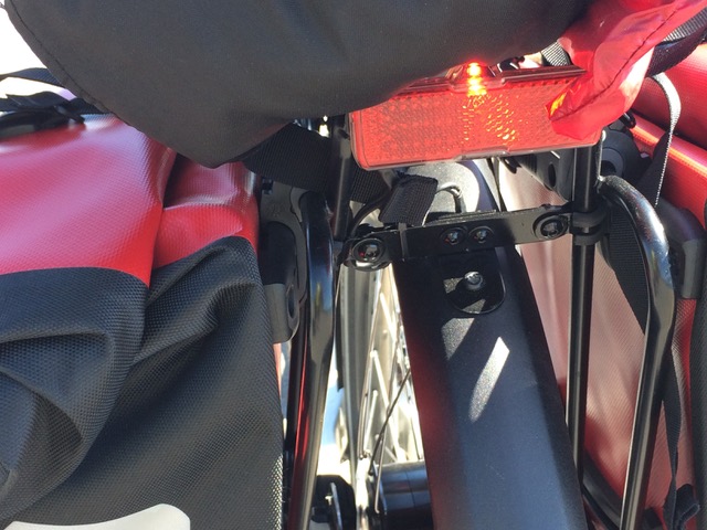

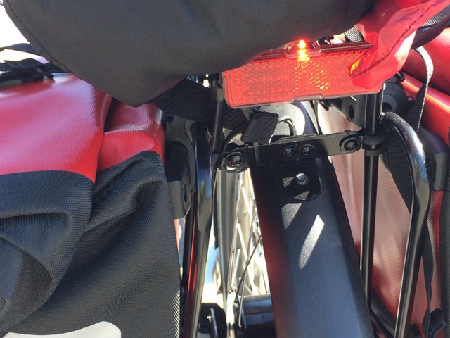

Could you post some shots of the rear rack mod without panniers attached on them?
Also, Canadian Rockies is the most beautiful place I have been to. It is simply cycling heaven.
Hi Ravi, here are a few photos of the rack sans panniers.
Regarding a front panniers option I looked at several possible solutions but I was concerned that some of them would put weight too far forward and higher up. The choice of the Bedrock pouches and the Salsa fork bags gave me both quick access to daily need items while keeping some of the gear lower and closer to the bike as well as allowing my gear to be nicely compartmentalized.

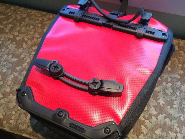

Great to see this. Re: rear rack—you nailed it. Did the same thing with the Salsa seat post collar and a really solid Racktime rack. Your addition of a second clip on each bag to hold panniers tightly is excellent too — I need to do that for sure as once in a while an unexpected pothole at a higher speed can lead to a pannier’s single clip coming loose. I like the Jones H Bar idea—I have one on my Salsa Fargo and it gives you lots of options. The big issue for me with my ST1 Platinum on Long rail trails is battery life. Even with three batteries (adds a lot of weight and they are hard on my Ortlieb panniers), and being sure not to run them down under 10%, I can only count on a range of 70-75 miles. You seem to get much further on yours. I always stay in hostels or motels or campgrounds with power. Looks like you have a Brooks Cambium sear with Body Float.
Last but not least I found a weird tire tube last year in case I ran into a blown tube in a remote spot—instead of being round, it’s long with two ends. It would allow you to remove your old tube and insert and feed the new tube without removing the rear wheel. Haven’t had to do it but think it would work.
So I know this is an old thread but I wanted to ask you about the Jones Loop H bar. I was considering picking up the 2.5" riser bars but I'm concerned about the cables not reaching far enough. Did you have to extend your cables? Also did you get the riser or standard bars?
Yes, both the derailleur cables and housings needed lengthening which was fairly simple as well as the rear hydraulic brake which was less simple and required fishing a new rear brake line through the bike. Also you'll have to be inventive as to how you attach the headlight to the Jones bar, I used zip ties which have held up well. The brake inhibitor and assist selector wires were just barely long enough after pulling a little of the excess wire out from inside the frame. I had the shop I bought the bike from do the upgrade for me at the same time I upgraded to the front suspension fork. Considering the added expense and work I would still do it again, I love the more relaxed position the Jones HBars provide.
John, thank you for your prompt response! Yes I was also concerned about the headlight. I thought it might work with the 2.5" riser bar. Did you mount it on the front loop? Not sure how much slack I have but the handlebars seem worth the hassles. I would definitely have my LBS do it for me.
Did you go with the 710 or 660 wide bar? My preference is the 660 but it's not in stock at the moment.
Yes, I mounted the headlight to the front loop which just barely has enough wire, although I think it would be fairly easy to splice in additional wire if necessary. I have Jones HBars on several bikes including my Stromer, in each case I started with the 710 width bars, then I used a simple small pipe cutter to measure 3x's and trim once. Shortening the ends of the bar by just 3/4" makes a big difference getting the bike through doorways.
