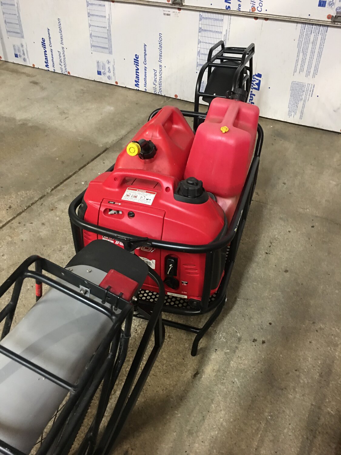

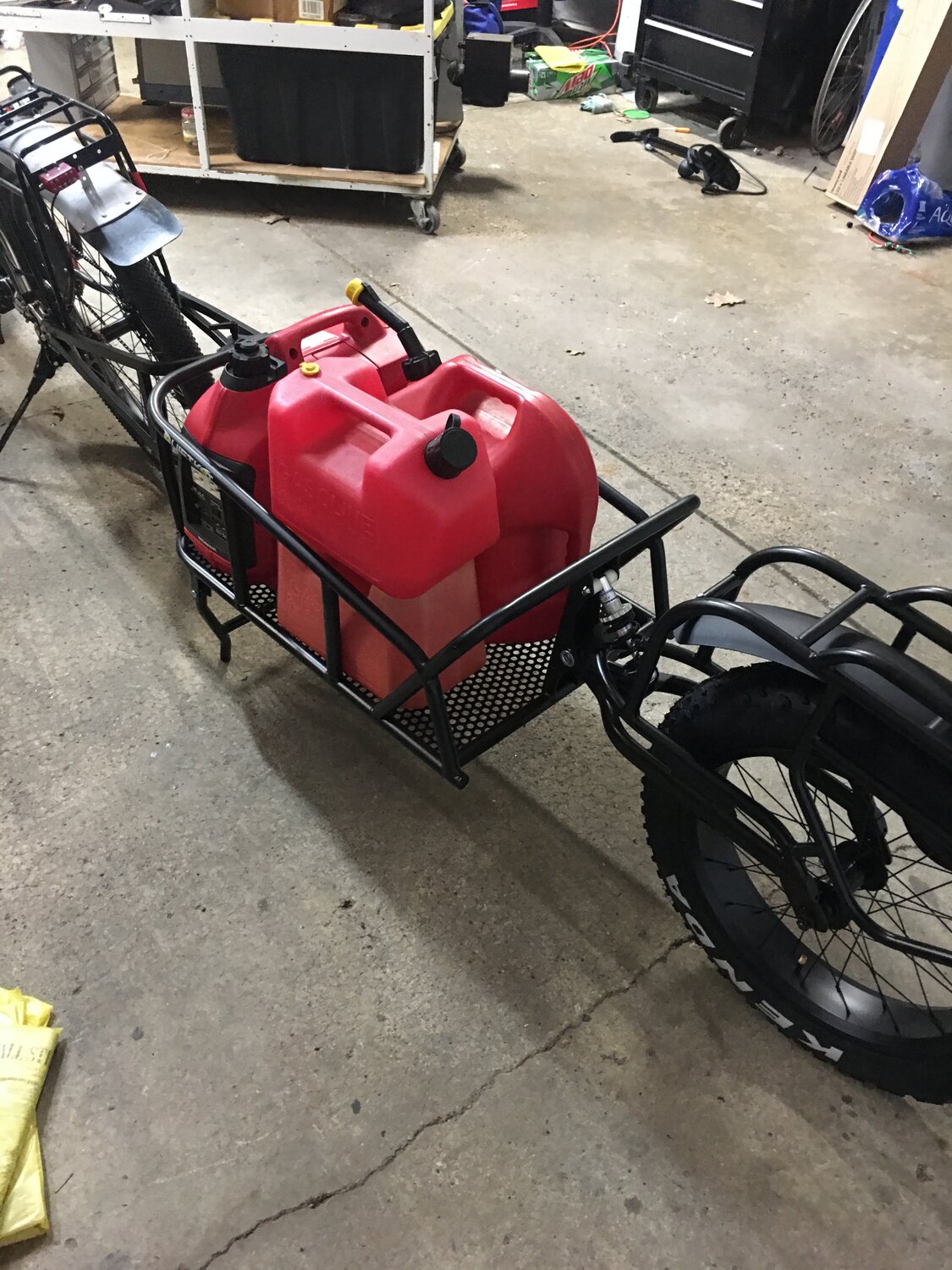

I have been setting up my bike for long distance remote off road touring and just could not fit everything onto my fat e bike so I ordered a fat wheel trailer from QuietKat. The advertised trailer bed was 14" X 24" and a rear pannier and top rack on the wheel. What I got was a trailer with a bed at 17"X27" and higher weight capacity. This thing uses a Bob Axle.
Get a load of this. Here is the trailer with my Honda EU100ie Generator with 10 gallons of gas. My battery size is 52 Volts 49 amp hours (2,540 watt hours). My Charger size is 15 amps and pulls a max of 900 watts, right at the max duty rating of the Honda 1000. As pictured, the trailer is at 80% capacity with the bike racks and the trailer racks totally empty. That is charging capacity for 65,000 watt hours. I could easily act as the charge sag wagon for a remote group self contained e bike ride. The Honda is quiet
The whole possibility is absolutely shocking to me.
View attachment 82248View attachment 82249
