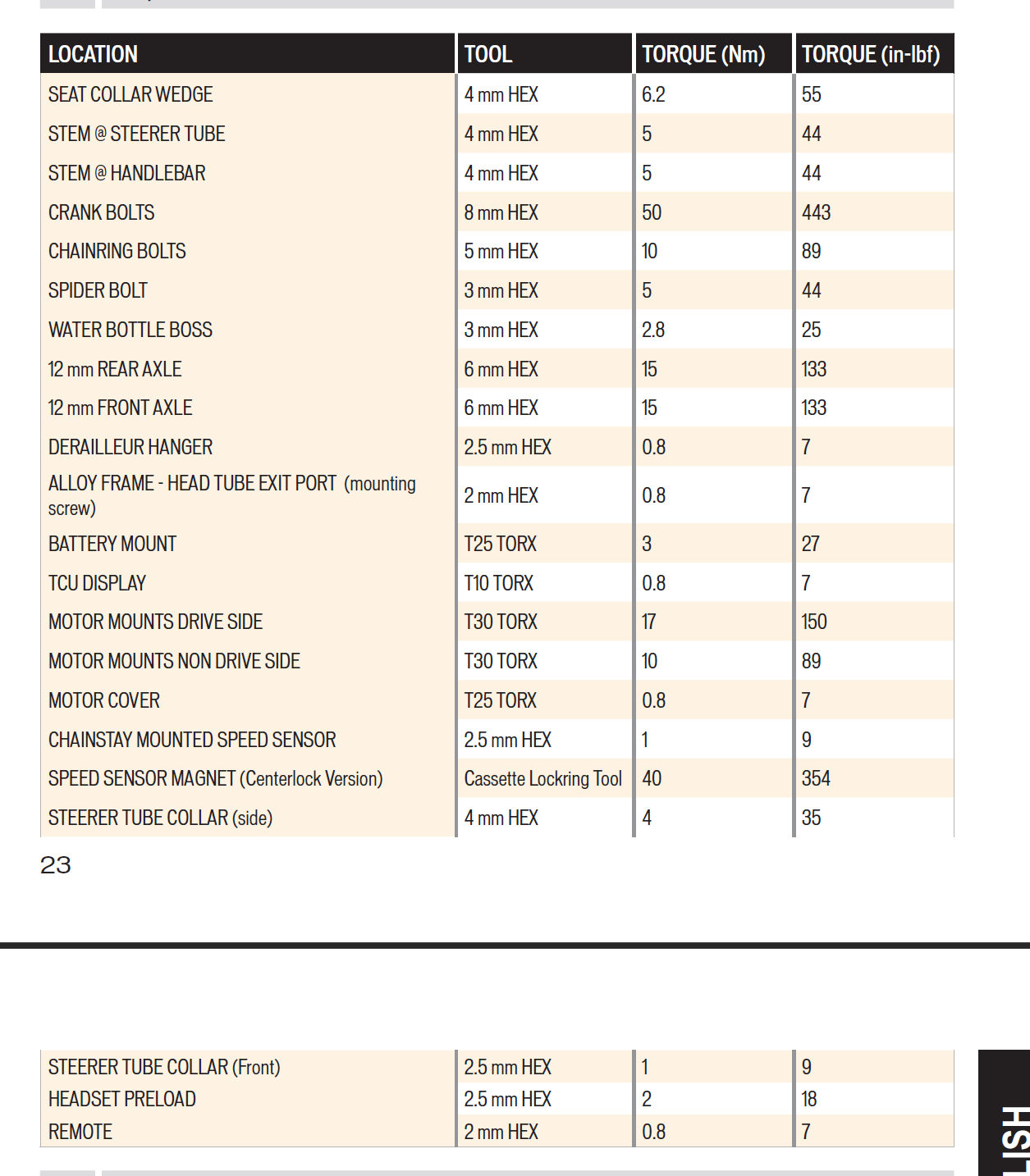

Nothing in the user manual, but does anyone happen to know what the torque settings for the through axles should be?
When I got my Sirrus Elite Carbon a few years back I had to e-mail Specialized, and was surprised that the torque setting for the hex key should be 15Nm. That's pretty tight!
The Vado uses a Torx key, and I'm wondering what the torque should be.
15nm

Guys: 10 Nm will do, trust me :) 12 Nm max. 15 Nm is an overkill.
