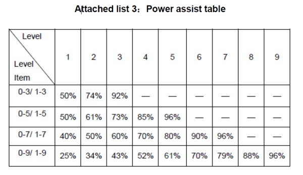

I also agree with what was said above - Many bikes can be programmed at their display for a total of 3, 5 or 9 levels of pedal assist. Many ask (I did at first) "why would I want to have to cycle through and choose from 9 different levels?" The answer to me: To have more discrete control of a hub motored bike with cadence sensor.
Yep, that's one of the things I really like about the Ride1UP that I posted the chart for up above, plus being able to modify each assist level to a custom setting is very nice as well. I wish this was more common in e-bikes.
