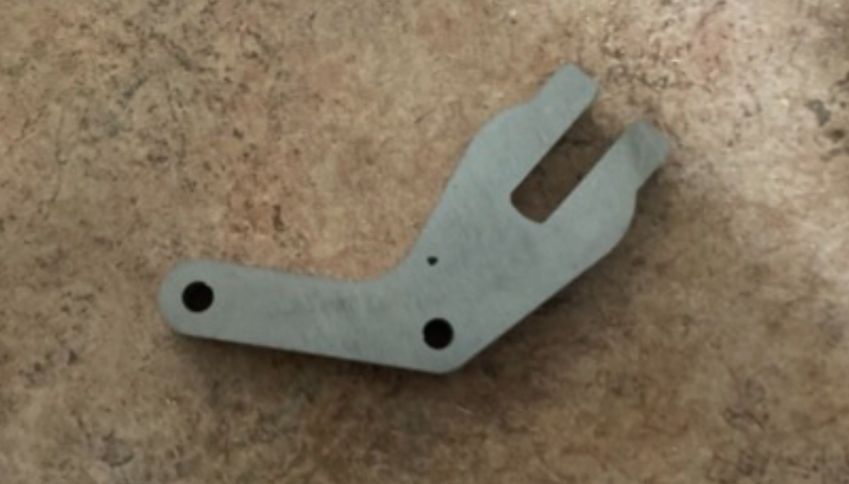

Unlike my commie nemesis, I am willing to spend the money. I have several custom CNC torque arms. I’ll post some photos later today.

Finally found the photo. It’s in the parts pile somewhere. I’m hiring a young fellow to help me sort and finally have an online eBike parts rummage sale. Here’s the beast torque arm. Over 1/4 thick.

These are accessible. I get your point, however, who doesn't have access to a custom CNC? I have had a few projects done and found already developed designs and their CNC (forgot the extension) files. I gave my printer to a kid and use a number of online resources instead of doing my own prints. endless_sphere has a number of designs still available. The beast came from a fellow there.
