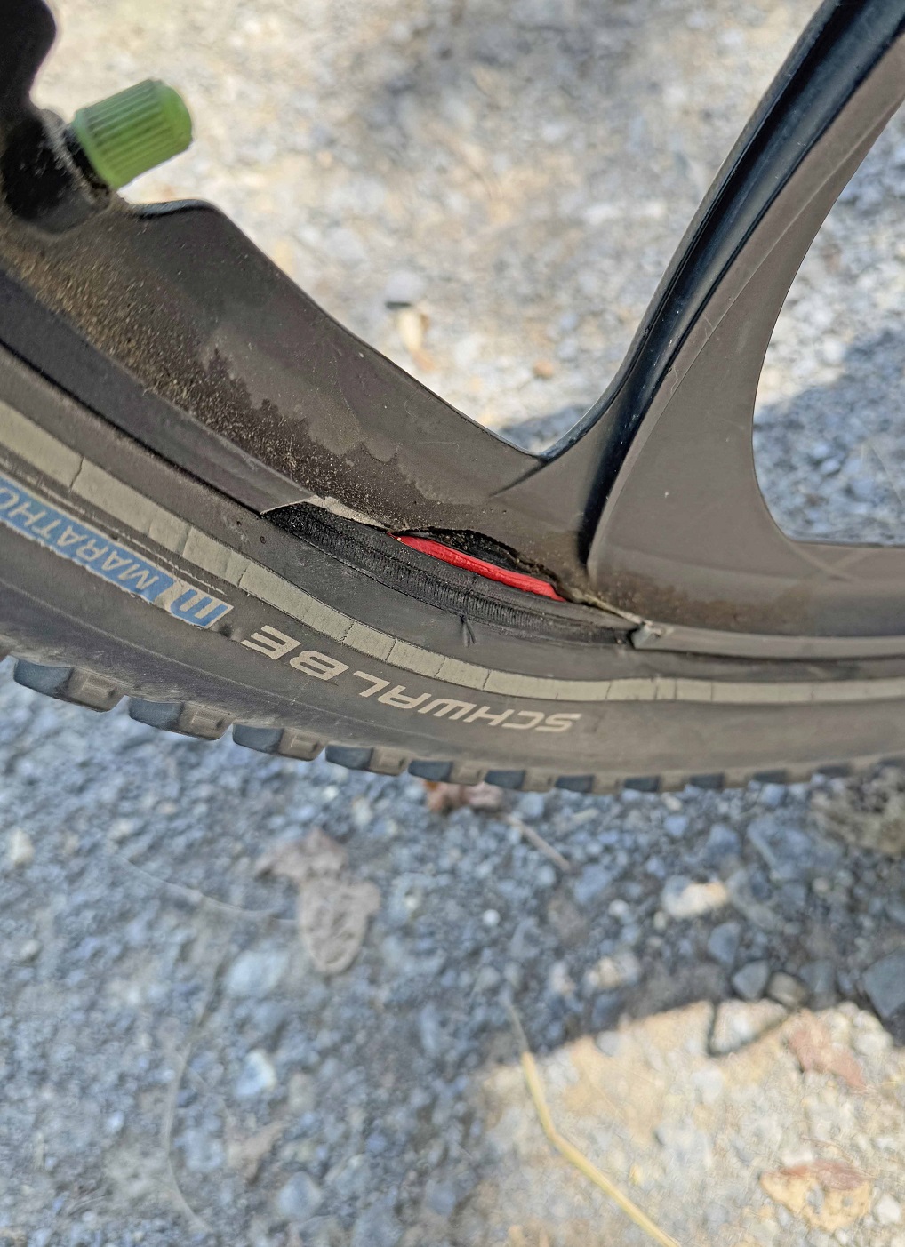

Yeah, I hate to give up on the Tannus. 5 seasons, two bikes and 15K miles without a flat. It did save my bacon recently when I hit a rock and broke a chunk out of my mag wheel rim. If it weren't for the stiff sidewall on the Tannus Armor, the tube would have blown out.
Not sure why I wasn't able to get the Tannus on this time. It was the same bike, same tire, same rim, same size tube and the same size Tannus. I've installed four of them before, have the tools and know most of the tricks. I used an excessive amount of force trying to seat the tire bead this time. I was afraid I was going to snap the bead wire or damage the rim. It was like trying to install a 24" tire on a 26" rim.
