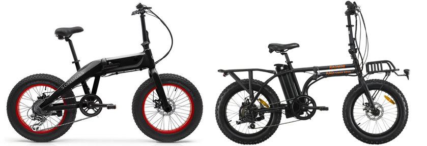

Anyway, I wanted to get some opinions on the Sondors Fold X vs the Rad Mini.
Regarding the pricing, the Fold X with the Shimano gear option is $1,123 shipped vs $1,499 for the Rad Mini.
The Rad Mini has front and rear racks, and a 750 watt motor, but a smaller battery. It's also 62 pounds, whereas the Fold X is 50 pounds.
Those seem like the main technical differences. It's kind of hard to choose between the 2 by just browsing. I wish I could try them both in person.
Anybody know how the performance will differ between the 2, given the fact that the Rad Mini has a motor with 250 watts more power, but is 12 pounds heavier?
Since I have a spinal cord injury, and would likely have to use the throttle to get up to speed before trying to pedal, I'm wondering if those 250 watts of additional power would be what I want, especially on hills. Both are 7 speeds though.
Are there any other folding e-bikes with fat tires that would compete with the Sondors Fold X and Rad Mini?
In terms of tackling any kind of terrain, fat tires are what you want for that, correct?
Let me know what you think, thanks.

I was chatting with someone at the Sondors Facebook group, and he said, "The motor isn't what determines the power. The battery voltage and controller do. The Fold X is 48V (battery) x 15A (controller) = 720 watts stock. The Rad mini also uses a 48V battery but no mention of the controller amperage. Since they say it's limited to 20mph, it's probably a 10A or 15A controller which is the same or less than the Sondors..You should ask them what the controller output is. The Rad also has less capacity/range than the Sondors Fold X. The Sondors is 14Ah versus 11.6Ah for the Rad Mini. That's 20% more range for the Sondors. We also know that we can remove the speed limiter on the Sondors, AND add at least 30% more power at a cost of less than $60 (a 20A controller will give you 960W of power). As a bonus you would pay $600 more for the Rad Mini with less range and less power. Your decision though"
And I asked him why manufacturers mention the motor wattage, and he said,
"Because it's sexy and easy
We've had folks running the stock 350w motor in the fat bikes at over 1000W by upgrading the controller and battery. The Bafang motors will handle way more power than their rating. My guess is that the 500W motor will handle 1200W of power just fine. We've had some members swap their 350W motors for 750W motors because they went from 36V to 52V and put in 35A controllers. Those monsters are doing 1800W. The motor wattage is pretty much a rating, not an output. A 500W motor will handle more power than a 350W motor, for example. But it's not the motor determining the power."
Is this info true? I assume he's correct. I'll send Rad an email to see what the Mini's controller output is.
One thing I don't like about the Rad Mini is that the battery is smaller, and if I wanted a spare it'd be $500! Anybody know about how much a spare battery would be for the Fold X?
Also, if I buy the Fold X, I want to purchase the Shimano gear option, right?
Thanks.
Edit: So I saw this at the Rad Mini's tech specs page: CONTROLLER: 48V 12 Amps Continuous (22 Amps Peak). Does this mean the Fold X has a better stock controller? Nevermind, apparently the Rad Mini has the better stock controller.
