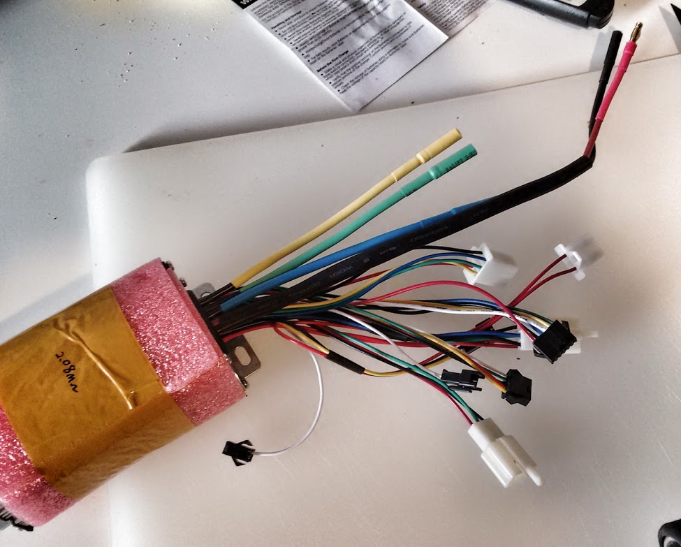

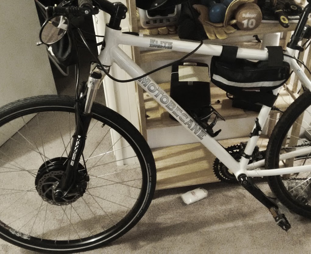

I got my MAC front hub motor (350w) from EM3ev. So far, very glad I went down this road. The goods were all packed in heavy shrink, inside the wheel. Bottom of box was just torn and open, but nothing fell out. Everything could have fallen out, I guess. That would have been disappointing.
The wiring is rather amazing. It's looks impossible, but actually is almost idiot proof. So far I like the front motor because 1) it is soooo easy to get the wheel on. My experience with rear hubs was dismal 2) all the wiring runs will be short, mostly up the fork, back a bit to the battery 3) I like the looks - minimalist.
I got a schematic of the wheel off the website, but my tolerance between the caliper and hub motor is just about nothing. So I need to get the spacer. The screws holding the rotor on the old wheel were blue Loc-tited, and would barely budge. Threee required a hammer and chisel.
I don't consider the Elite Adventure (stupid name) a performance bike, so I'd be happy at 20 mph. See what it does in a few days. I figure after doing this kit, I will be the repairman for most stuff. Nothing like a ton of hands on. The Marathon Plus tires went on with no gloves or tools. My kind of tire. Looking forward to that first flat out on the road. :D Elite for EBR.jpg MAC for EBR.jpg

Congratulations George! I have extra spacers from my purchase if you need any. Also, does the caliper clear the hub motor? If not you can buy a caliper that is narrower and it works, I had to do that with my rear hub installation. The wiring is pretty straight forward and if you bought an Infineon the hall sensor wires out of the motor will probably coincide with the colors coming out motor and the power leads will too. The white wire is the thermal sensor output.
Which winding did you buy....xT...4T, 6T????? I think the Elite is a solid performer, but not a performance bike. I ride it pretty regularly at about 23 mph.

Thanks for posting what you have. You made the MAC sound very good, and it wasn't that much more than basic front hubs. I went with the default, which is the 14T winding. Paul lists the 14T as 2 mph faster. I mostly fight wind, not hills.
I don't know if you still have those stock Tektros. The hub sticks out to exactly where the inside (hub side) of the caliper housing sets. There's about 4mm of adjustment, toward and away from the motor, on the caliper mount. So I hope with a 2mm spacer I can adjust the caliper out that far. I got the spacer off Ebay and he said it would be here tomorrow. Looks like rain for the weekend.
I might have to go with the thin caliper. There was something called an Alhonga in a thread on Endless Sphere. It looks very thin. Brand is unknown to me.
The Elite is an interesting bike. After 20 months, it seems like a solid frame. I think it is great value compared to the stuff you see around $700. I've ridden it at 25-30mph, down hills, and it's not as stable as my Prodeco X3. But I plan to do the wiring so I can break the Elite down and transport it without a rack.
Gotta say, you guys who are doing the kits and setting things up right seem to be having really good luck over the long haul, even with serious miles. I'm hoping I can fix anything on this bike, and Paul sells a lot of parts for the motor.

Hi George...that is the correct caliper. I needed it to clear the rear hub and it works as good as the stock Tetro supplied. As far as the wiring, if your chart says it's to enable regenerative braking then your hub is wired differently then mine. Stick with the chart, and/or confirm the wire connections with Paul. I found him helpful and very responsive to all my questions.
If hills are of no concern, I'm pretty sure you'll be impressed with the motor. I opted for the Grin 3 position aux switch to control my motor and position #2 is set-up to output 350W which happens to be the setting I use the most. At 350W output the 500W rear hub runs comfortably on the flat with easy cadence (not to strenuous) 24+ MPH. At 500W I run about 26-27 mph which feels a tad uncomfortable on the cow paths they call state roads in New Hampshire.
