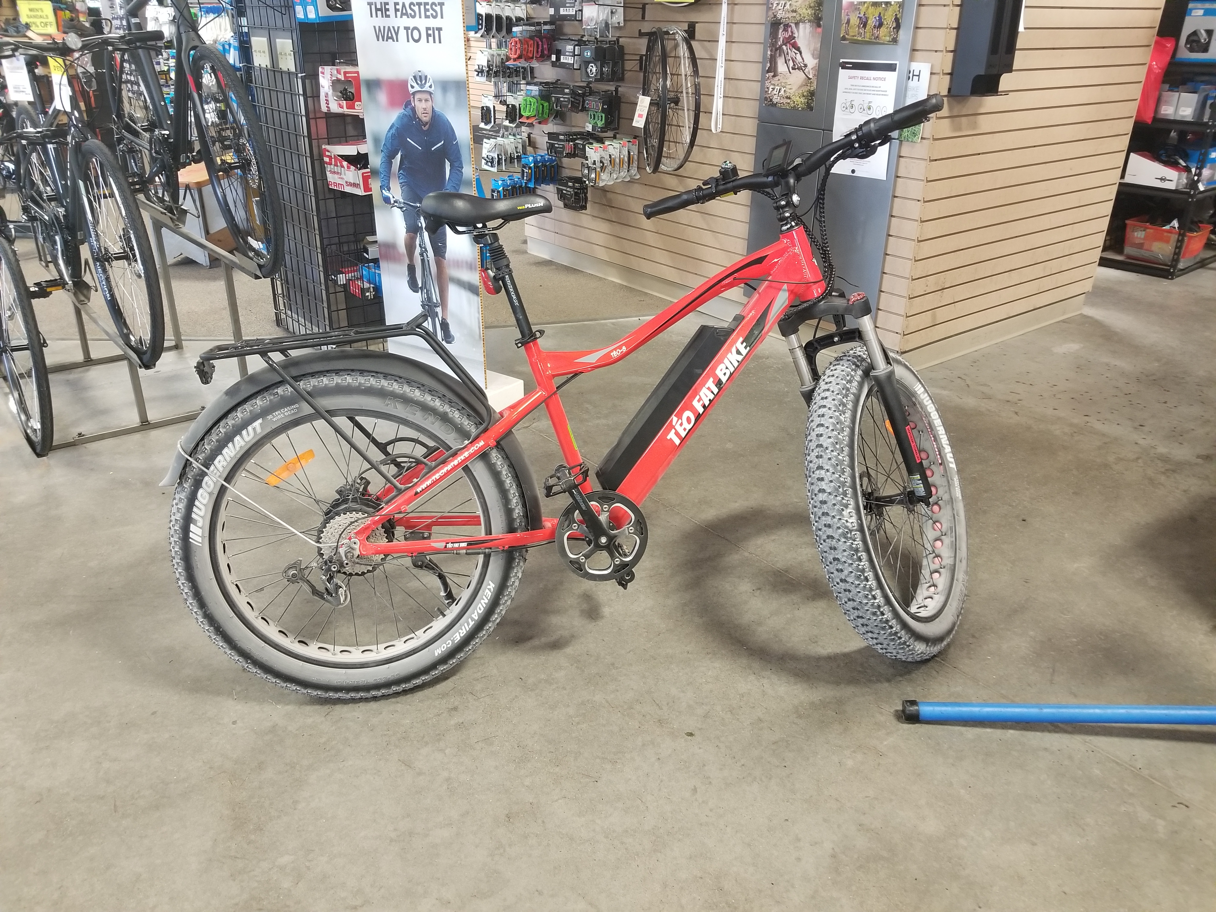

I picked up my shiny red Téo Limited, Size L earlier this week and thought I'd share my initial impressions.

My impression in seeing the fully assembled bike was, "wow, this is huge!" For someone my size, this is a very welcome feeling. The quick-release seatpost is a great touch, because you just know that you're going to have to let all of your buddies try this thing, so the seat will be bobbing up and down as everyone takes a turn. The leather (pleather?) handlebar grips are very attractive and offer a nice balance of comfort versus 'grippiness'.
Overall, I'm extremely impressed with the quality of components Téo has selected. I had expected to replace the grips, pedals and saddle immediately, but in the end decided to keep all of these, as the performance and comfort provided by the original components is more than adequate. The tires, cable-managent, paint/finish and suspension forks are all superior to what I would've expected for this price point. Great job, Téo!

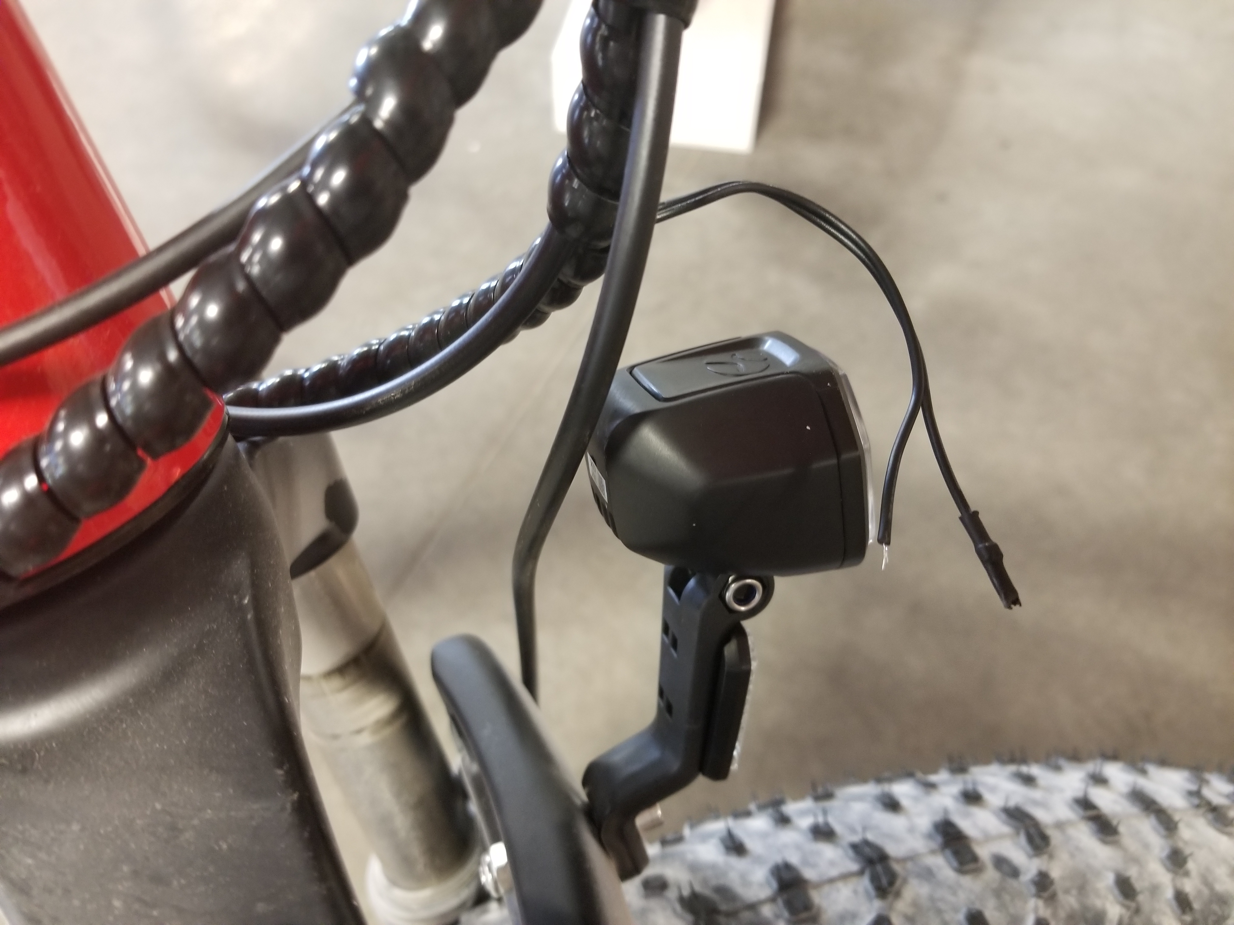

  • Front light wires are very susceptible to damage. After my chain broke (see above), the pedals moved on their own as I was walking it, activating the pedal assist and driving the bike out of my hands and into the brush. (Forgot to disable pedal assist.) The handlebars twisted all the way around in the very gentle collision and snapped the wires at the point where they attach to the light. (See photo.) Would like to have it fixed but my LBS didn't know how to and I'm the polar opposite of handy, so I guess I'll just go with a standalone light for now. I'm pretty sure this would just happen again were I to repair it.

As far as the wires being too short at the front light I agree, same thing happened to mine while I was assembling it and reached out to get a wrench and the front wheel turned all the way to the right and the wires snapped off inside the light, had to get needle nose players to get those pesky little connectors out and solder the wires to them, put some heat shrink tubing and I pulled some wire out from the spilt coil plastic that holds everything together, be very gentle for these wires are not the best for pulling on them. Hope that helps.

Something like this should help to raise your handlebars. MEC also has longer adjustable stems that could be tilted up for a little more height. https://www.mec.ca/en/product/5042-662/Alloy-Stem-Raiser
Nice! So just a matter of splicing the wires to the correct leads? Interesting that it emphasizes heat dissipation--I didn't think LEDs produced any significant heat.
You got it, look closely at the oem wire for polarity or just use a volt-meter to get it connected correctly if you decide to go that route.
Make sure your power is off when connecting a new light.
At 24Watts in such a small package over time the heat does build up, you can`t fry an egg but it gets worm.
