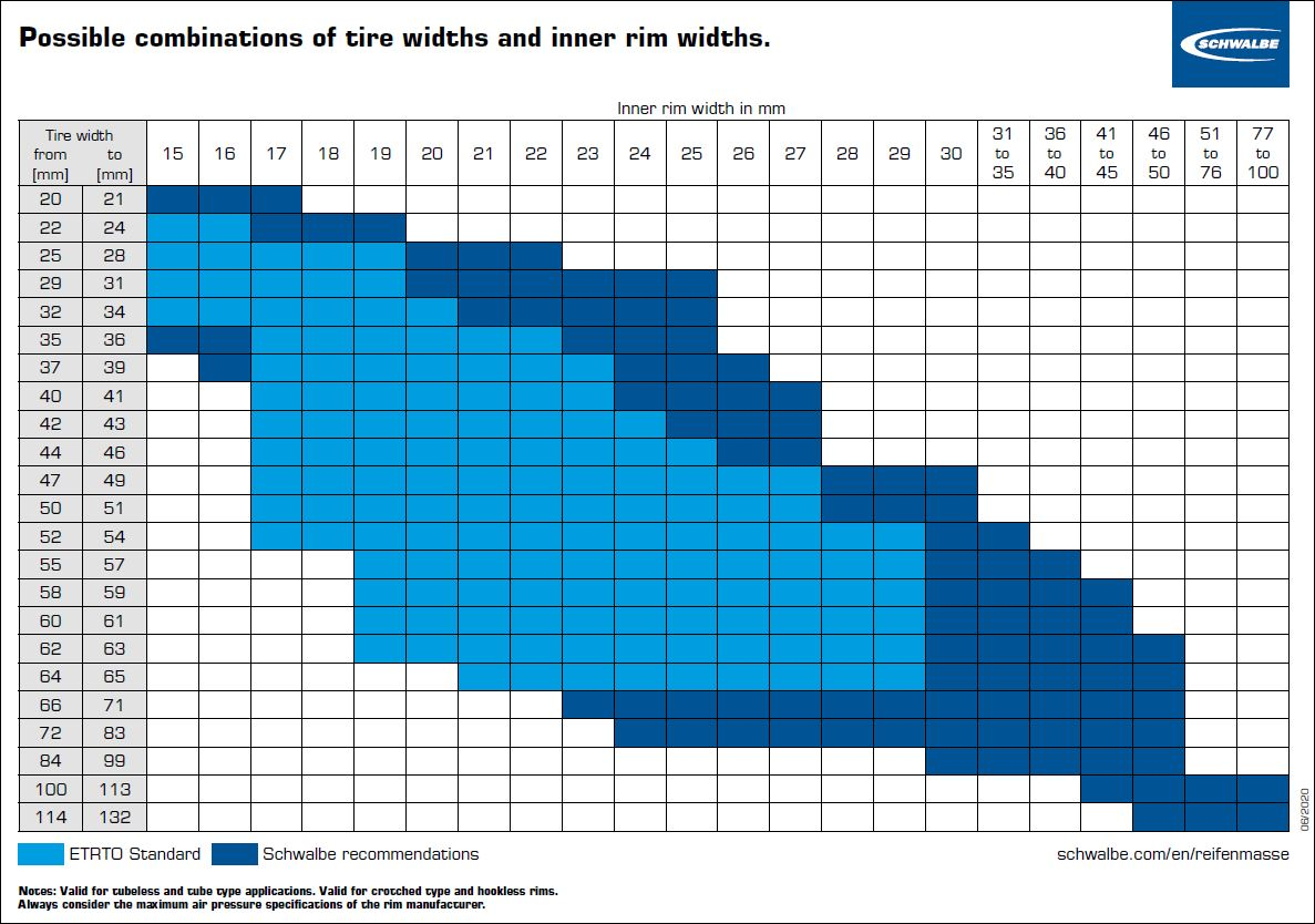

Nice Bulls E2 Street! Here is a handy tire and rim fitment chart from Schwalbe.
The Big Ben Plus has the same tread pattern as the SuperMoto and is an excellent tire.
With an 18mm rim width you can run a tire up to 52-54mm wide = 2.15" inch tire width.
With a 18mm rim width you can run a tire up to 52-54mm wide = 2.15" inch tire width.

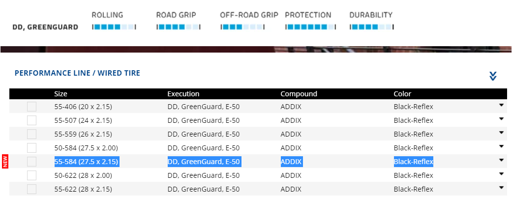

Thanks Flat6! Weird - The page I visit doesn't show that size (see below). If I can actually get it, I'll probably just go with BB+ at 2.15"! :)

Yes, take a look at the new website... it lists the new 27.5 x 2.15" size that is a perfect fit for your wife.

Ah - Bingo - I see now I was on a different/old site. Well that's confusing!
The North American distribution center still doesn't carry the tire in 2.15" size and the website you linked to is their US-specific site.
The site @FlatSix911 is referring to is their international site and I don't think they will have it in stock until March 2021.

Sorry to thread jack - I thought it might be better to extend this discussion rather than start a new one. I have a mountain bike fitted with Schwalbe Marathon Plus 26 x 1.35 tyres with greenguard fitted to my MTB. I really like them but I converted the bike to electric and I'm finding the ride to be quite hard. I'm also looking at the Super Moto X but the guide you posted would suggest my rim would be too narrow? Otherwise, I could go with the same tyres at 2 inches (5cm) - this would fit my 53mm wide mudguards almost perfectly and not look like a kid whose mum bought them clothes that are too big. I'm just a bit worried as the guide has a massive drop in compatibility between 16mm and 17mm inner width and mine is somewhere in between - this is measured at the lip where the metal folds in. Super Moto X probably not gonna work, but reckon 5cm wide Marathons would fit?

Based on your rim measurement of 16.75mm you should be fine with a maximum tire width of 52-54 mm... so 26 x 2.0" tires are good to go.
Keep in mind that the Schwalbe chart has a built-in safety margin and that a 17mm road rim was considered wide just a few years ago.
I have a set of the Schwalbe Big Ben Plus 28 x 2" tires on my Bianchi road bike and they work very well with the stock 17mm rims. ;)
