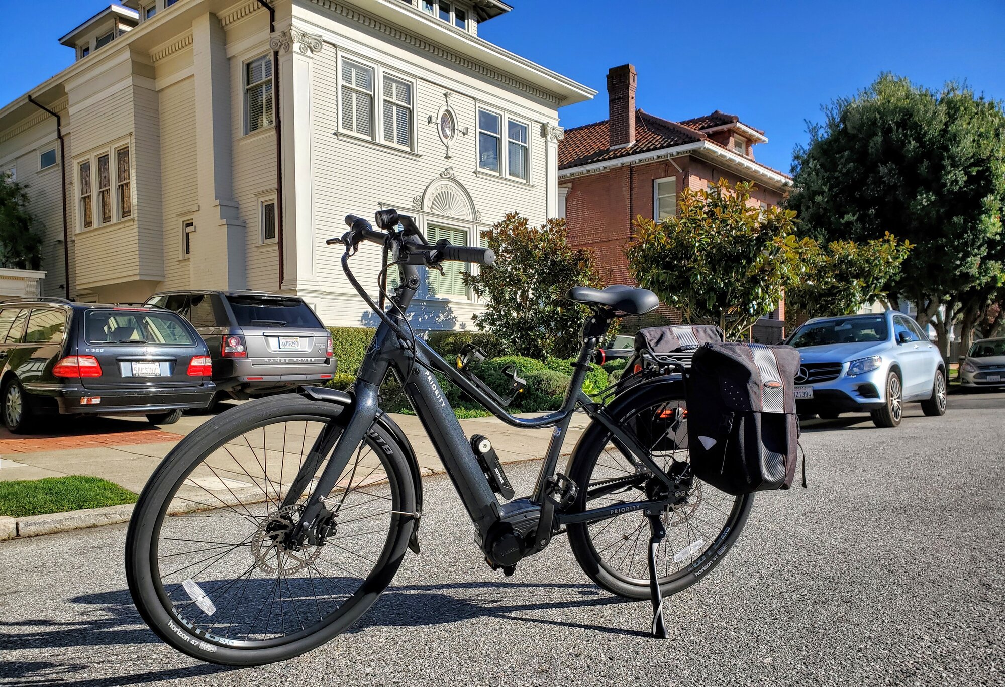

As usual, a picture to make up for the long post. This is the bike in grocery getter mode.
