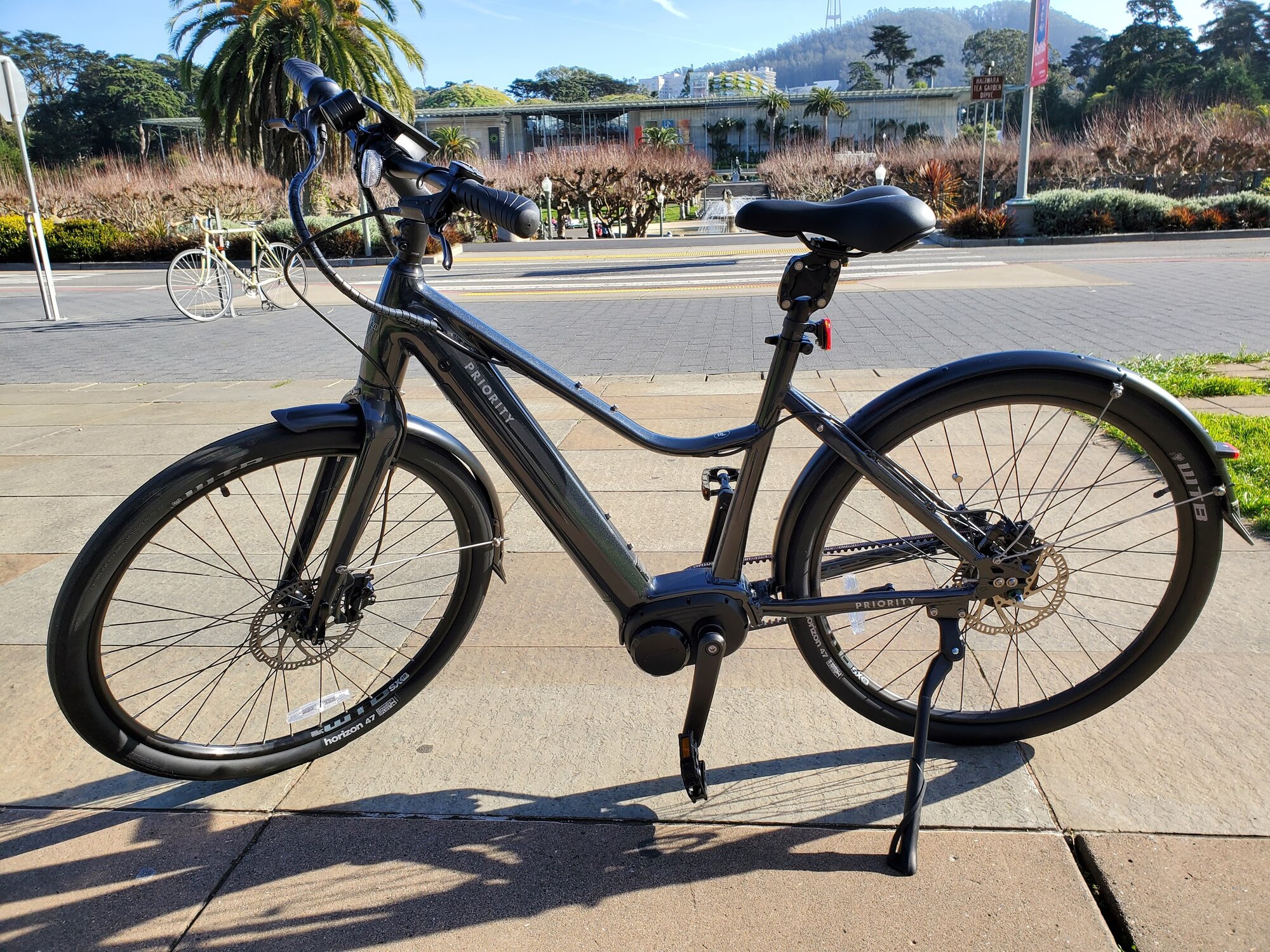

To me, the bike looks great. I got lots of curious questions and comments during that day. The paint is nice and glossy, integrated battery makes it more stealthy, integrated lights are nice to have, the plump tires give it a nice look. The mid step frame wasn't my favorite at first, but it makes the bike very versatile - people of different heights can use it well. While attaching the holder for my lock, I accidentally ended up chipping the paint on the underside of the top tube. I was disappointed how easy it chipped, but happy they also included touch up paint. Since it's not visible from any angle, I think I'll leave it like that to save the touch up pain for more serious occasions.

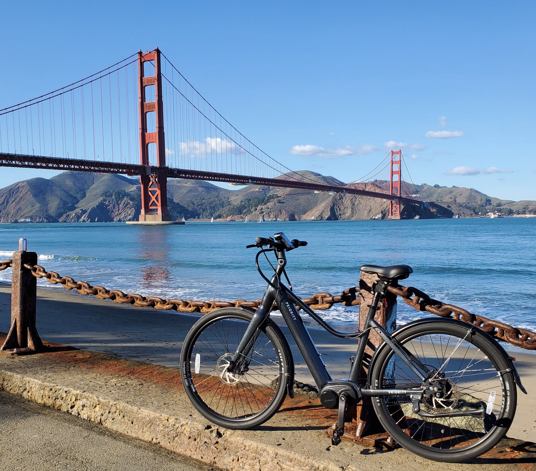

The effort to maintain 28mph depends heavily on terrain/wind. I finally found the best place to test the bike's top speed for longer periods of time - a bike track in a park. There, I didn't have to worry about pedestrians/animals and could set it to gear 5 and PAS 5 to see how it looked like. As I mentioned before, I could reach/maintain 28mph while spinning the pedals in the 95-100 RPM range. It is definitely a fast pace, but felt comfortable most of the time. The speed felt like an appropriate reward for the amount of effort made. However, different scenarios led to vastly different experiences. Even in the track, when going against the wind I had a hard time breaking 25mph. Going the other way was, literally, a breeze. Similarly, on slight downhills it was very easy to reach 28 mph, while in slight uphills, I seemed to be stuck around 24-25mph.

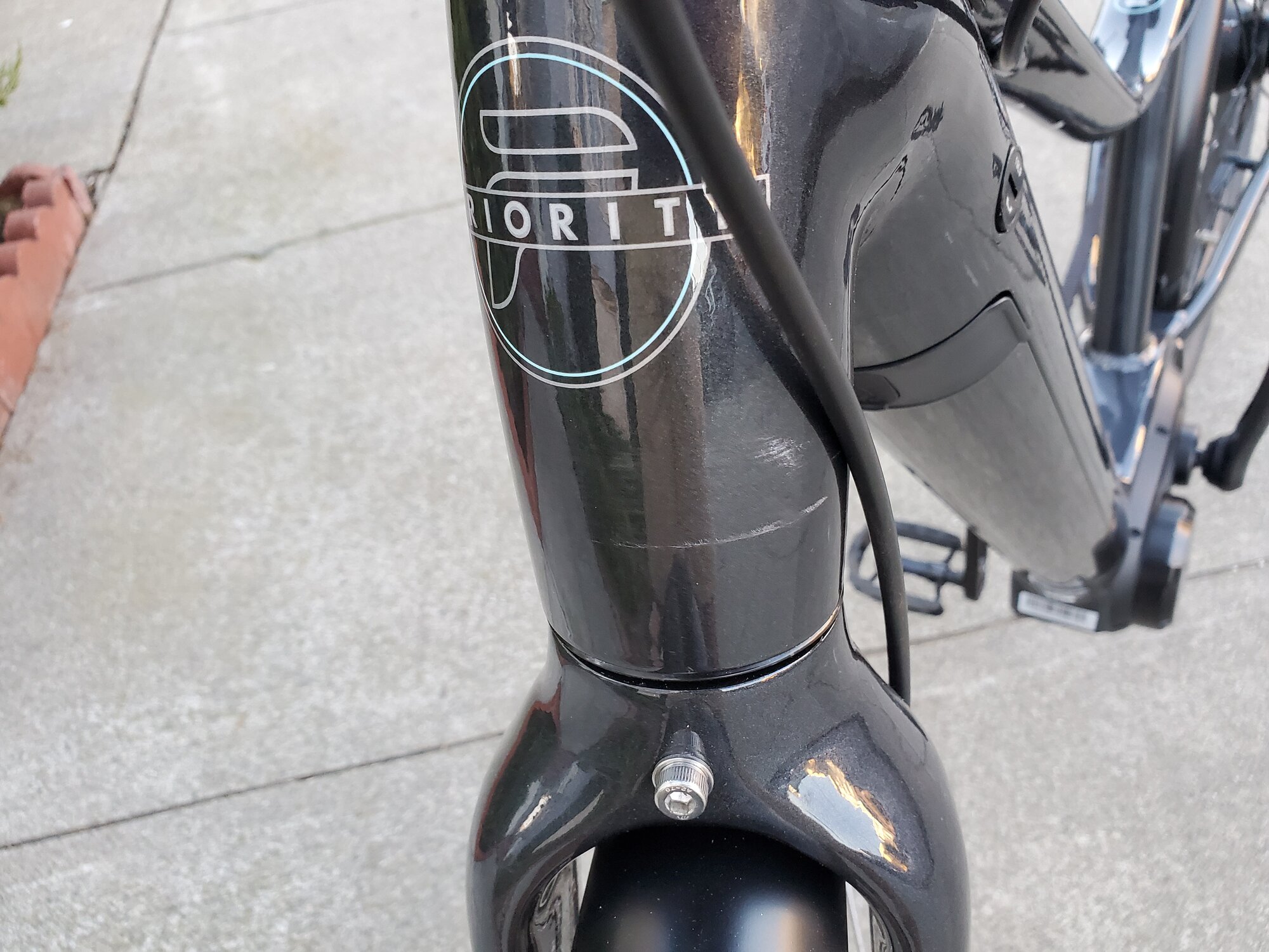

The brake cable is scratching the front of the bike. This is a silly comment, but just something that I happened to realize. Last week I noticed some scratching on the front of the bike. I didn't immediately realize what it was. I was a bit disappointed in myself for having scratched the bike this early in my ownership, but didn't know what it could have happened. Later, I noticed it was getting worse - then, it dawned on me. With the way the front brake cable is clipped to the side of the bike, it rubs against the frame as I turn. I didn't know it could do such damage! As a solution, I will add some clear tape to protect the high contact area.

Bonus photo from said ride:
