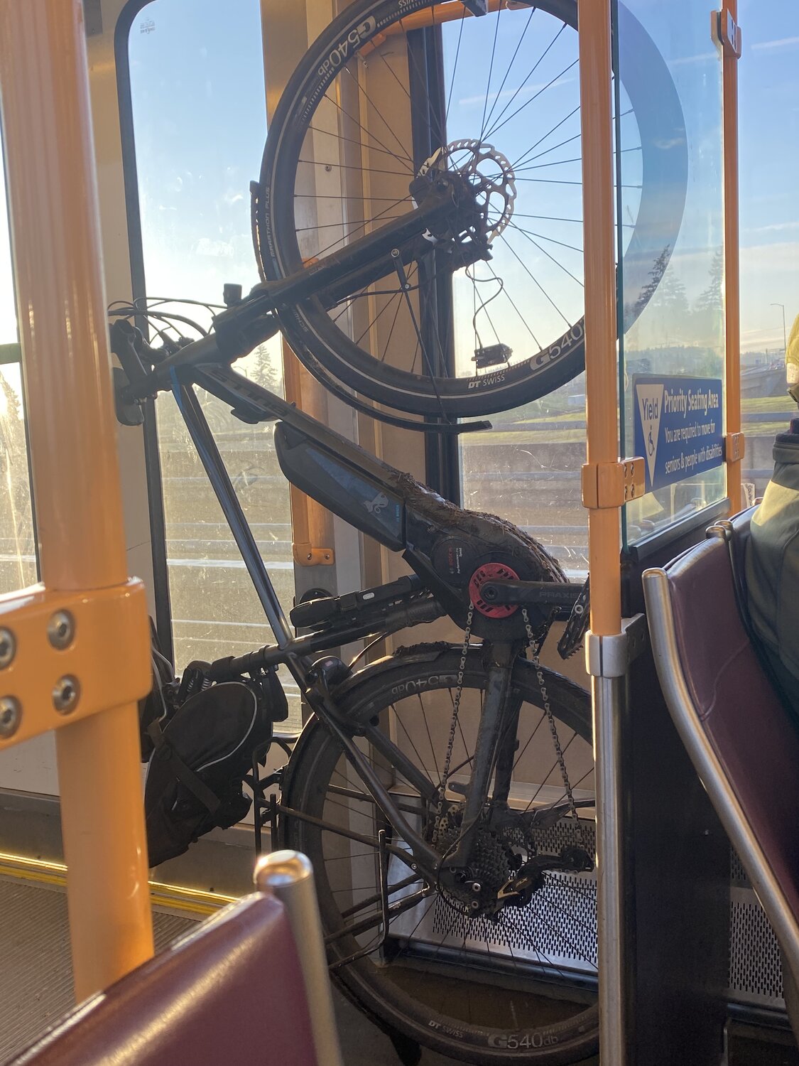

I have debated it but if we have snow on the road nothing gets plowed and I would not trust drivers. ice usually melts after a bit. today we had frosh as we had rain all day yesterday so I took my bike on the light rail then I was able to ride the rest of the way to work and then normal. so it would be ah hassle to get studded tires and I am too chicken to try it

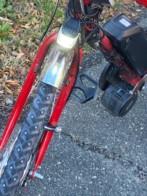

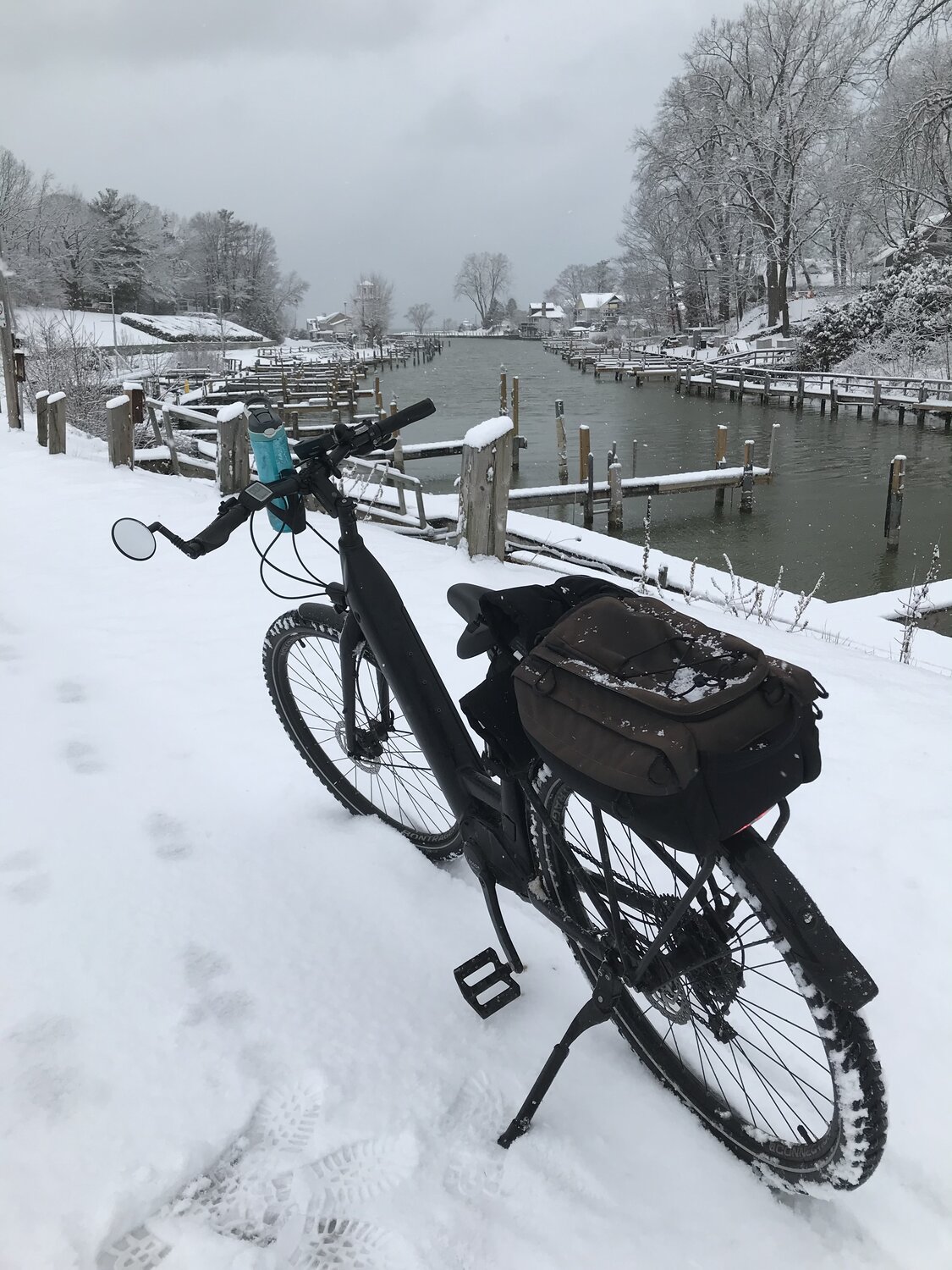

I have been using Schwalbe Marathon 365 GT tires year-round until recently, when I switched them out for Marathon Winter Plus spiked tires. The 365 tires are good in deeper fresh snow but not on ice or rutted conditions. I fell heavily last winter on pavement ice with them, injuring my shoulder. The spiked tires have only been on a week so my experience with them in winter conditions has been limited to a couple of days, but I can already tell they are far more stable than the 365 tires. No experience in deep snow with them, but I am assuming they won’t be great. All tires are around 2” wide.
I was able to bed the spikes in with 40km on bare pavement. I think Prairie Dog meant 40km (25 mi).

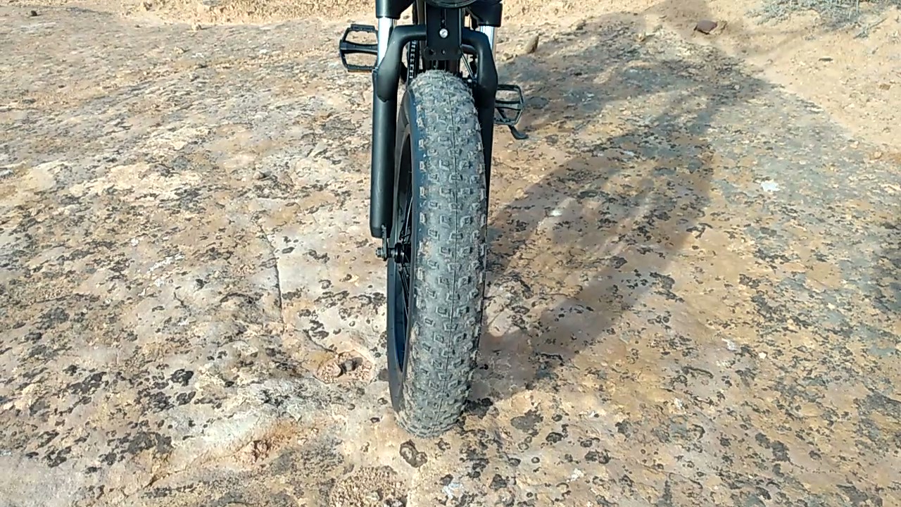

20x4 fatties with off road knobs. I will be riding all winter and pulling my 60 pound dog behind me in a sled. Drop the pressure to around 12 and hold on to a 1200 watt DK200 beast.
