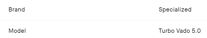

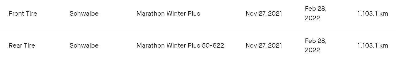

I own and ride a 2017 Vado 5.0. I do not think this e-bike (which is almost indentical to the current Vado 6.0) is different to 2020 Vado 3.0 in terms of wheel size or fender fit. Both my Vado 5.0 and the current Vado 6.0 come with 51-622 Specialized Electrak 2.0 Armadillo tyres.
Two seasons ago, Schwalbe Marathon Winter Plus were available in 47-622 size so I bought them and used for a winter. However, I was curious if the 50-622 MW+ would fit, and I bought them for the 2021/2022 winter. A full success. The tyres fit the Vado fenders perfectly and without any rubbing! I have ridden for 1,103 km on them without any issues!

Yes, I can understand it. I was the most surprised myself after I did the swap. I was afraid the studs would be rubbing the fender. It looks Schwalbe designed the tyre the way 50 mm included the studs.

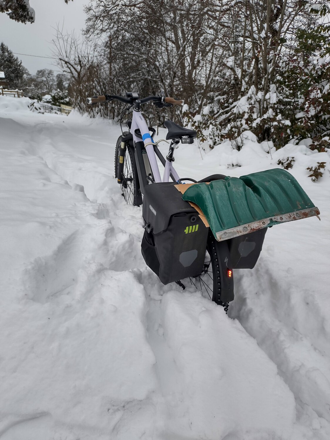

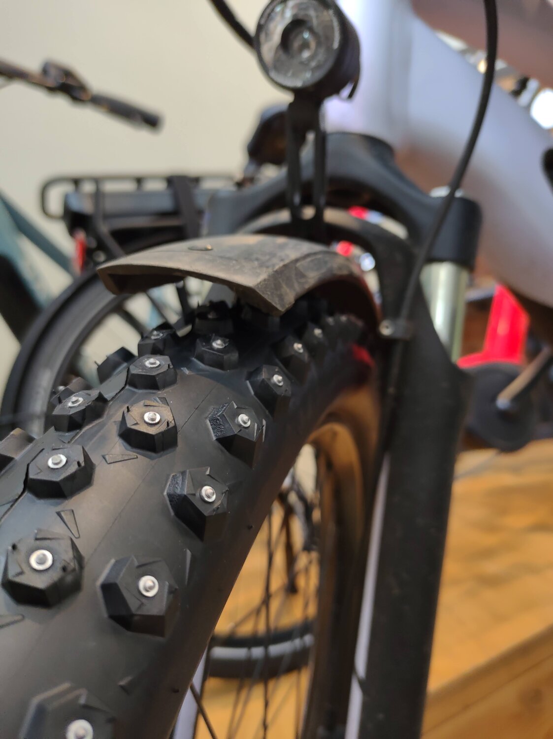

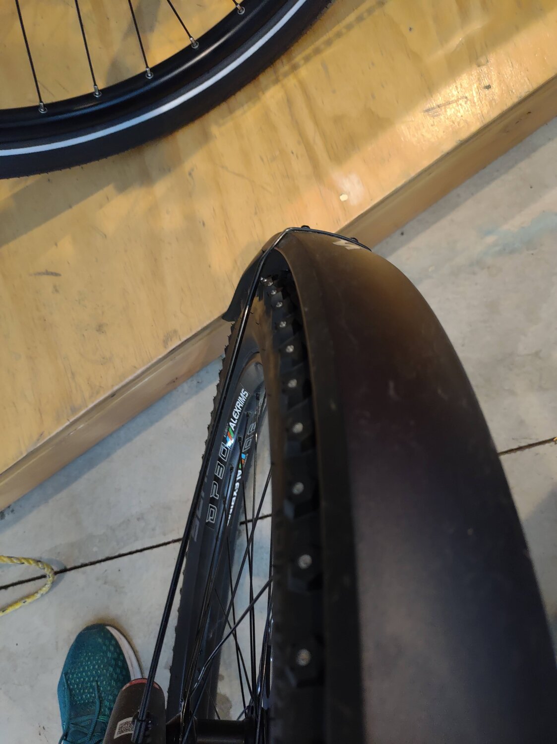

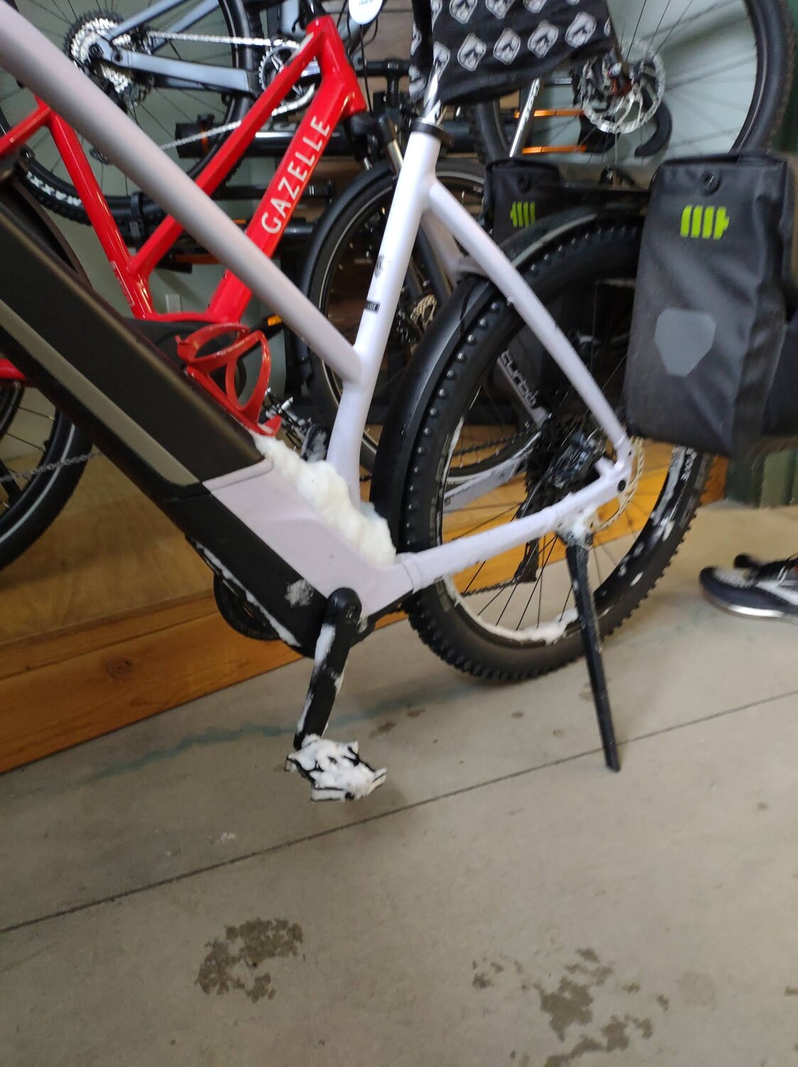

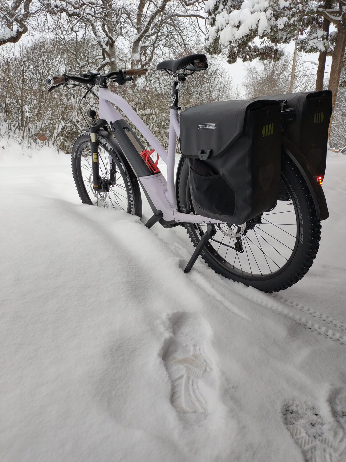

Here's the setup on my Vado, I swapped over to 27.5 wheels in order to run a larger casing tire of the Schwalbe Ice Spiker pro (best on the market IMO). The front fender touched the knobs only a little during harsh bumps, otherwise they're fine.
Feel free to message should you have any additional q's
