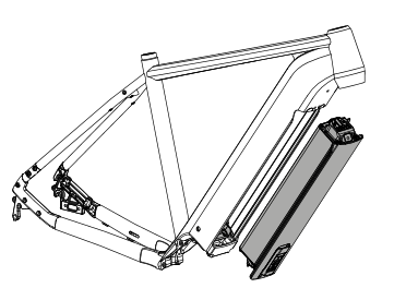

The elegance of the frame of the “Code” might blind the spectator. As the frame is the sole part of a bicycle which is made by the bicycle-manufacturer, it should be perfect – especially, when the build a new bike from scratch.
The battery handling should be as easy as taking out the cabin case from the trunk. 43km is the average daily commute of a Stromer. With the 650Wh battery and the 700W motor, the “Code” needs to be recharged every day. Few might have a private garage with electricity; some will have a bike shelter or a bike room wherein they can bring electricity with a reasonable effort.
Several users have to dismount the battery for charging in their flat. At a nice sunny evening this will be practical. But commuting is not limited to the summer. It might rain, being dark, the bike wet and dirty or even icy. Now, the removal of the battery becomes annoying.
Then, the winter approaches. Temperature can fall below 0ºC. The battery will allow the ride home even when the bike was outside in the cold the whole day. But never ever charging! Nothing will damage the battery quicker than charging at low temperature.
Therefore, the BMS (in a Stormer battery) will not allow charging as long as the battery temperature is below 0ºC. There is no other way than bring the battery into the warm flat. In a garage it will be frost-proof, but still too cold.
I see the following options to overcome this hurdle:
  • Ignore the degradation of the battery, buy earlier a new one
  • Do not ride in winter
  • Install heating devices where your “Code” stays overnight
With this in mind, it becomes clear, why the battery handling should be at least as easy as on a Stromer. The more complicated handling which MTB Cycletech implanted on their “Code” is well known in the eMTB sector. But mountain biking is leisure, only occasional during the nice weather season. In this field, such construction is acceptable.
I mention this not only because of the better solution of the competitors but also to create awareness what must be observe if someone tends to buy a commuter ebike. I’ll come back on the other issues later.
Watch the video of the keyless battery handling: First you see, the eject button is locked (like when the bike is off or in standby). Then the lock is released by the display-button. Pushing eject, the battery door opens and the battery can be taken at its handle.
