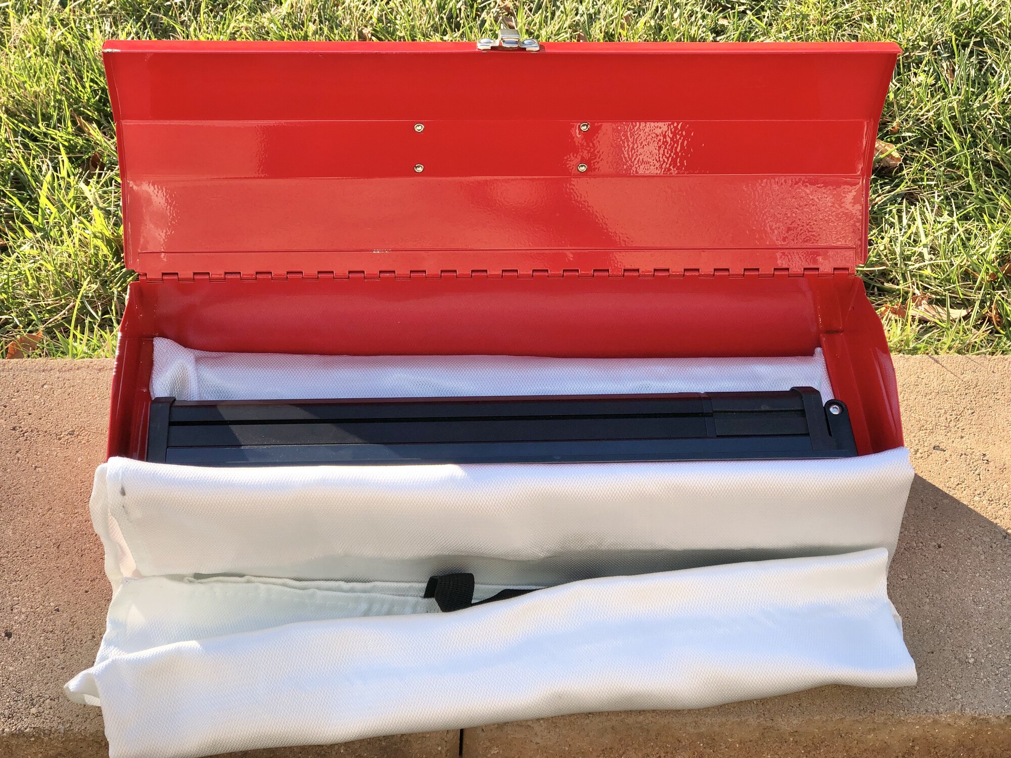

Our Bosch batteries “wintered“ at 50-60% in their nice red toolbox! 🧰
And they were wrapped in a nice substantial fiberglass fire proof mat!
