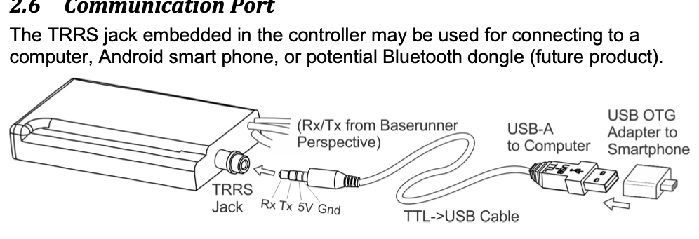

I'm really liking my eBikes.ca Baserunner. Not enough to own an Android device, hoping they'll finally set up iOS access.
You could also just by a used android phone for this sole purpose. Android is nice, because the OS version won’t matter as much as on an iPhone. I would never have an android phone as my primary phone, but I do have an android tablet that still works great. It’s about 10 years old. Also, some newer windows PCs can install and run APK packages. Lots of android options.
