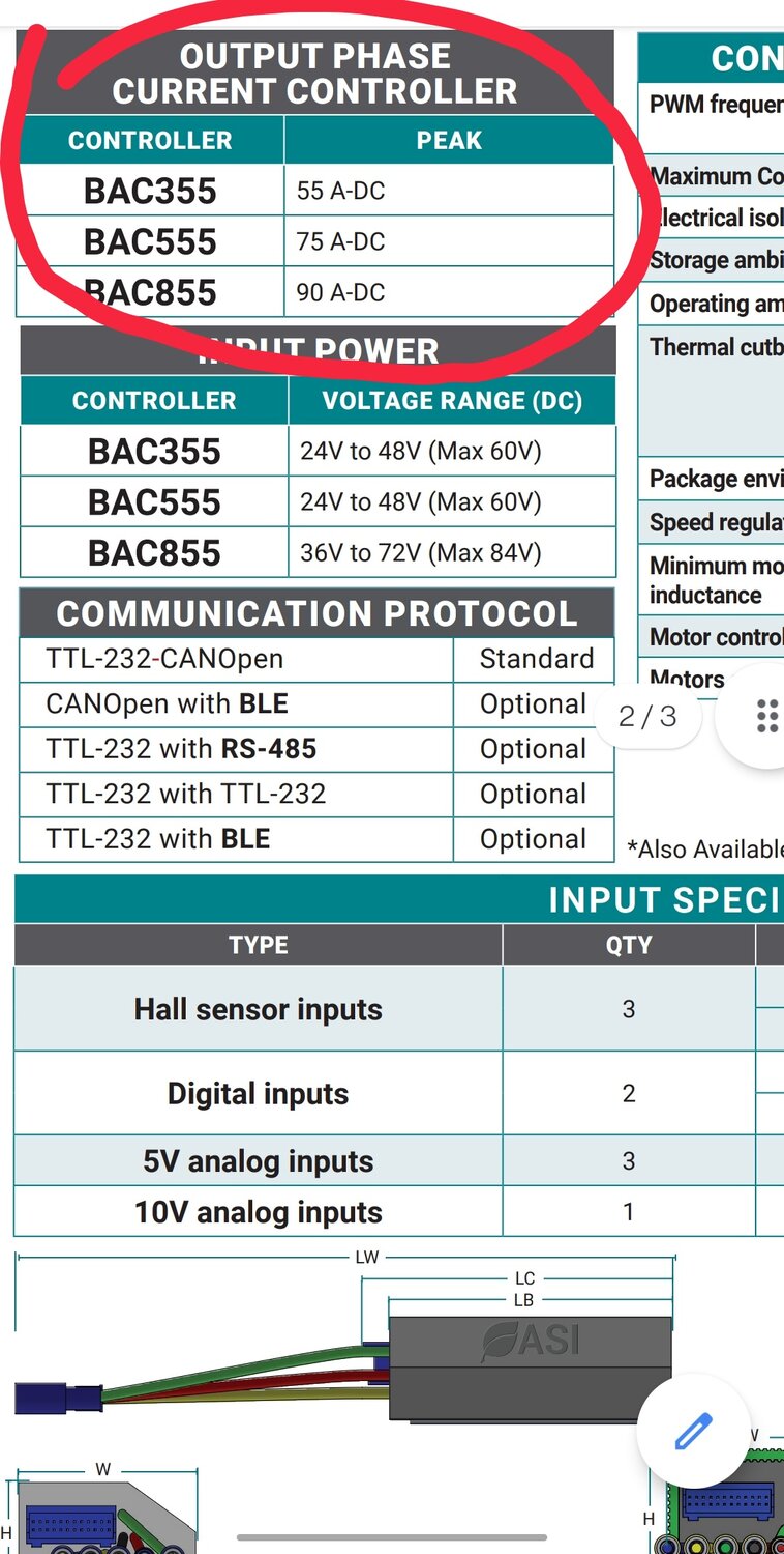

Yes. Thats what I mean. 35A Peak DC current, 70-80A Peak phase.
Spec. sheet has some nice detail, including the firing order for the hall sensors, but I see very little detail regarding the parameters that can be set/adjusted to meet user requirements/druthers. I get where RAD may have a lot of this locked down, but what if the controller is purchased on the aftermarket? Is it even available on the aftermarket, or is this intended for sale to manf's only?
Some other things missing is regarding the type PAS (power vs. speed) and if there's a choice there. Is this a "soft start" mush box that forces users to deal with slow spool up times, or will it allow FULL power on demand (without delay)? Better, is there a choice of spool up times?
Ability for torque sensing input/configuration?
Appears to be a good start, but way more questions than answers at this point.... -Al
