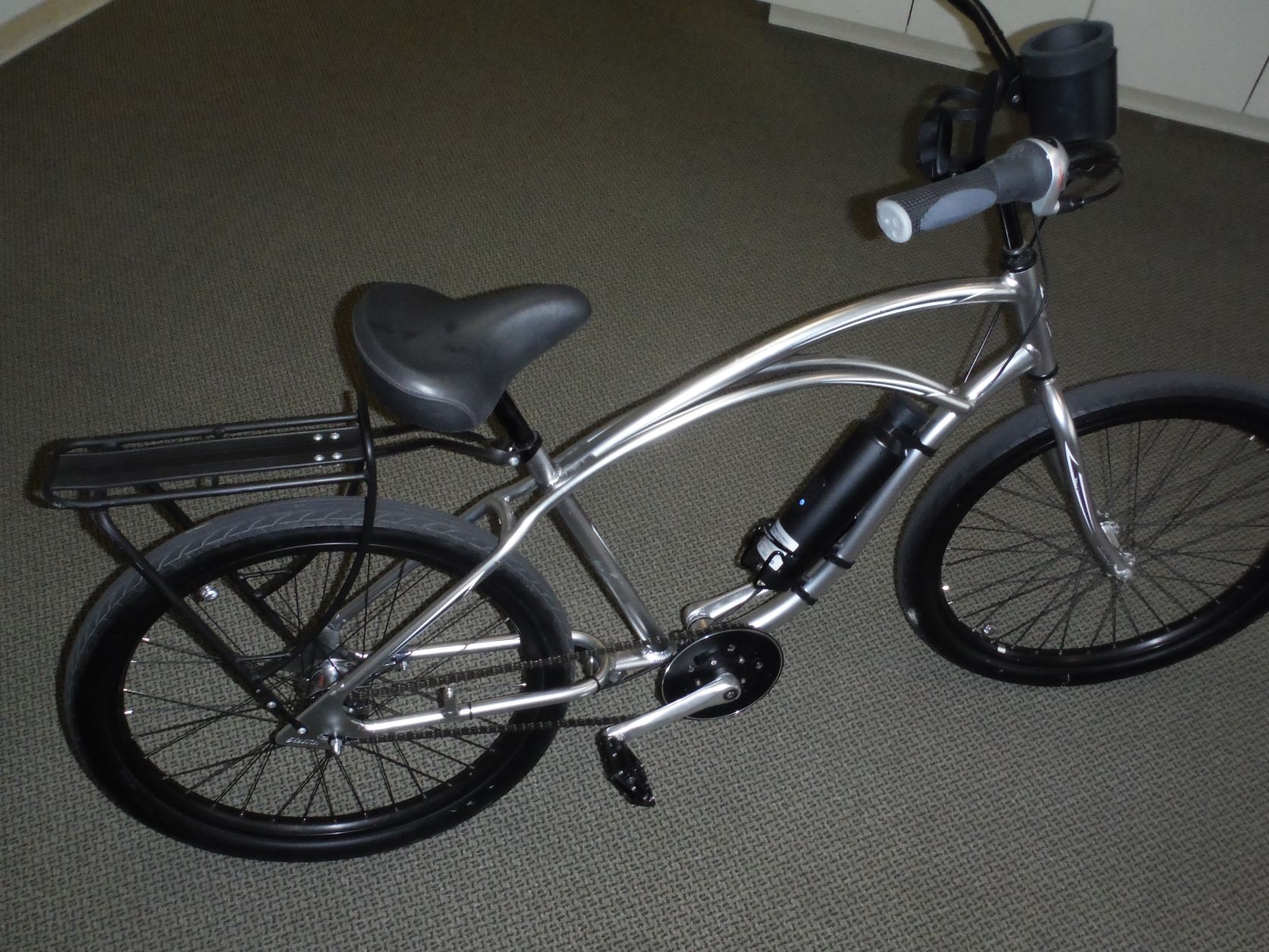

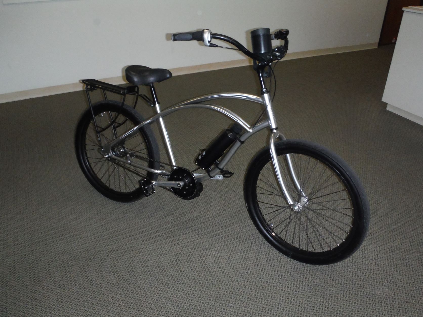

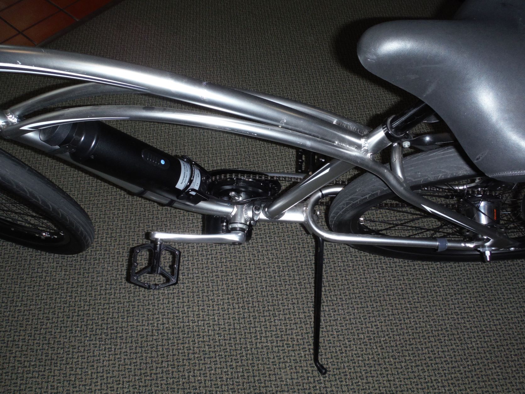

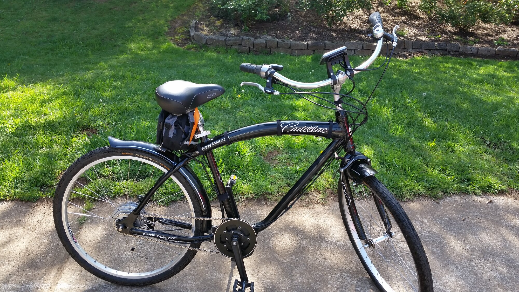

So how is this build holding up? Is this the Tsdz2b with OSF?@EMGX

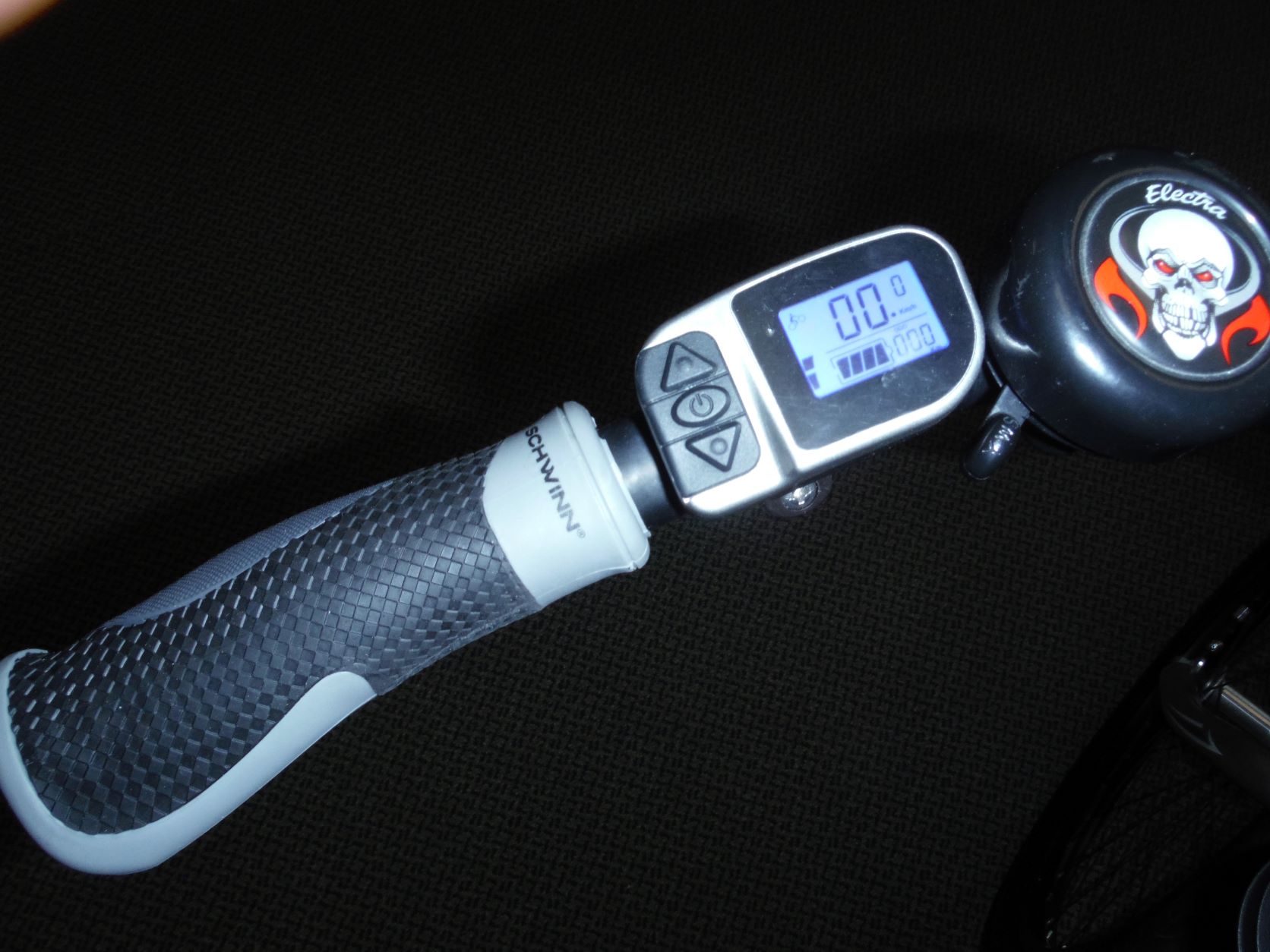

It's called 860C display... I ordered it with the TDSZ2 from EcoCycles!

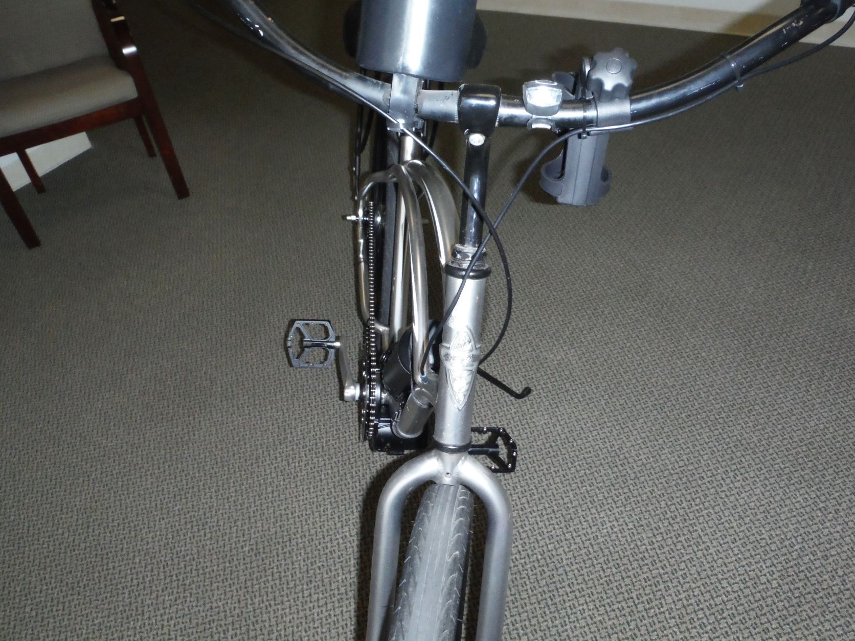

 And yes I’d call the feel mushy compared to my BB7 mechanical disc brakes.

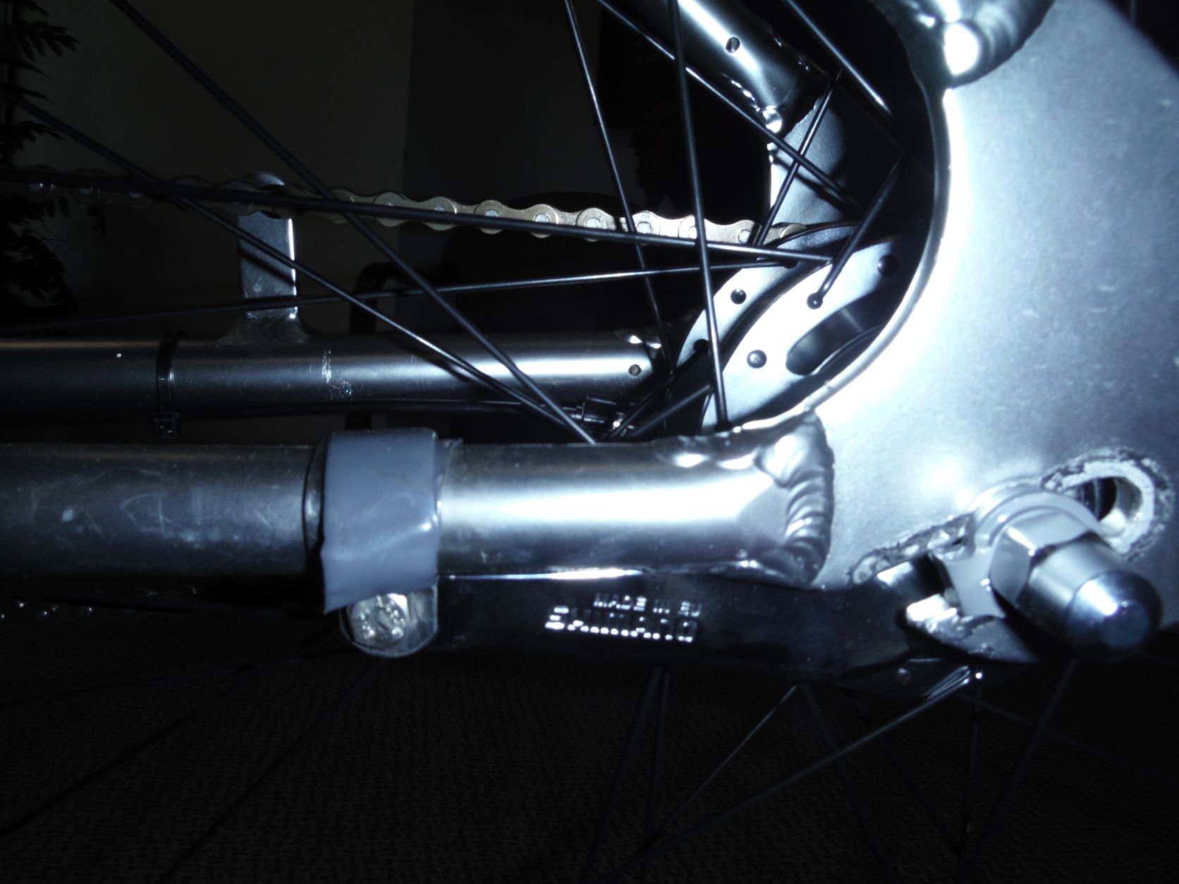

There are widgets to deal with this old-style one-piece cable guide. I used them on my Tracer build, which was a frame from 1999, back before good cable housing / slick cables existed, so the technique of the day was to use ferruled ends and bare cables for much of a cable run. These things:Getting back to the question of mushy brakes, do the cables need to be supported on the frame on both ends. My cable is only supported on the brake lever, and on the brake noodle. there are two lugs on the frame, but they are through lugs only. What if instead of a through lug, I were to make the cable end there with that metal housing end cap (ferrule), shown...??? and same thing down closer to the v brake noodle...???
